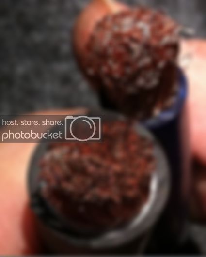

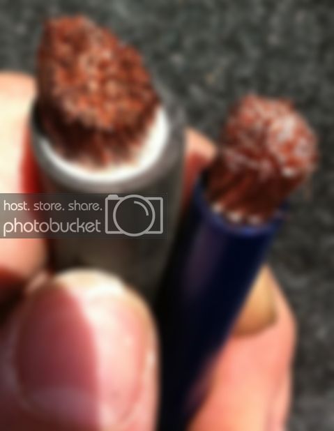

Does this look like legit 1/0?
SourDeez
Just bought this stuff from Trystar.com (local company)
Its black welding ultraflex 1/0. was about 3.10$ per foot
This is a comparison next to Knu 4 gauge CCA. Doesn't look as big as I thought it should..
ya knu is usually thicker then anything at the same size....did an install for a friend and he didnt order enough 4 gauge so we ran to a local shop and got him some stinger 4ga and it wasnt nearly as thick as the knu.....
i use 2/0 flexaprene and its the same size as my 1/0 stinger pro. i use 2/0 lugs for my 1/0 stinger wire and 2/0 lugs also for my 2/0 weld wire i think weld cable is made thinner
