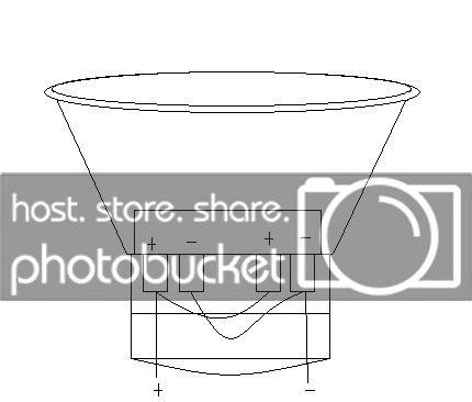

does this look like its wired right
bopo668
JerryRig
i was wonding if this looked like it was 2ohms what do you think
i dont know what 2 ohms looks like //content.invisioncic.com/y282845/emoticons/confused.gif.e820e0216602db4765798ac39d28caa9.gif
i think we need some more info man //content.invisioncic.com/y282845/emoticons/laugh.gif.48439b2acf2cfca21620f01e7f77d1e4.gif
it is wired in parallel, if that helps at all.
depends on the impedence of the voice coils
if its a dual 4 wire all + together and all- together to get a final 2 ohm load
if its dual 2 it is immpossible to acheive a final 2 ohm load.
from your pic if they are dvc 4 you are wired correctly
