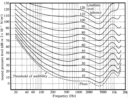

good linearity is difficult - in part because of the sensitivity of the human ear with low and high volume levels.
