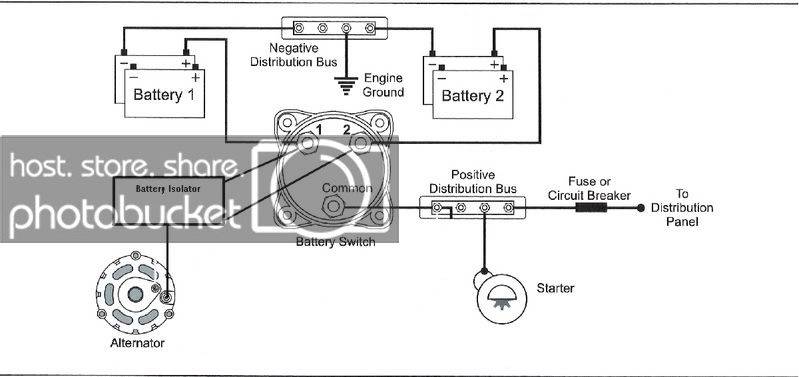

I have my HC2000 and I'm about to hook it up as a second battery but I have a stock alt and I am wondering if this will hurt either my alt or my battery. I don't have any voltage drop right now because I'm only running 1kw but I am putting it in there now so I don't have to later when I get my new amp.
Here is what he is talking about. NVX BIR200 200 Amp Relay Isolator (BIR200) - Sonic Electronix
Personally I would use one if I were to use 2 batteries. I might do a second, very small one sometime in the future but really don't have the room. The real issue for me is they don't make H/O alts for Honda Fits, you have to get them rewound or whatever. But luckily it puts out pretty good amperage and so far no issues other than I listen to my music for 20 minutes at lunch hour on just the battery which gradually kills the battery after a year or two, So i'm gonna use a trickle charger every night to keep the battery fully charged since I don't drive enough to keep it completely full.
normal wet cell starting car batterys will generaly rest at a lower voltage than a good agm battery will want to rest at. if you directly hook them together the battery with higher voltage will always keep trying to charge the battery with a lower voltage - and in turn the better of the 2 batterys will always remain at a semi state of discharge. it is not the ideal way to hook it up - but people do it all the time - it will work - its not the verry best way to do it. ive done it in the past
the best way to add that battery to your car right now
is to install something called a relay
it can be wired to ignition hot. so when the key is off - the relay will "un hook" the agm extra battery from the front battery
but when the ignition key is on and the car is running - and alternator producing 14v then both batterys are hooked up together to power the car and system.
the other acceptable way is to remove the regular wet cell car battery from underhood - and replace with the same type of agm battery.
That would be a battery isolator, not a relay. //content.invisioncic.com/y282845/emoticons/wink.gif.608e3ea05f1a9f98611af0861652f8fb.gif
Looks like a relay switch to me. I think they are called both because a relay also isolates?
