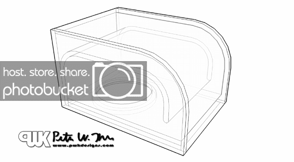

I don't want to shuck out $170 for a box when i could build it myself easily...
http://www.supercrewsound.com/commerce/product.jsp?prodId=147
Anyone done this?
I did a search In this subforum and the build log subforum but found nothing.

Center console box for a DD 9512 in a Dodge Ram
no way that would work, i have about 1.34 cubes sealed right now where my center console was. And to the op, fiberglass is your best bet to get the most space for a lower seat replacement. i got about .85 after displacemnet and was running an IDQ 12.

Well, I'd like to know your theory of why it wouldn't work.. It seems to work well for the guy that owns it. He's only got 500watts to power it till tax return but it still seems to work fairly well. Although console boxes aren't always that good anyways. The owner of it likes it.
not really saying it wont work but i doubt thats more than 1.5-1.7 cubes ported. wouldnt a 9512 need more airspace than that?
