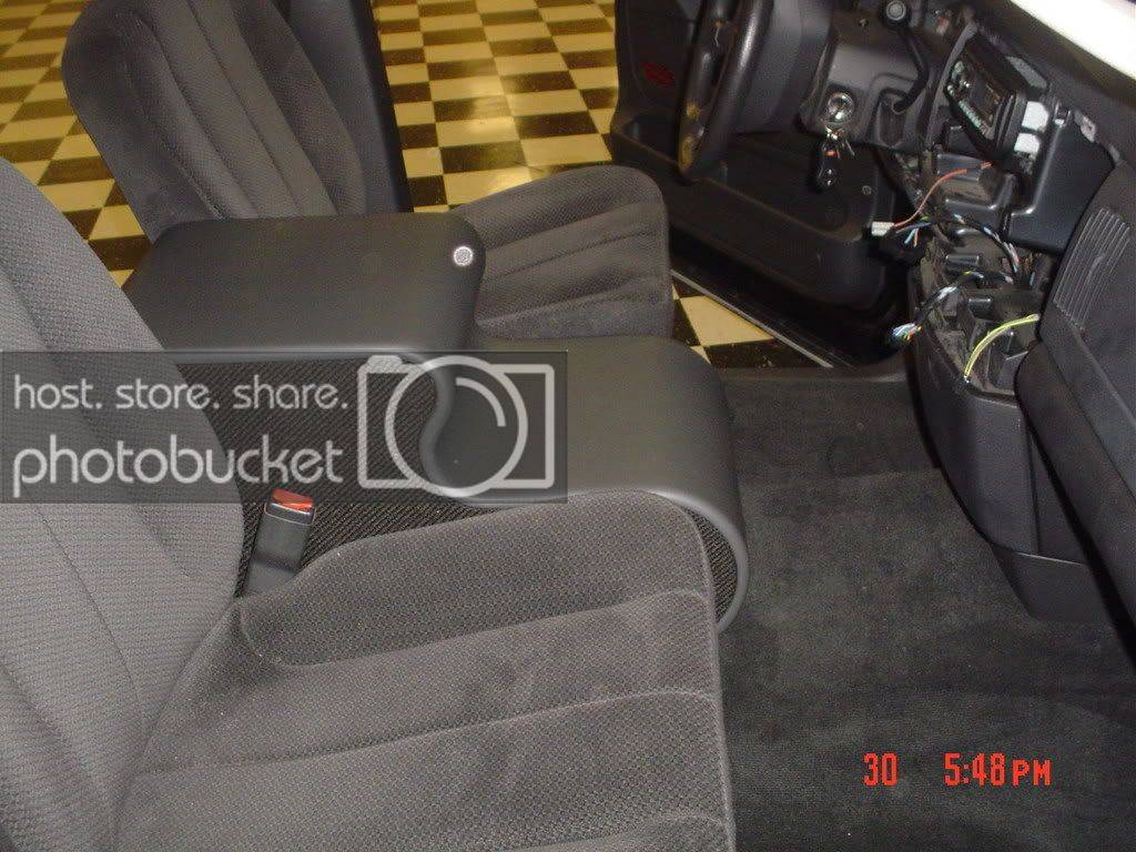

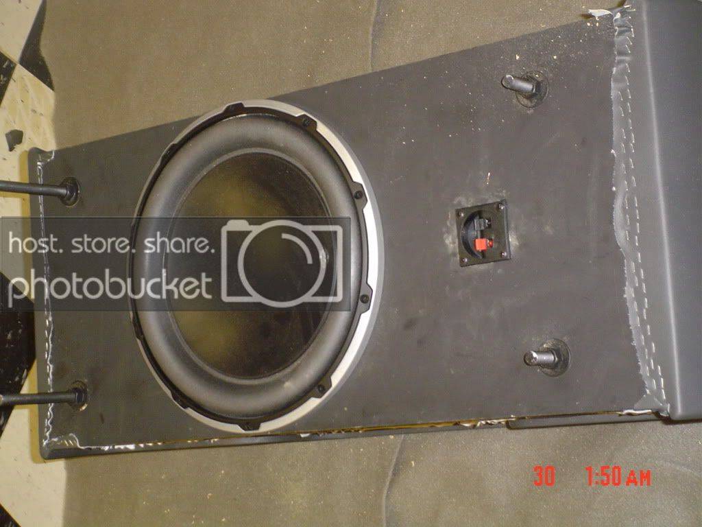

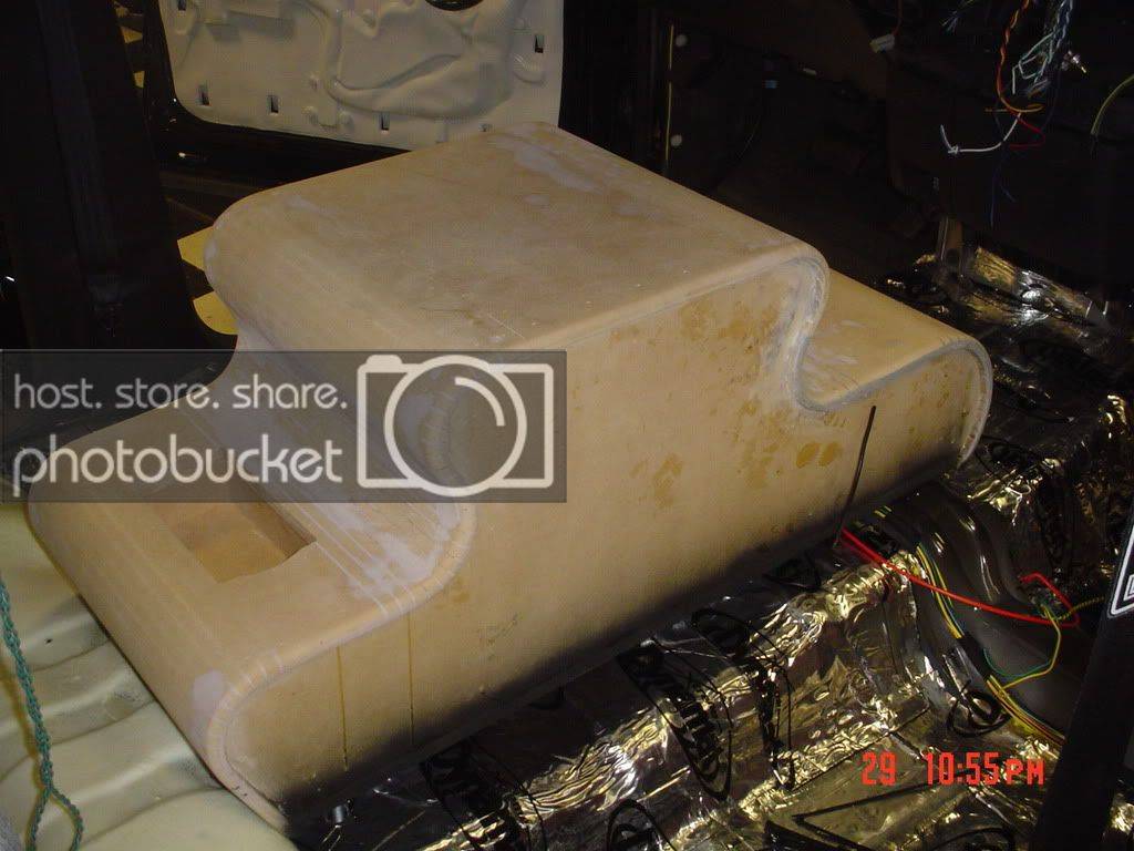

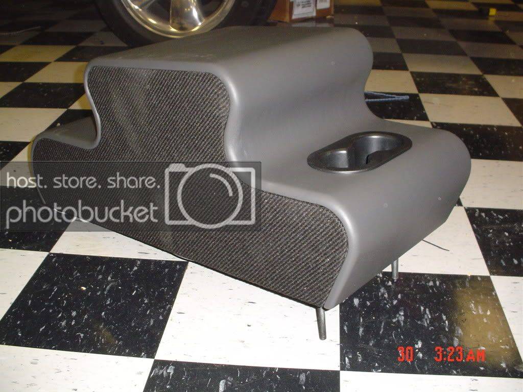

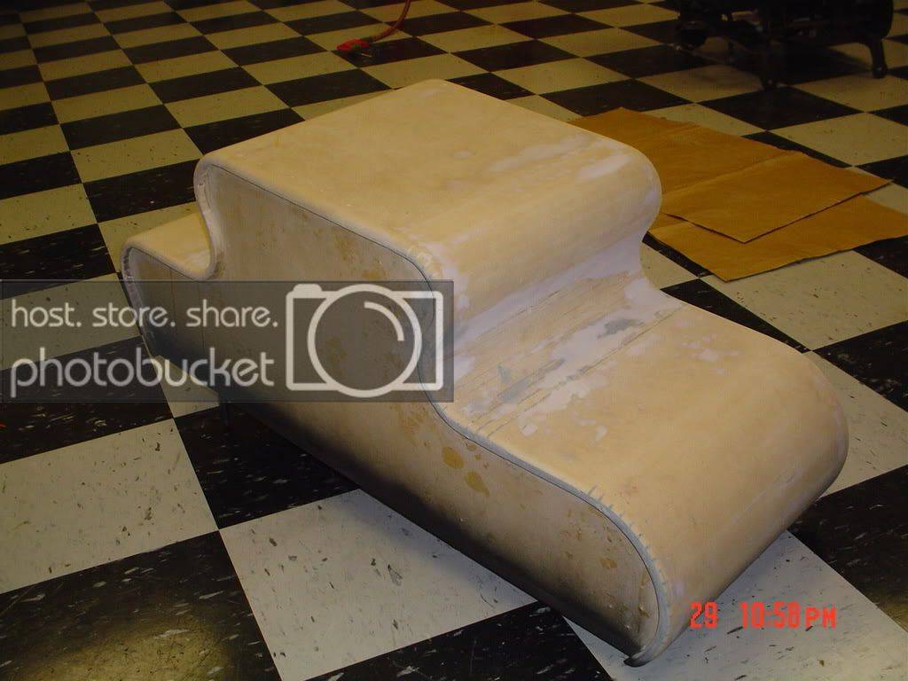

I'm building a center console for my 04 Ram Quad Cab right now. It's 33"x13.75"x13.75" for 2 RE Audio SX10" subs. It's a slot port tuned for 35hz. I'll post up pics as I start the build. It's big but once it's upholstered it will look good. I wanted to keep the under seat storage in the rear for amps and other stuff as I will be losing the console for storage.
