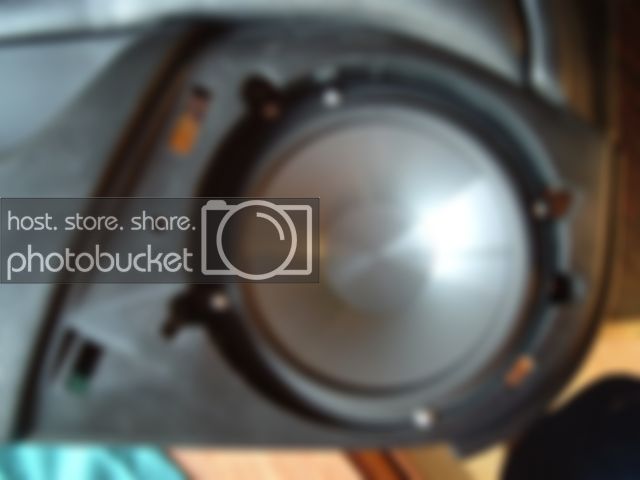

I drive a 97 honda prelude and from what i read on the prelude forums is that our front door panels allow us to fit 6.5" speakers into them with little modification (cutting away the basket). But im wonder do you think i can squeeze in the Pioneer Premier TS-D720C into them?
These are 6.5" Components fitted in.

Most 6.75" components actually measure about 6.5". My Premier 720PRS mids are actually like 6 3/8", which isn't even a 6.5" although they claim to be oversized mids. This has been pretty common with Pioneer. So I'd say you're safe if you're looking at the Pioneer components you mentioned.
