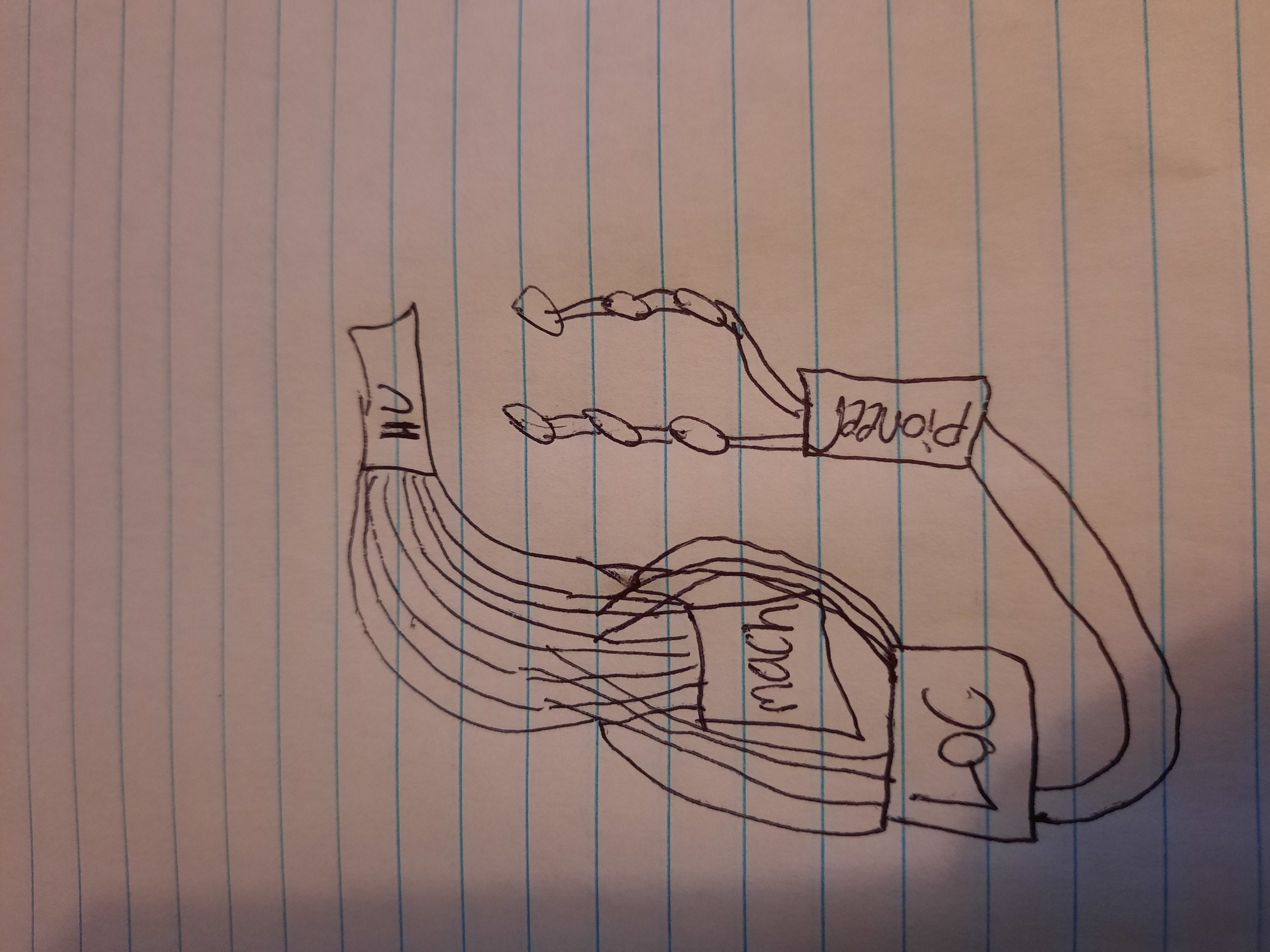

Yea I tried the speaker unmounted. The mach factory amplifier is actually an rcu so can't really bypass it. the facrory headunit in the dash is just a remote control. the tuner and inner working of the radio is all in the mach rcu amp. Have the speaker wires running to the loc I'll send a drawing sorry it's a poor drawing I'm not an artist by any means.

Sorry, I thought you still had the aftermarket amplifier in.
Basically, to see if the problem is the head unit itself or the connections going from the head unit to the amplifier, you'd have to not get your signal from them and see if the problem persists.
Also, check the speaker wire going to that specific location. You could have a bare spot that's touching metal.

So the aftermarket amp is still in but only running the right side of the car. I tried a different speaker wire same problem was still occurring. Could the output wire from the rcu cause this problem? I'm unsure because like I said it's crystal clear at a low volume and as soon as it hits around 3 its complete distortion. Could outputs just be damaged? I don't know how this could have happened but I'm at a loss at this point.

I switched the rca Jack's around and the left side worked flawless...is it the outputs on The factory outputs then? I tried new wire different speakers separate amps also tried different rca Jack's on the loc and each attempt the left outputs off the rcu messed up even tried hooking.up a speaker before the loc right to the factory rcu and still no luck. So if any ideas on how the outputs on The rcu may have been damaged?
