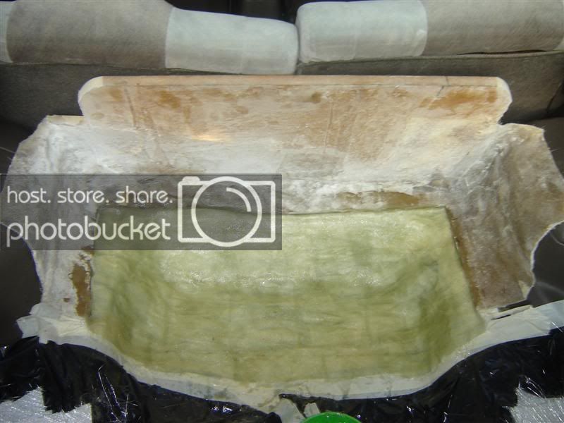

Well, fiberglassing in my trunk and i didnt put enough hardener. So its been like 3 hours now and its still soft, what to do. I would add a lamp but the bulb is broken //content.invisioncic.com/y282845/emoticons/crap.gif.7f4dd41e3e9b23fbd170a1ee6f65cecc.gif so im thinking mayeb going over it with the blowdryer for a good 15 minutes might speed up the process. Any ideas?

Its a mold for wheel well , i cant take it out becuase its wet still.

the glass in the wheel well is what im workign on, i had a change of plans so thats why im having to do it this way. I hope 3 hours in the sun will harden this beast, the blowdryer pooped out //content.invisioncic.com/y282845/emoticons/mad.gif.c18f003ab0ef8a0d9c27ca78d77a6392.gif

this the morning i checked on the fg, it was kinda hardened in some areas but i still couldnt take it out, it was mostly still wet. But since is 9am, the sky was clear and it the sun was beaming. So i opened up the trunk and let the fg soak up the sun, about 2 hours later it was solid enough to be taken out. Its solid but not yet rock hard, but i have it directly in the sun right now. All is well, Thanks.
