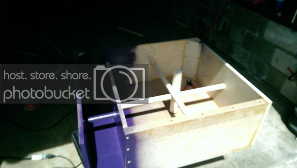

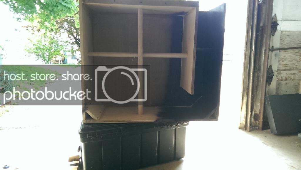

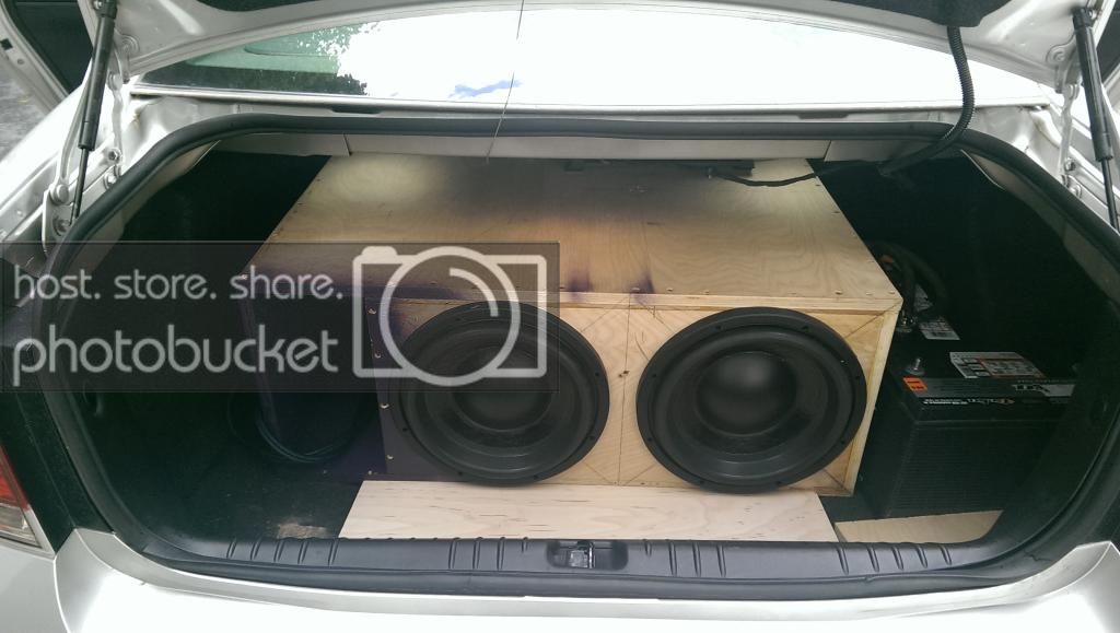

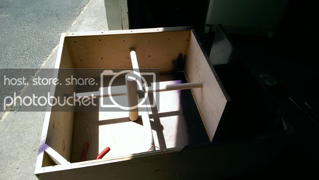

ok so a little background. The car is a 2007 chevy impala. I had an AQ hdc4 18 in the trunk in a box i thought to be not quite optimal, (it was just a temporary setup until i picked up something else) the box was ported to the rear with the 18 facing up. It got pretty nasty but from what i had heard sub and port back in this vehicle is the loudest configuration. Enter 2 tantric HDD 12s that i picked up and the new box i made for them. I figured given that the 12s wouldnt have much less cone area, more motor force, and heat disapation, as well as being able to do port and sub back i would be at least as loud as the 18. Well i am not satisfied with the reults in both loudness as well as sound quality/ response. Its loud but not nearly as loud as the AQ was and although it sounds slightly better its still sounds pretty sloppy and to me it almost sounds like the box is too big and the subs want to unload. I shot for 5 cubes net, 15 sq inches of port tuned to about 34. According to my math I ended up just a bit over 5 cubes and tuning should be correct. Any ideas or input on this would be great, i will upload some pictures of the box as well as dimensions when i can
[quote name='phemps']@NASTY08IMPALA; you have this car, any insight? also do you know how close the box to the trunk lid works the best in here?[/QUOTE]
That port looks a lil big to be 15" per cube ..and yea u have it to far from the trunk...4-6" works best ..other than the port being odd looking the box looks fine..play with the box placement and see if it helps
How much power?? I have played with a few HDDs and they like pretty small boxes
Crescendo bc3500 nominal impedence of a half ohm. I plan on strapping another 3500 eventually so ill probably have to go smaller anyway, but i was recomended around this size
I figured it would be better farther back, it was just how i had to have it with my wiring as is. The port is 6x12.5 so im at about 15 sq in per cube
That box size is fine ive seen many perform well in that size
