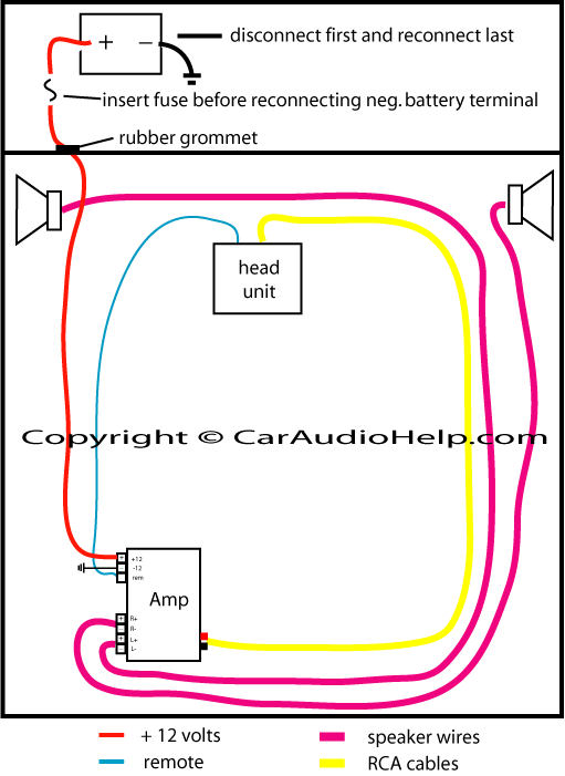

diagram please
this should get u started with the amp..
thanks .. but what powers the head unit... is it the rca cable or what ?????
when u wire up your headunit... you will go to walmart or anywhere that sells car audio stuff, and ask them for the wire harness adapter. it will tell you what each wire on the adapter is supposed to hook up to on the headunit, then on the headunit there will be a sticker saying what each wire coming out of it goes to(often times they are color matched), then u simply just match the wires together, and plug the harness into the factory wiring plug
