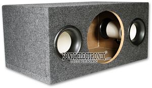

Here is my initial layout I'd like to use. 2 small ports on the left and right sides of the sub.

this is the box i'm trying to reproduce:

2cu' @ 34hz w/ 2 4" ports.....
use the formula in my sig to find the length of the ports. for vb, use 1728.
(you divide the box volume by the number of ports your going to use. you also use the cu" not' in the formula. add the volume of the ports and sub displacement to the original 2cu' and build you box to this gross volume. any Q's...ask me.)
((also keep in mind that the ports need to stay at least 4" away from the back of the box))
