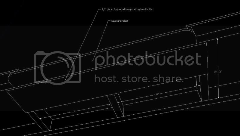

Here's a quick sketchUp of my desk:

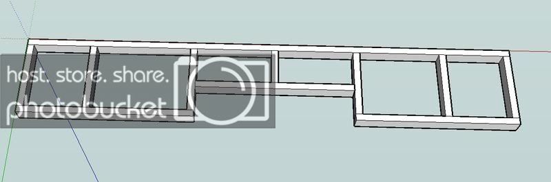

The skeleton:
It's covered by a piece of 1/2" Plywood, the bottom, as shown, has a 1/2" piece of plywood for the keyboard / mouse support, then another piece of 1/2" plywood to support that piece since it's very long and wouldn't have much support otherwise.

This is what I want to do. I want to knock out the middle support and put a new piece of 1/2" plywood to cover that whole section so that I can lower my monitor to eye-level.
I can deal with the aesthetics. I was just wondering if anyone would think it would weaken the integrity of my desk that much. (I'm talking about removing the one piece of wood in between the Keyboard/Mouse support.)
