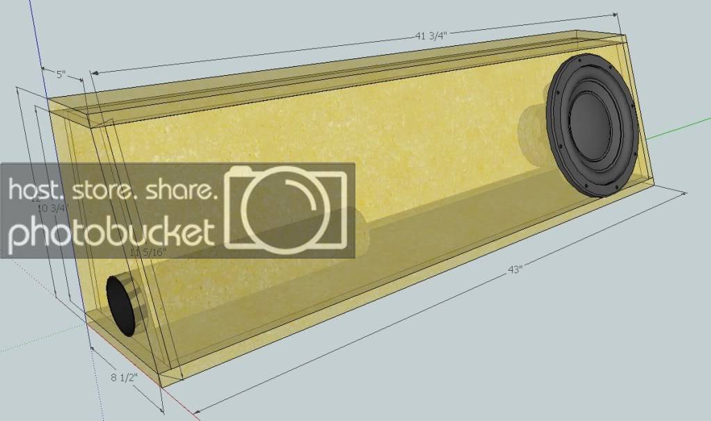

I did a little work and came up with these dimensions on Torres Calc and this on Sketchup. Does the positioning of the port look OK?
Im glad you mentioned that, i will change it up and use 3/4", i can widen the box a bit to get the air space back. is the positioning of the port good? also the tuning, for a mix of sq and spl? is the 3" port good or should I use a 4" port?
33hz is a good point for the Dcon in a daily install. As for the port, if you can go larger, great.
