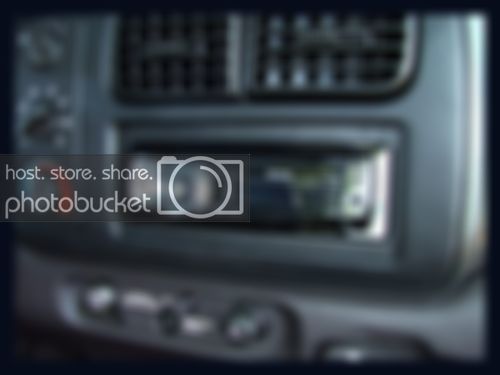

Next, I upgraded my aftermarket dual cd player which a Pioneer head unit:

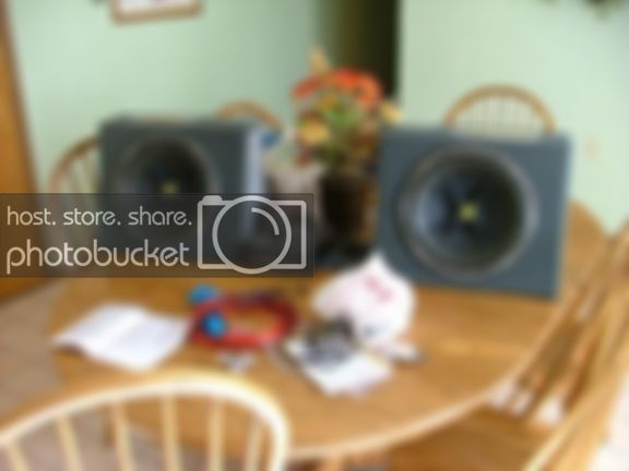

Subs: Basic Kicker comps. 12'' Than for the boxes:

CVR's won't be much of an upgrade IMO, they will probably be a bit louder, but not worth the money or time. If you're deadset on Kicker, go all the way and get the CVX.

EDIT: Just looked at the pic, that doesn't seem any bigger than 8 gauge wire, if you plan on upgrading, that will have to go.
The problem with the CVX's and I would have to make a ring to extend the lip of my box out about 1/2'' and inch to deal with the larger depth of the subs. Which I guess wouldn't a problem to do. What amp would be ideal for two of the 1500 watt CVXs?
