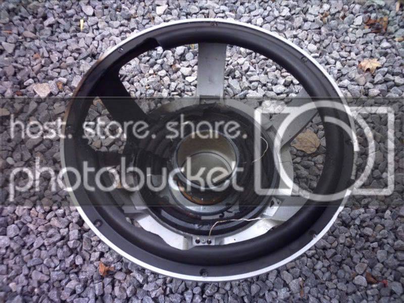

So I commenced to take the sub apart right there on the side of the road, and low and behold, the coil on the sub is just fine - it was the tinsel leads that caught on fire and lead to the demise of the driver. Luckily, I recently bought some spare recones for this, so in the following day's i'll be taking some pictures of the rebuild / recone....(if there is interest that is). But please let me know otherwise I wont bother to post the info. I'll be turning the 4hp into a TC 5200 before your eyes if you all are interested. Anyways, on to the crispy pics! //content.invisioncic.com/y282845/emoticons/biggrin.gif.d71a5d36fcbab170f2364c9f2e3946cb.gif
The speaker was charred, but my Arby's lunch was pretty good.

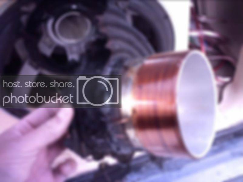

as you can see the coil is fine, its the spider that went up in flames.
And that is left. Right now I have the bottom half of the sub soaking in some WD40 so i can get it apart (it unscrews apart)....so if you all are interested in my rebuild of it, please let me know and i'll continue this thread. Or you could just make comments on TC's build quality, I wont care either way.
