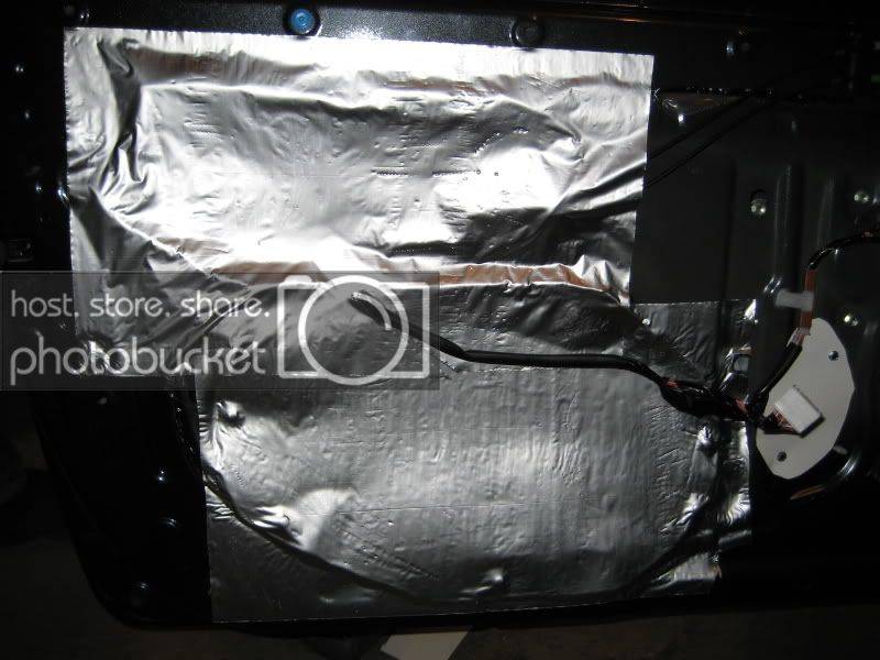

ok first a pic of the door without the door skin or plastic liner(you can kinda see the deadener on the outer panel in this pic).

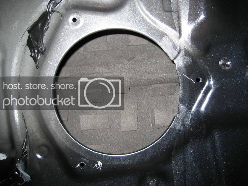

used the 1 sq ft of V4 for behind the speakers in sort of a checker board design instead of the egg carton foam(thanks chris)
with the giant holes covered up(one with just the sheetmetal and the other covered with the deadener.
with some more deadener applied(almost done)
a final shot before putting the door skin back on
i used some deadener on the outer skin not a lot but tried to cover as much as possible(not a whole lot should be needed on the outer panel. then i covered all the gaping holes in the door panel with some sheetmetal and self tapping screws. then applied a good layer of deadener to the inner panels covering up the panel and the sheetmetal that i added. then went back and covered some areas with a second layer where i thought could use it. i still have a small amount left so i am going to go back to the passenger side and add a little more.
