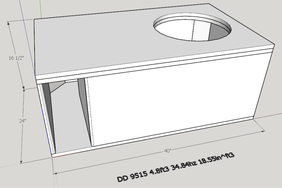

I don't have the space anymore for 18's.....15's only, unless I decide to get rid of my back seats. Which I don't think that's going to happen anytime soon lol. So I found another 9515 dvc 2 ohm I motor. I talked the guy down to $250, It's got some paint that spilled on the surround and the dust cap has a dent in it. He was asking $350.....So i should be picking that up here later on today!
Oh and hispls I slapped a box together yesterday just for shiits and giggles. I managed to get 5.9 cu ft net with 100 sq in of port area. And I got it all in and went to take a test drive and wouldn't you know....my head unit kept shutting off because I'm running the stock alternator with a lead acid under the hook and an agm in the back at the moment......SHIITY! So I'm going to fabricate a dual alternator bracket for my 4.3l. I don't see how your able to run a taramps on 12v electrical....I got home after attempting to listen to it, and my battery was dead as could be. So they've been on the charger all night. I'm hoping they're completely charged by now.
But anyways how many cubic feet would you guys recommend and port area for two 9500's? Obviously I want the most spl because I'm trying to pop my bass cherry lmao. But it will need to be for music also. I would like to be able to listen to them for long periods at a time so when I'm demoing I won't have to keep smelling for burnt coils.
DO NOT attempt to play below 40hz with that box. Assuming you peak 45-55hz range somewhere that box should do some big burp numbers assuming it's solid.
3" 4 layer coil is good for 1200W continuous. Beyond that it will heat up and fail.... The more power you use beyond that it will fail exponentially faster.
DD95 is about as good as you can get for getting loud without getting into neodymium. Stick to the DD box specs and they've always impressed me, just don't try to play whale song notes on them in the spec boxes with the kind of power you're using. You should not need a lot of power to get pretty loud with 9515 in that box.
Go easy and keep an eye on excursion until you really get a feel for the limits of things.
