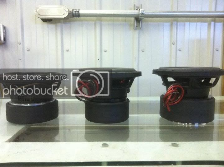

The pics are of a stamped basket sitting on a motor that was laying around. Not saying there is no such thing as a 2508 but the likely hood that it would be a functional and cost effective project is a farce. Not to mention that even though others may feel that there would be much to gain from an idea like this, the real outcome is less then most would desire and the 1508 would out perform it in almost every case.

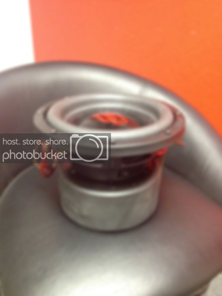

I said already the bottom 2 pics are from 2010 when they has started the idea and the top pic is the real deal... Read the thread guys... And Holic my 8 with the 3 inch coil has about a 7" spider...
That's only 2" of spider on either side of the coil. Not diffing your driver, Im sure it performs well, Im simply saying that the basket for an 8" sub will be so small as to limit the spider landing size, which means you either have to keep the coil diameter relatively small, or lose some excursion potential.
Someone on caco said that was a joke someone pulled...a reconed JL w7 8 with a DD dustcap. Dont know how true that is..?
That does not look like a W7 frame to me. The W7 uses JL's proprietary surround mounting method that takes the surround out to the edge of the frame's diameter. I know this pic has already been debunked, just sayin...
Just some rough thoughts based on the pictures posted here. At some point we have to realize bigger isn't always better. Once a coil is fully saturated, making the motor bigger (the slugs, or the number of slugs) provides little or no help in generating BL force. Again from those pics, I have to assume the coil is a 2" (maybe 2.5"), and my over-saturation-meter starts kicking in. Or, they are going with a larger 3" coil, and then we have to worry how well such an undersized spider will hold up to use/abuse. I would also be concerned about how well the spider would hold up if its suggested the third slug in the motor is meant simply to allow for more rearward vc clearance (a common reason extra slugs are added, contrary to popular belief).
Im not saying I have this sub all figured out just from a couple pics. But again the pics do raise a few red flags in my mind.
