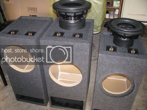

I've been doing some major testings with many various boxes. Anybody in socal that wants to try out some boxes or these DC Sounds subs...let me know. I'll have probably 5-8 different types of boxes you can mess with, just bring your own subs and BEER !!! I have a lot more boxes on the way. Gotta have a So Cal meet by the middle to the end of this month.
Level 4XL 12" and a Level 3 10".

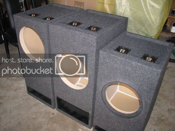

- Left: Single 12" Ported enclosure: 2.0 cf with an Effective 0 - 1,200 watts 35 hz ouput.
- Middle: Single 12" Ported enclosure: 2.0 cf with an Effective 0 - 2,000 watts 35 hz output, flared/bent/kerf port.
- Right: Single 10" Ported enclosure: 1.5 cf with an Effective 0 - 1,000 watts 35 hz ouput
I have it at 1.5 cf tuned to an effective 35 hz. I need to build another box with a kerf port. The lvl 3 10 loves a 1.75 cf box though.
