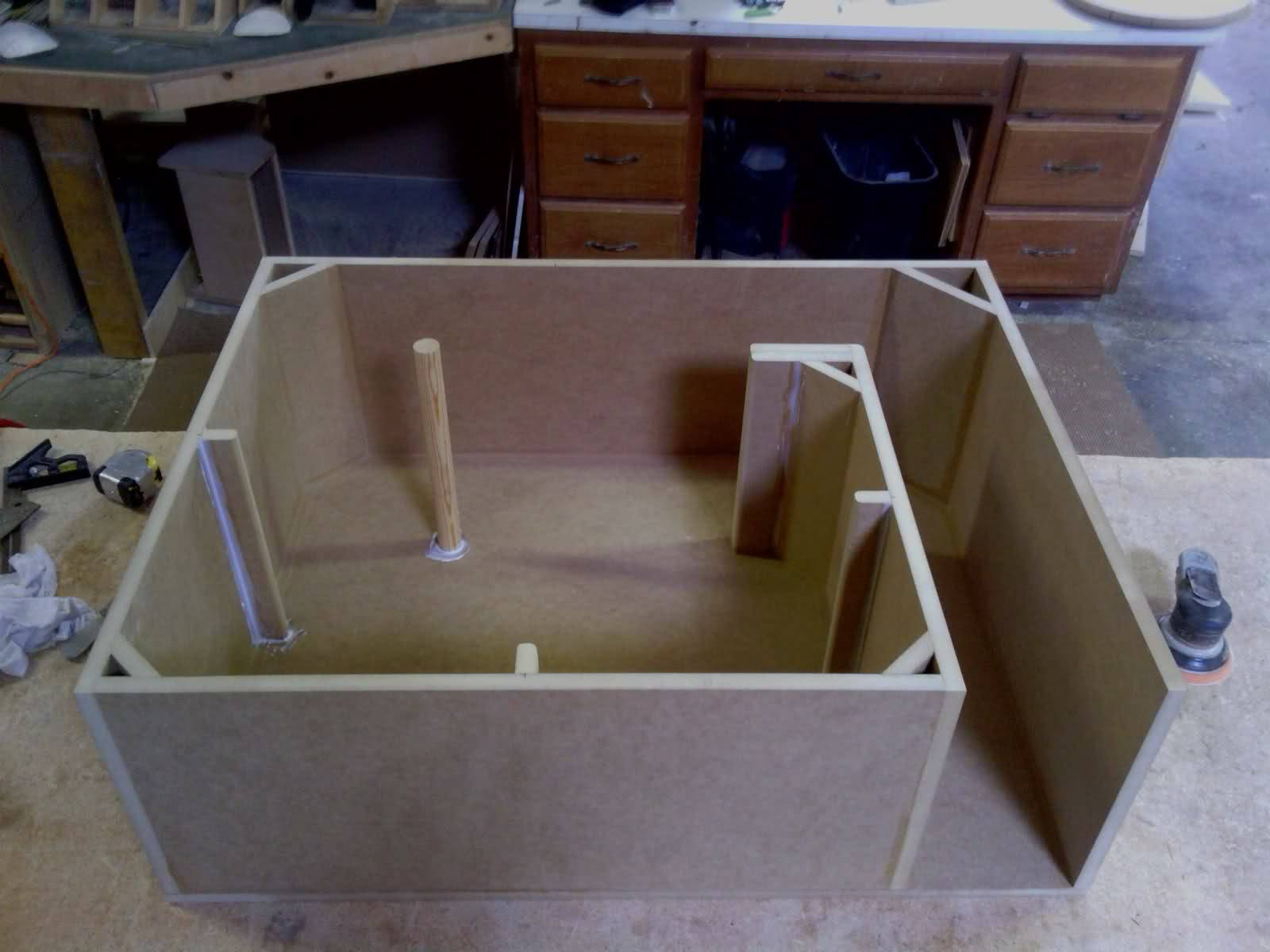

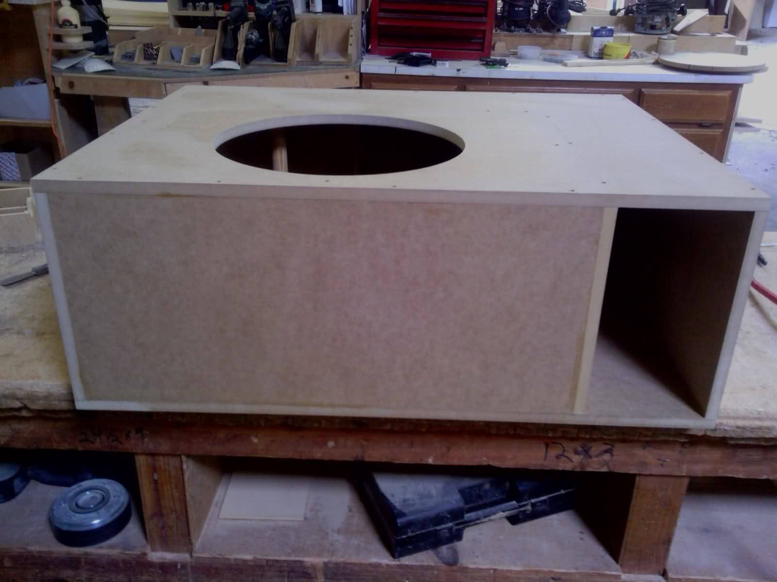

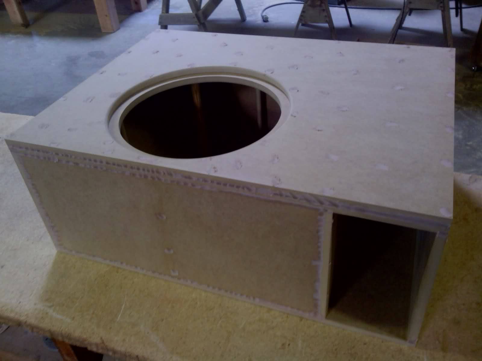

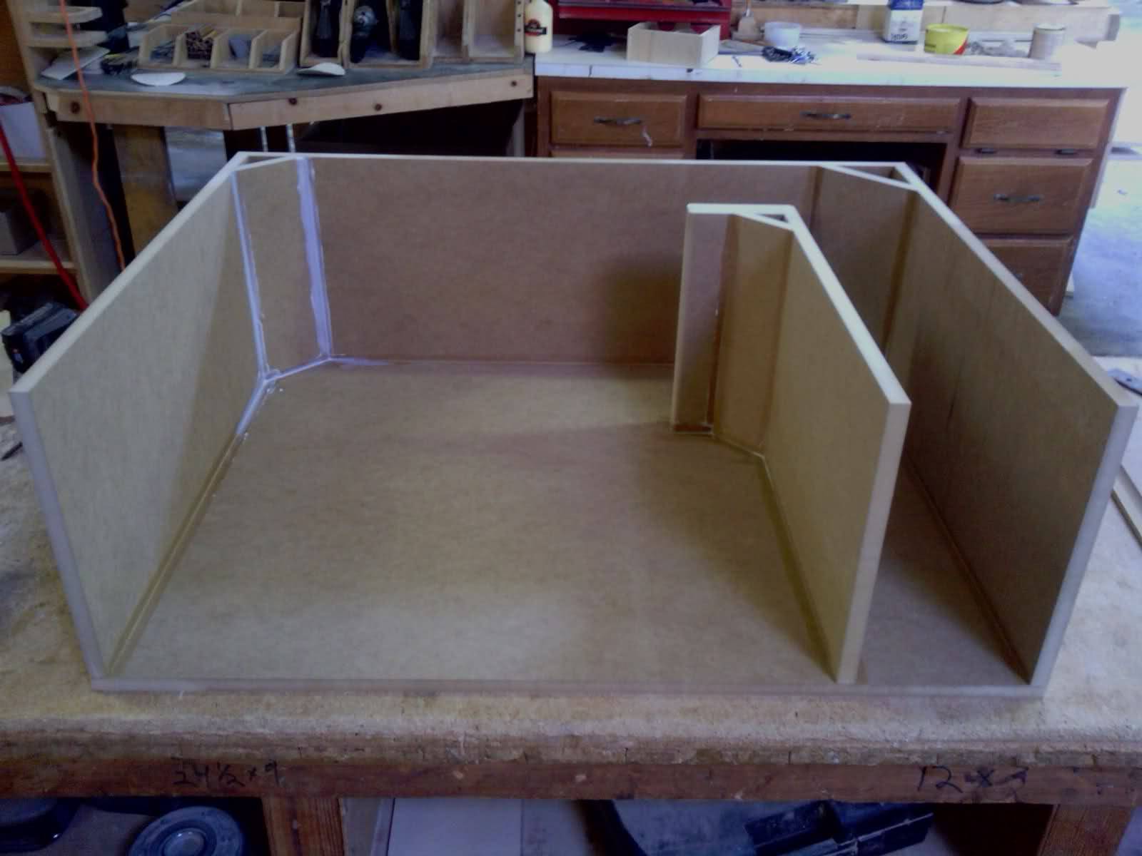

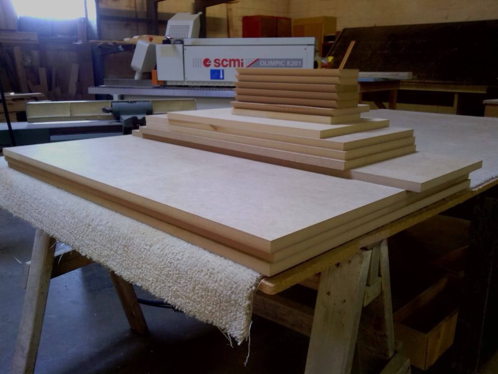

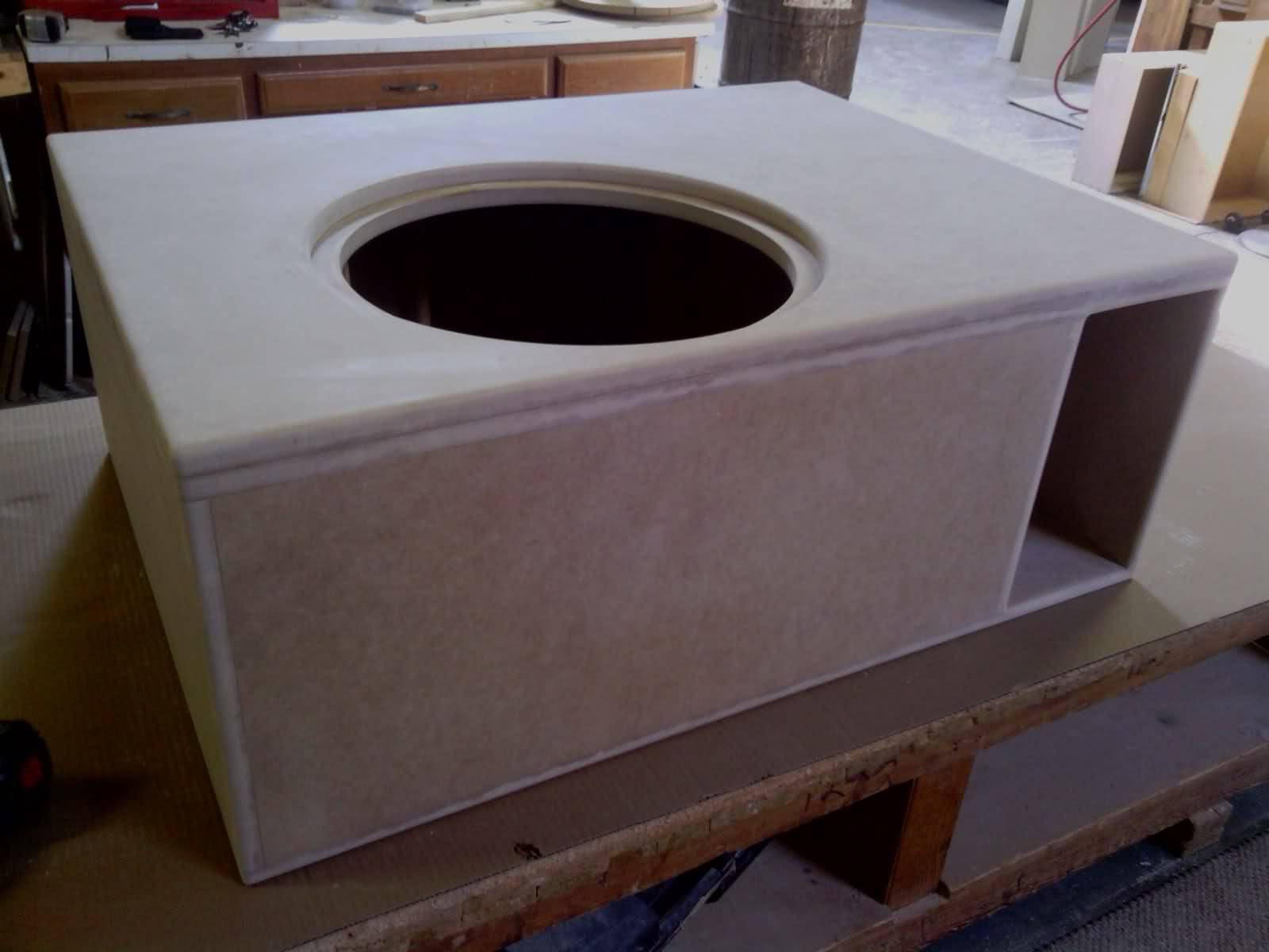

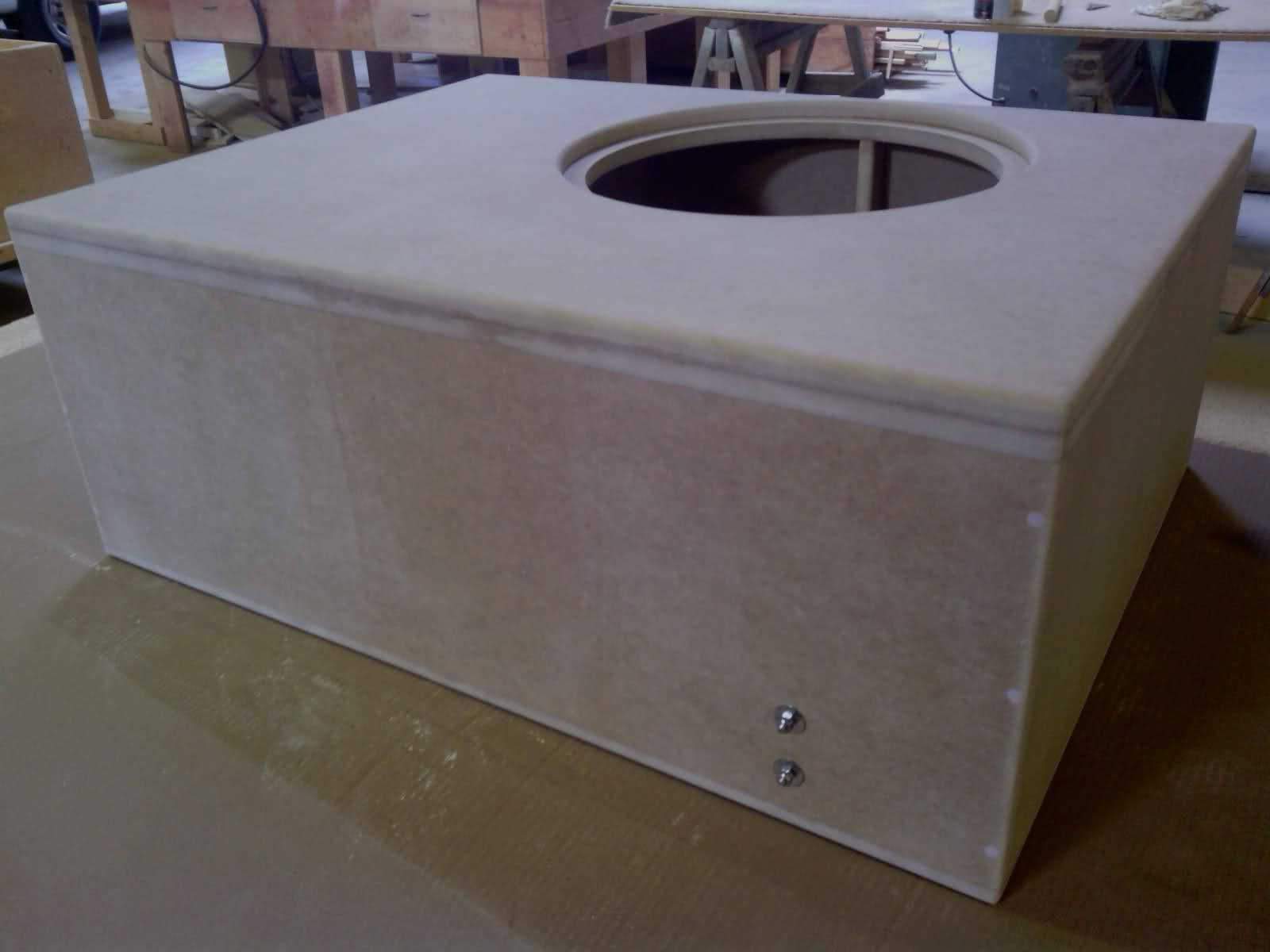

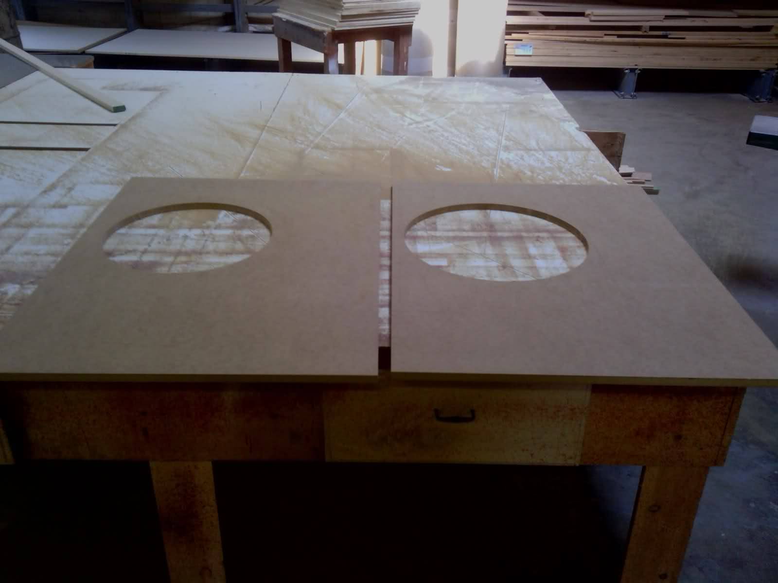

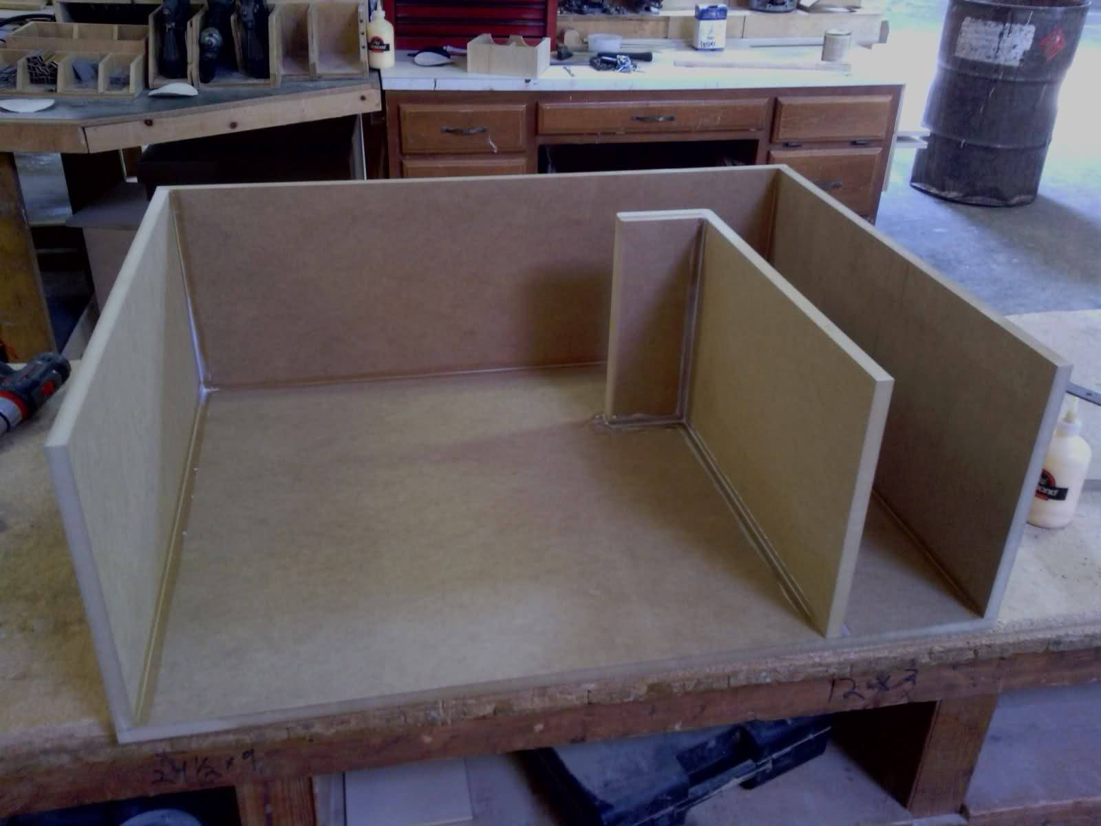

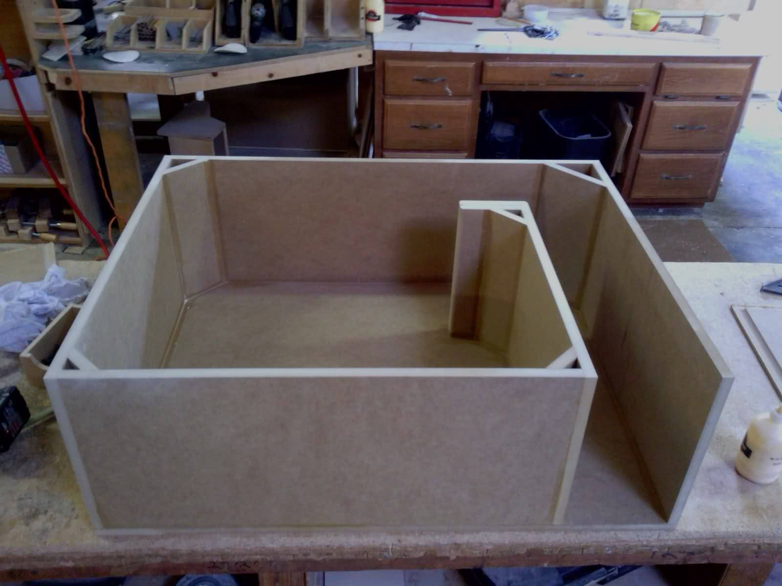

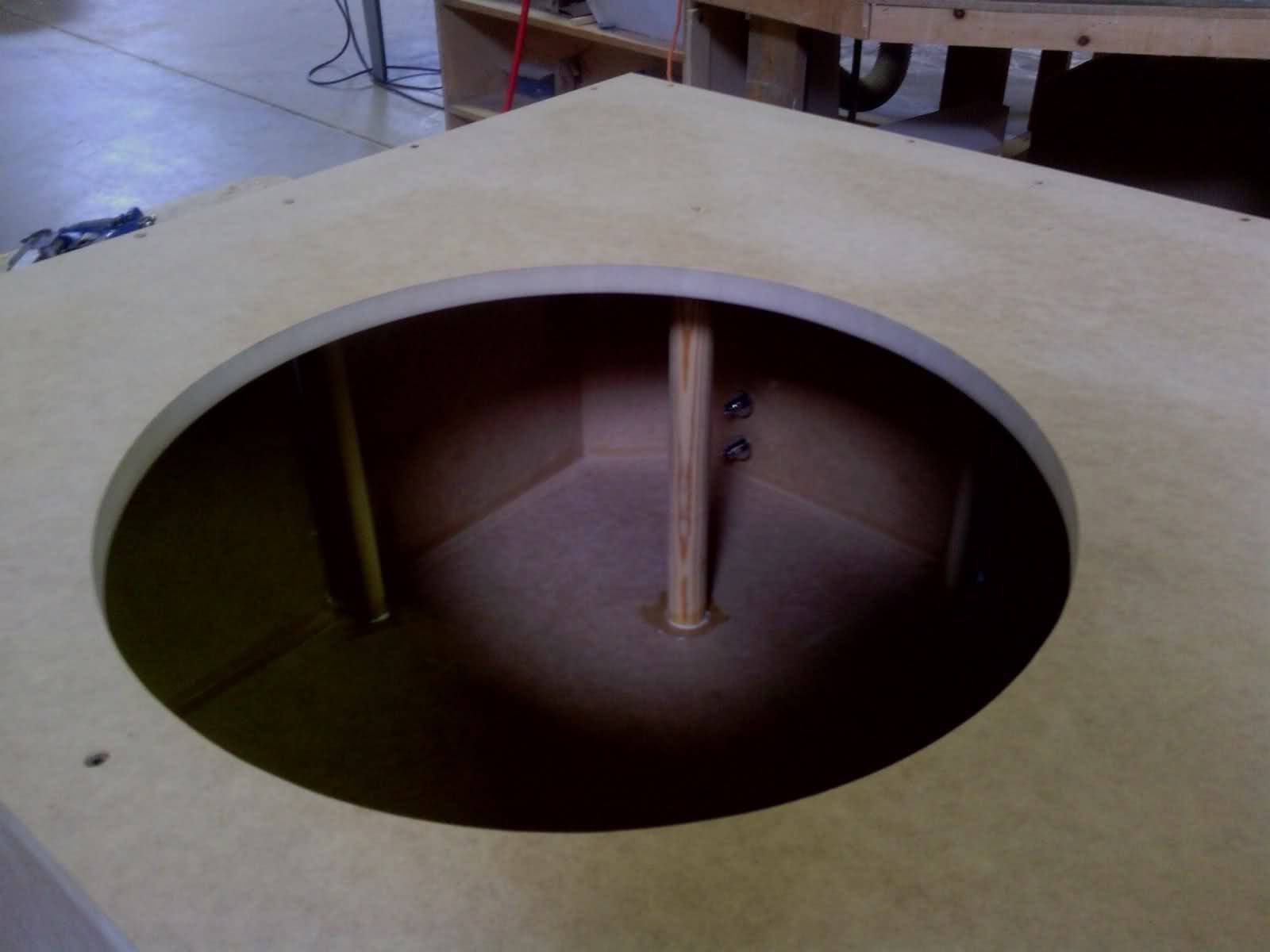

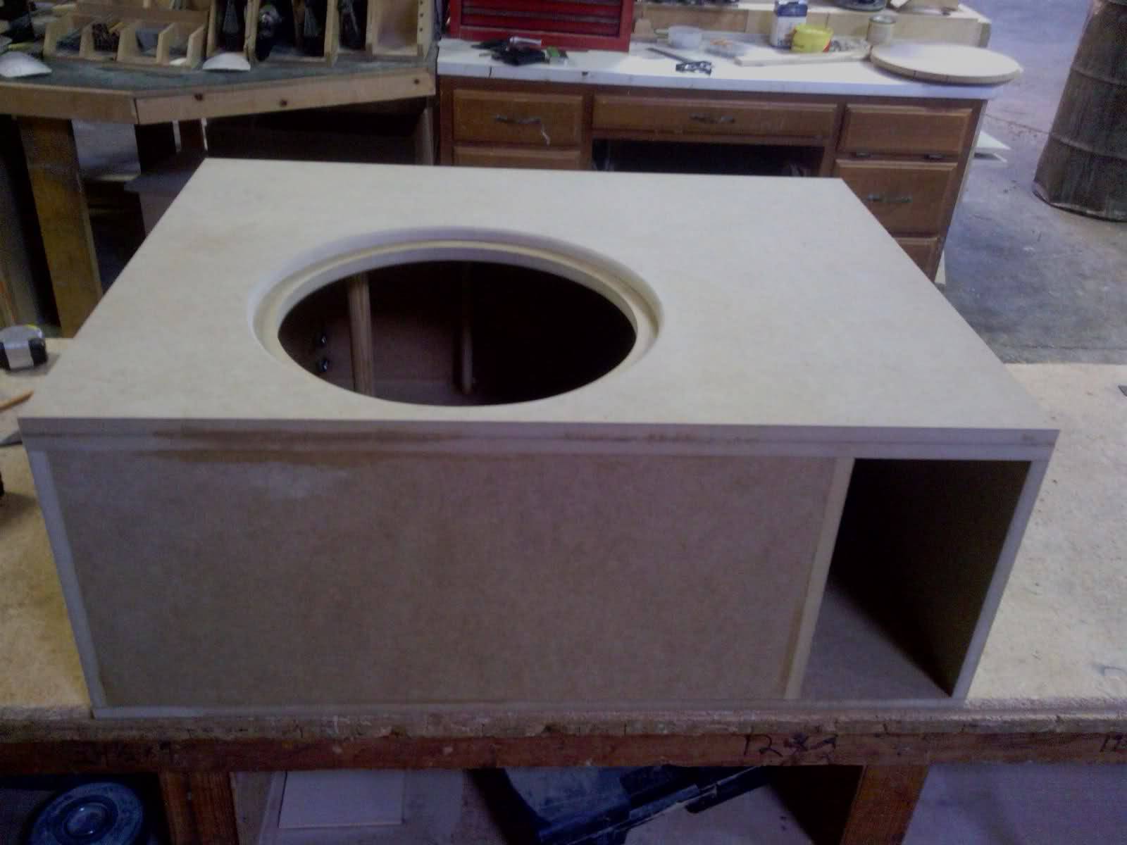

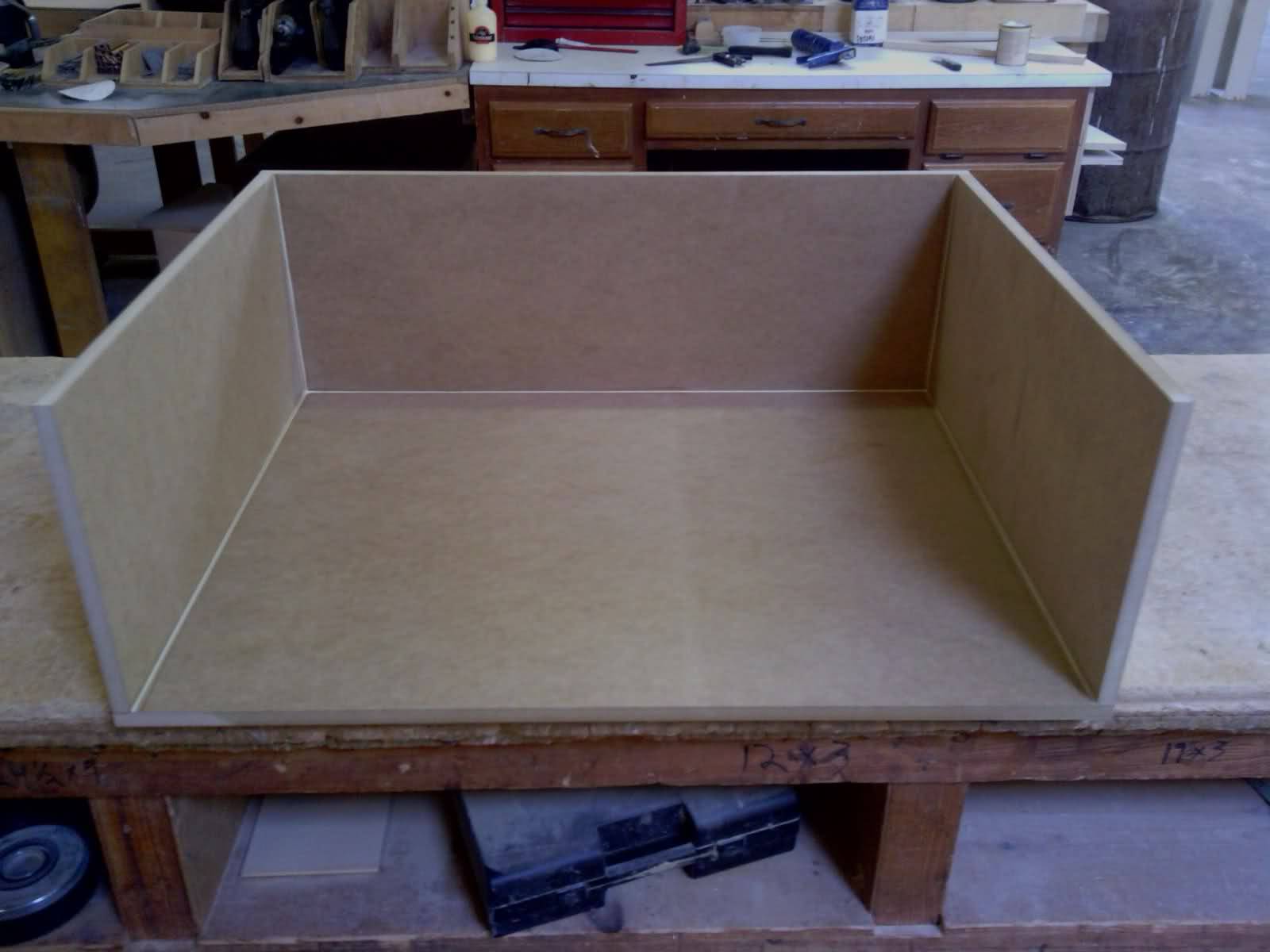

I'm building an enclosure for a DC Audio Level 5 18" for a guy locally.
It's going to be 6.3ft^3 tuned to 33hz.
Here's some pics
i think this is brandons box not woolrige but another dood. anywho good work as always. i couldnt text you a pic but ill guerentee you those batts are good to test course you will find out //content.invisioncic.com/y282845/emoticons/smile.gif.1ebc41e1811405b213edfc4622c41e27.gif
[quote name='CAT MAN']i think this is brandons box not woolrige but another dood. anywho good work as always. i couldnt text you a pic but ill guerentee you those batts are good to test course you will find out :)[/QUOTE]
It's for a guy named Mark, going in a Nissan Armada.
I think he's putting a Crescendo 3500 on it. @DCtC ; designed it, and I did my thing with bracing and 45's
