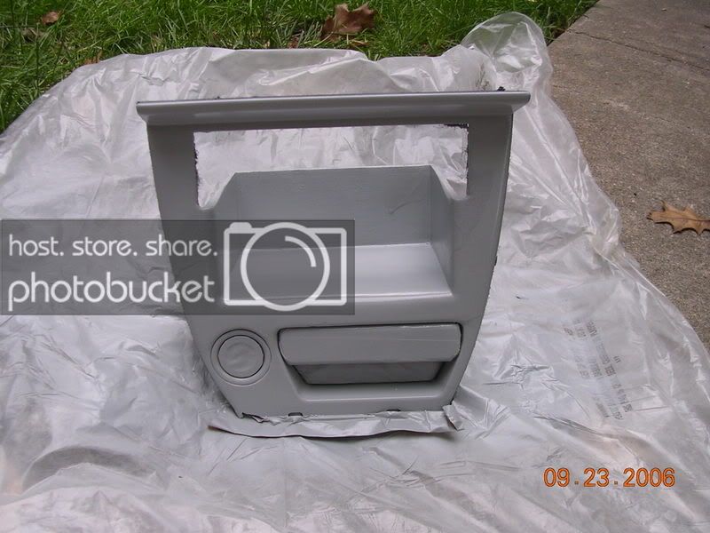

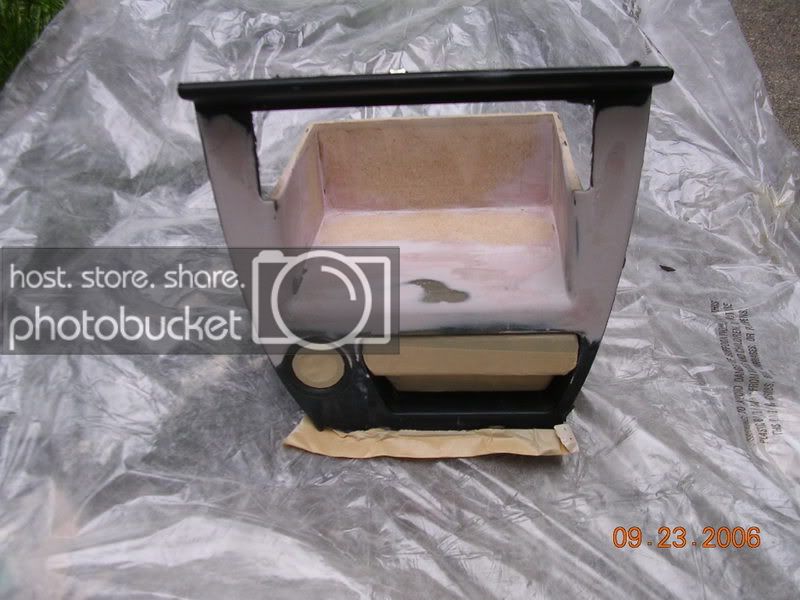

Picked up a can of Duplicolor primer filler. Got everything sanded and ready for the primer.
And here it is with a coat of primer. There are a few runs, but nothing that won't sand off easily.
Gettin' close, fellas!
it really makes no difference with primer. your sanding it down anyways. with paint....your absolutely right, primer doesnt really matter.
Yeah, I don't consider myself an expert at all in this category, but I have enough experience to know that I can't do that with the paint. I was just tryin to fill some pinholes.
