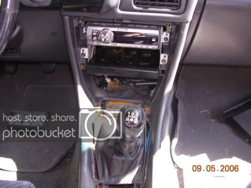

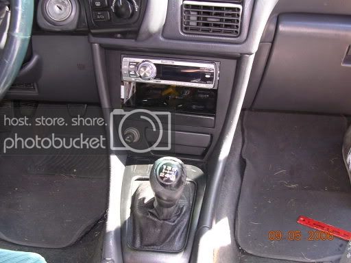

Before:
Taken apart:

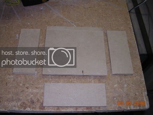

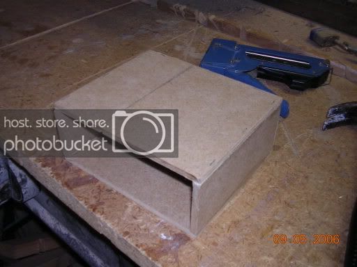

I'm making the pocket out of 1/4" MDF wood. Its external dimensions are 7"x6"x2 3/4".
I used staples to help me hold it together until the wood glue dries.

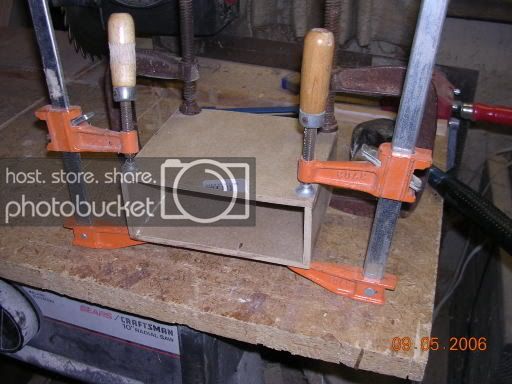

And this is the stage that I'm at now. I just put clamps on it, and I'm going to let it set up for a while.

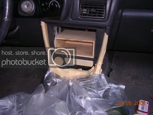

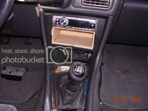

Allright, here we go. I got the box in the dash for a test fit. Perfect fit.
Here it is with everything taped off, getting ready for the glass:

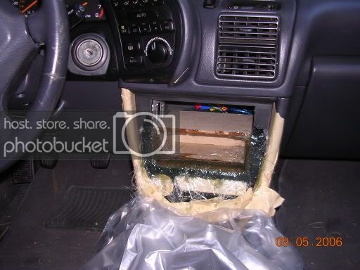

And we got the glass on and drying. It was a pretty small project, only took me about 30-45 minutes for the glassing.

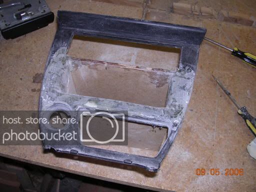

Here's the back after I took it out and glassed it:
And here we are with about 30 minutes of sanding:

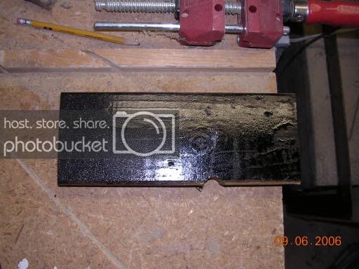

Allright, on my way home from work tonight, I stopped in at Home Depot, which is probably the best store ever created. //content.invisioncic.com/y282845/emoticons/fyi.gif.9f1f679348da7204ce960cfc74bca8e0.gif
I was browsing in the paint section, and I found some pretty cool shit. I couldn't pass up the metallic black paint. I bought a black semi-gloss for the base coat, the metallic black for the pizzaz, and a clear coat lacquer for the top coat.
Here's a test on a scrap piece of wood, no primer (metallic on left, black on right, both with a coat of clear over top):
It looks so much better in person. And keep in mind, this is a scrap piece of wood - no sanding, no primer.

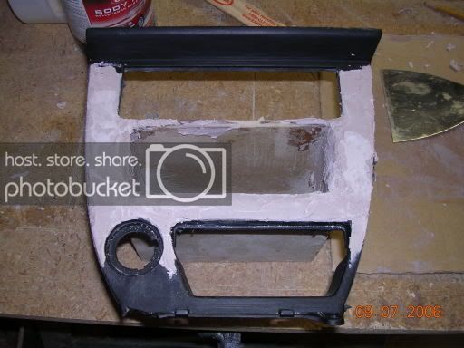

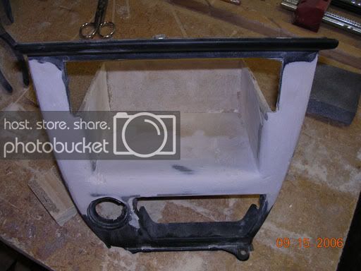

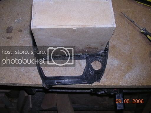

Sorry for the long wait, fellas. I've been workin like mad. I thought about what DBfan said about the HU getting hot and I jigged the top of the pocket off. It didn't change the look at all once installed, the trim ring covered it up anyways. I also got a lot of sanding done today. Here's a pic:
