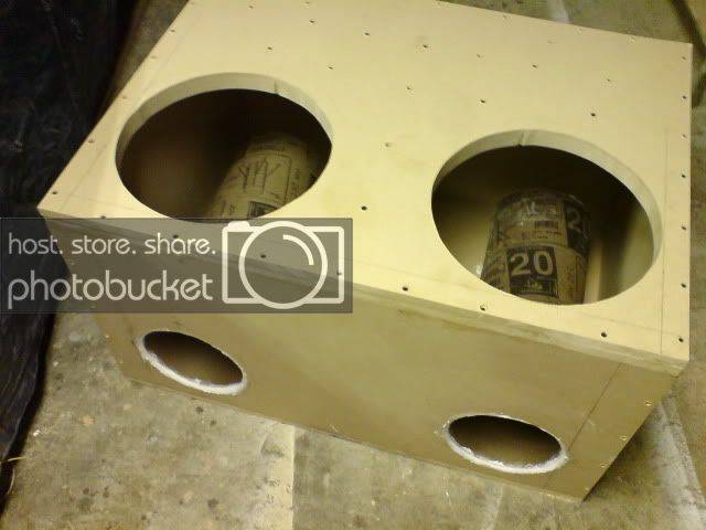

first i am going to go with the box,decided to go ported 9cuft net with 2 8" sonotube ports at 32hz on combined chamber.
some pictures:

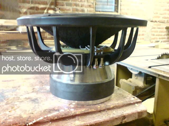

the sub

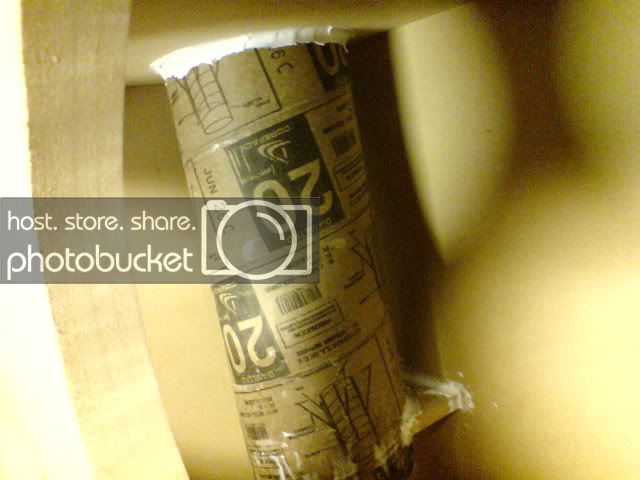

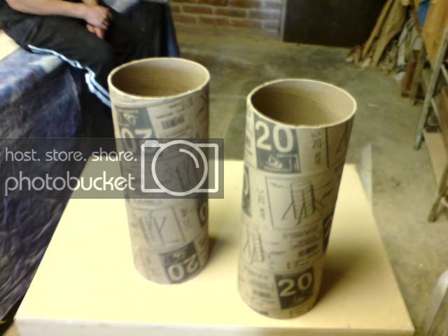

the sonotubes

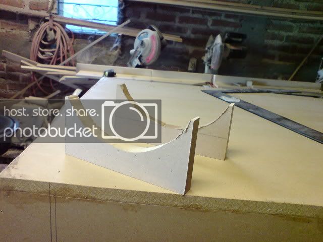

sonotube braces

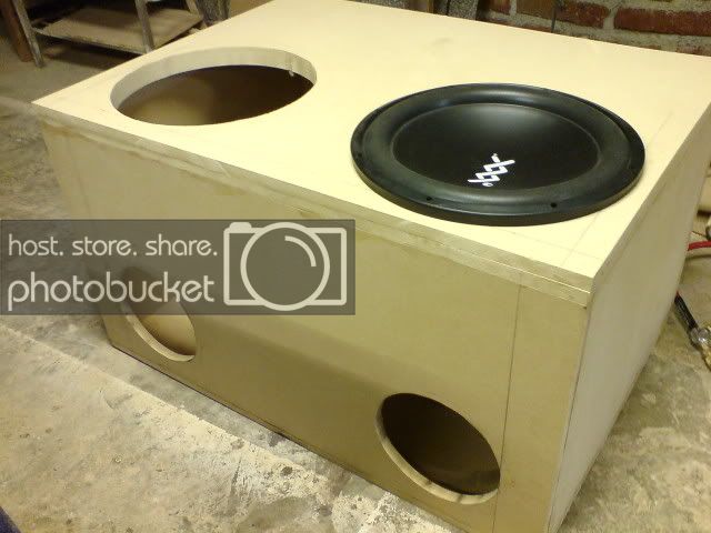

box

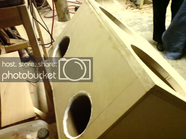

box with ports,used construction adhesive (hard as f***k),routered port end,still need to sand it down
