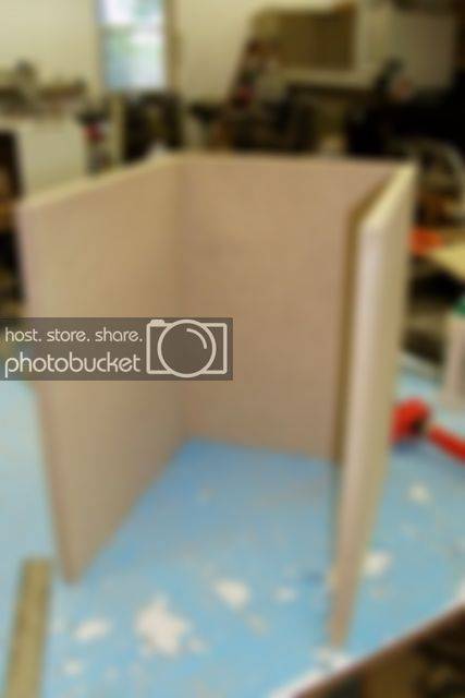

This is my first ported box. I've built several bandpass and many sealed ones. Decided to try something different. Plans came from the Diamond website for the 12" D6. I used titebond 3 and 1.5" brands to hold everything together. Clear silicon to seal it up. Feeding it 800rms. Seems to like that well enough, on to the pics.

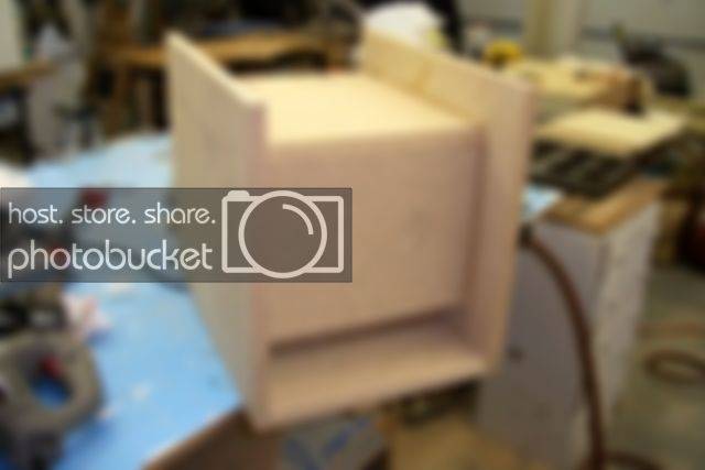

3 sides

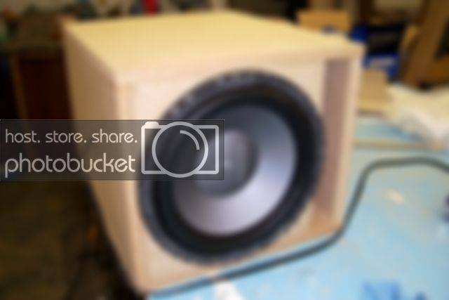

nice edges

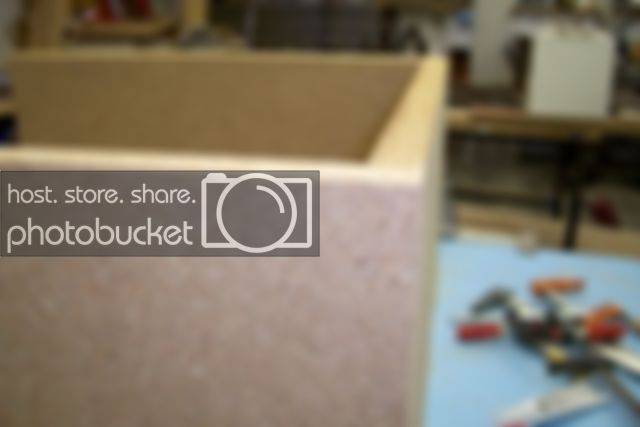

side view

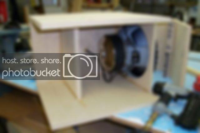

port wall
finished product
Thanks for the comments. The port is super long, 2x12.5x43. The box is pretty small itself. Fb=40hz F3=33hz The wood is 3/4 stuff I got at a local store. I got 2ftx4ft sheets because I was handeling it by myself, and I get terrible cuts on huge 4ftx8ft sheets. It is way louder than sealed. Especially around 50-60hz. It gets low to. Midbass has gone away, so I need to add some small woofers. But I like it.
