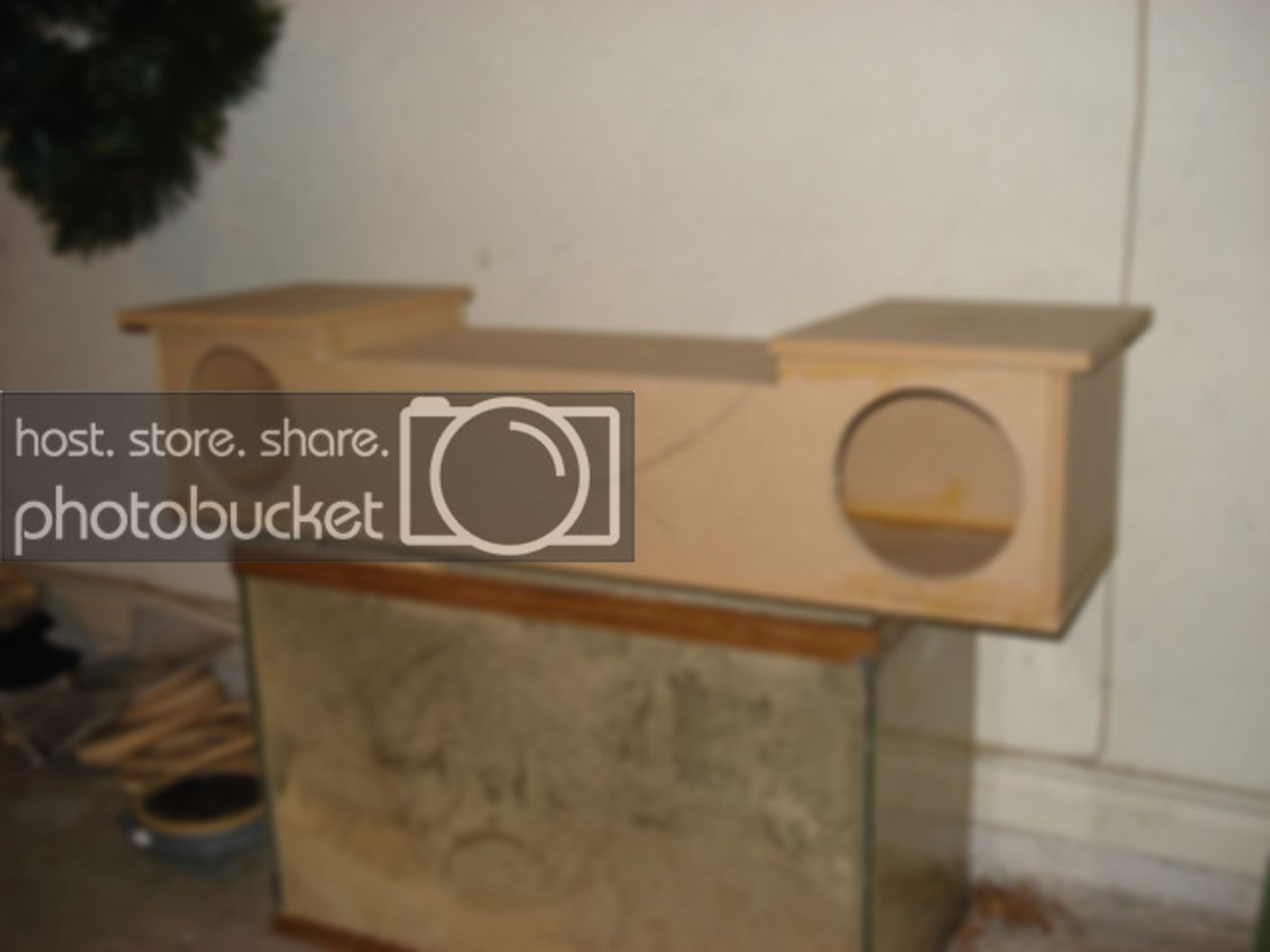

I'm building a box (with the help of chevyaudio an Jntar) that I will need to use the elbow piece too.
Since I am tuning to 30hz I need my two 2" ports to be about 18in long for my box.
Problem is my box is only 8 inches high and the ports will be on the top.
If I run the precision ports 6inches down, elbow towards the middle of the box and add a 12 inch piece what can I use to keep it from moving?
Here is a pic of what I am talking about...Ports from each top down and toward center

i didn't have luck with PVC/ABS pipes and elbows. I made a box for a 15" mag w/ two 4" pipes w/ elbows and it had port noise. I'd say go with flares if you go that route.
well yea of course flares would be used on both ends. How do you keep the port tube stable on the inside of the box? It just seems like the tube would wiggle around in there if it was long.
brace them w/ some mdf that has the diameter cutout for the pipes and stick them through...
