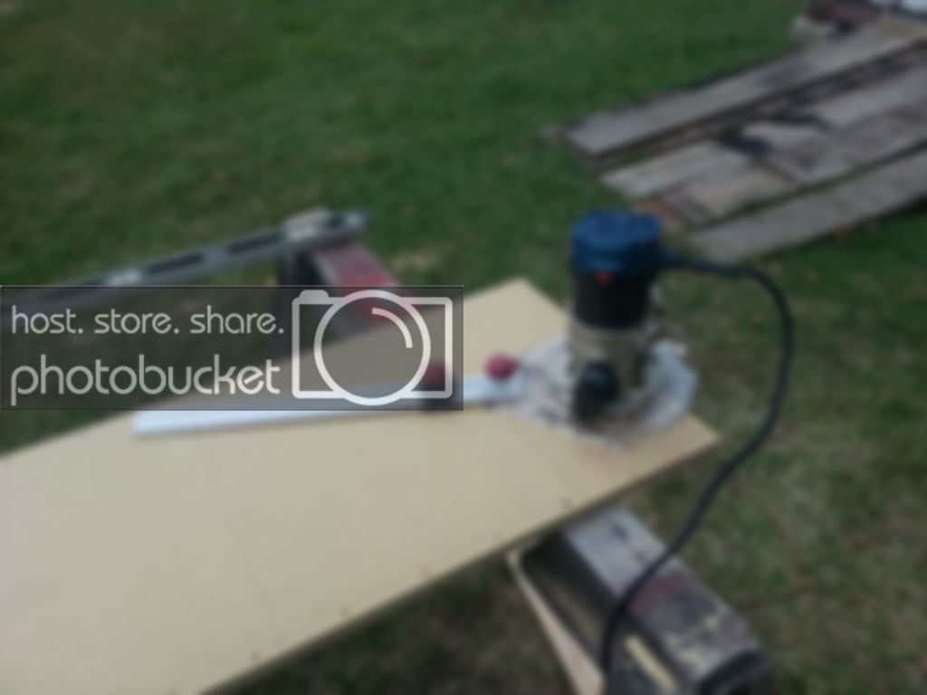

I say just use a jig like this with a flat bottom bit and cut out your center ring then outside or visa versa. Your router should have a depth adjustment to take just enough of each baffel.
