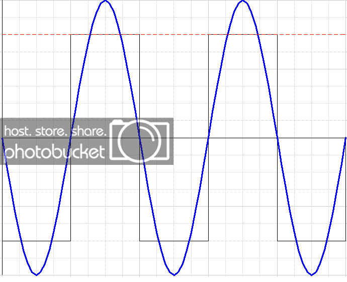

This is what I'm talking about.
Blue = 400w RMS amp black = 200w RMS amp square wave
Both have the same RMS power, but the 200w amp snaps straight to the RMS power where as the 400w amp gets their slower, then continues to rise above the RMS power and stays above it and then drops back down.
This means that the coil will be jerked back and forth (why it sounds like *** to us) or it will gradually move. Either way it is going to heat up the same ammount over time. //content.invisioncic.com/y282845/emoticons/smile.gif.1ebc41e1811405b213edfc4622c41e27.gif
