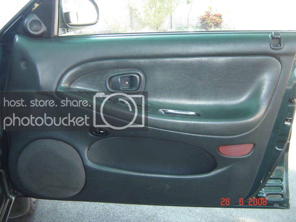

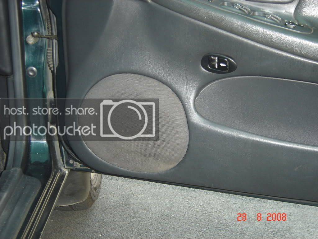

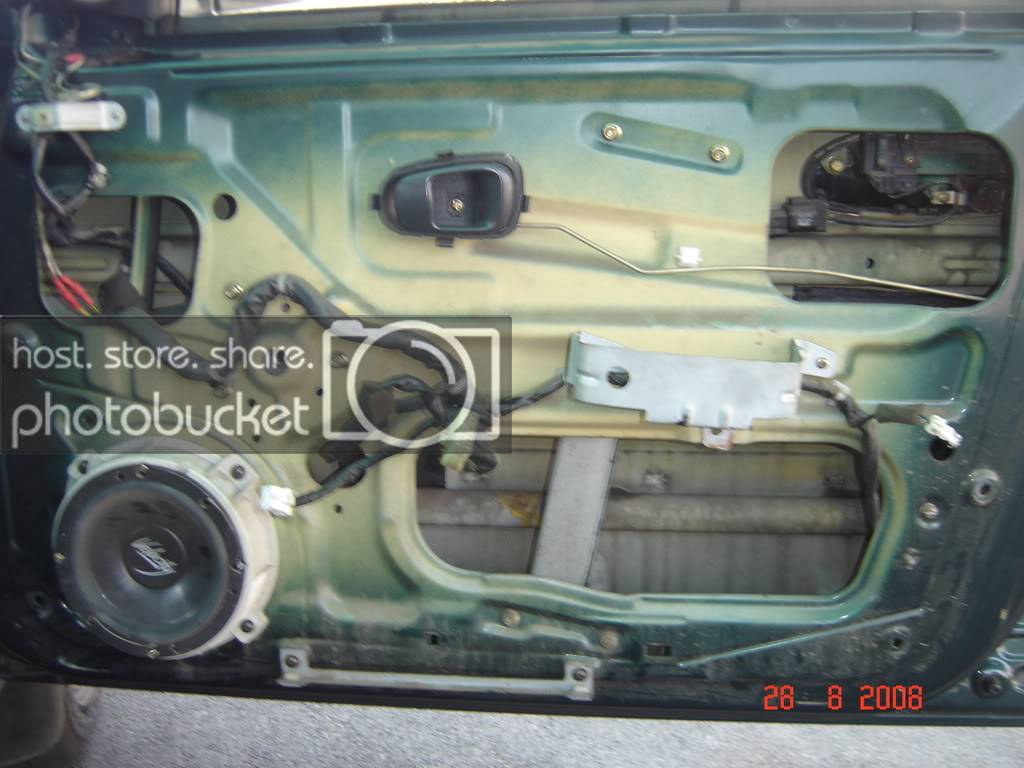

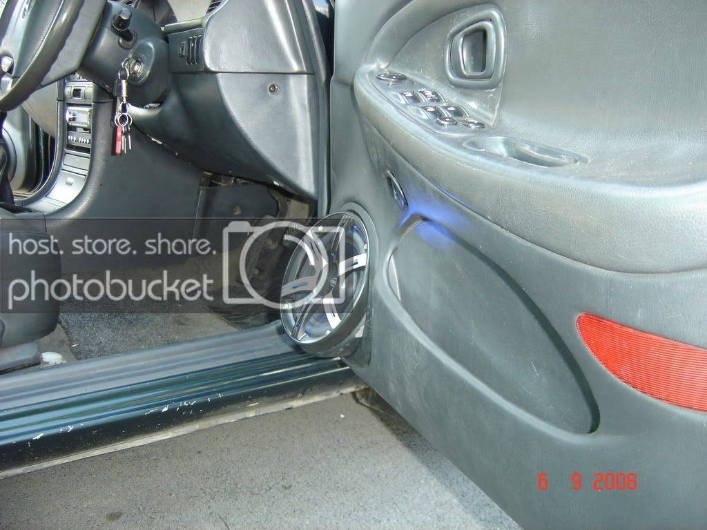

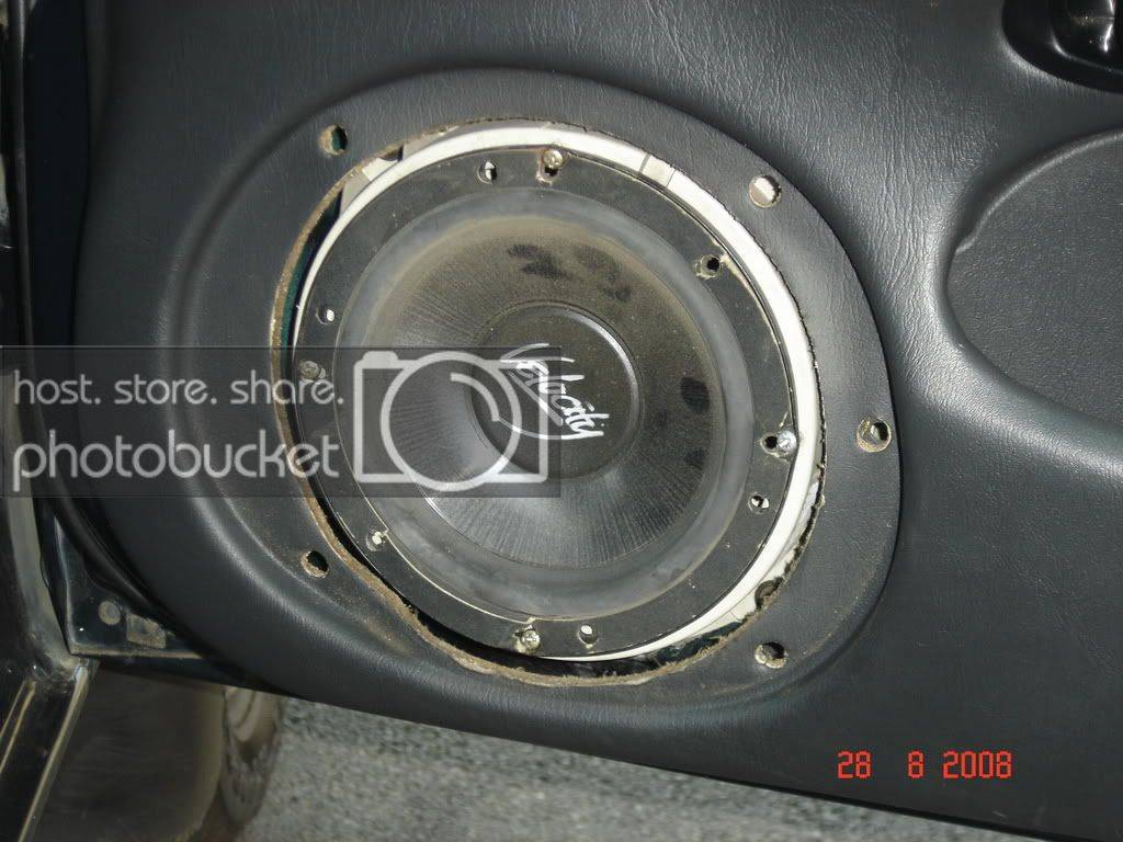

My good old faithful velocity's. Had these for about 8 years. They gave me some good service. This range of speaker by blauphunt was the first speaker that i know of that brought a dvc speaker. It was a 6x9 and man did i drive those things hard. Hard enough in fact to kill them about 3 years ago
Door panel off

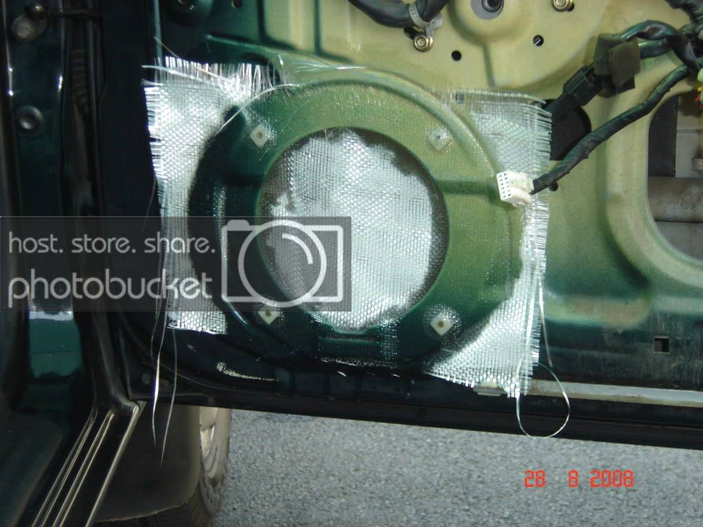

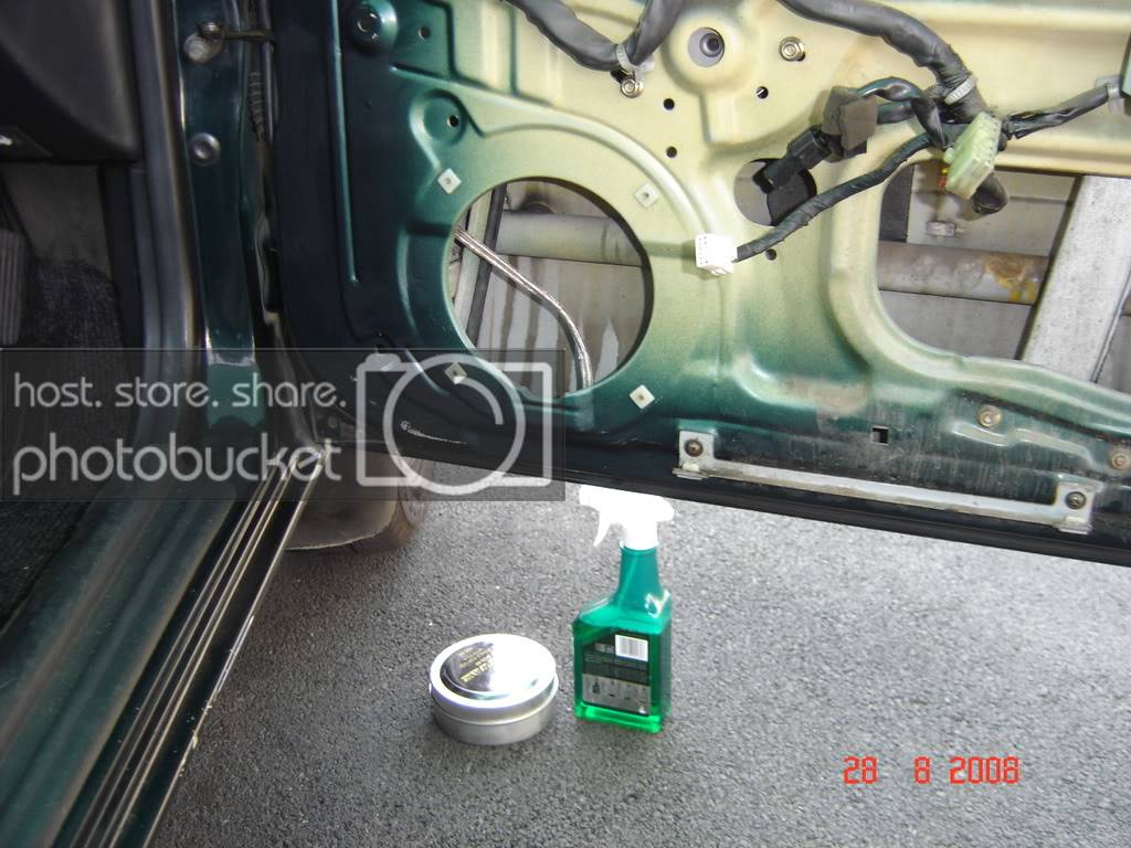

Speaker removed. Door cleaned, waxed and ready for glass

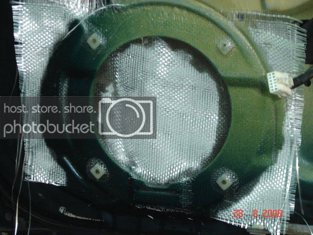

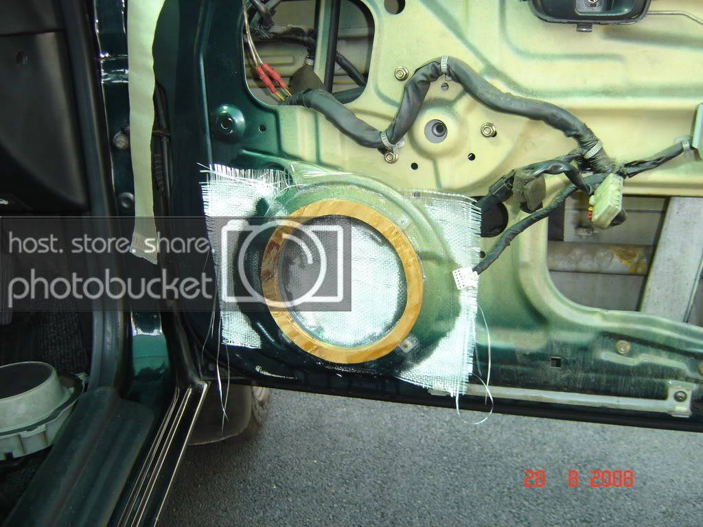

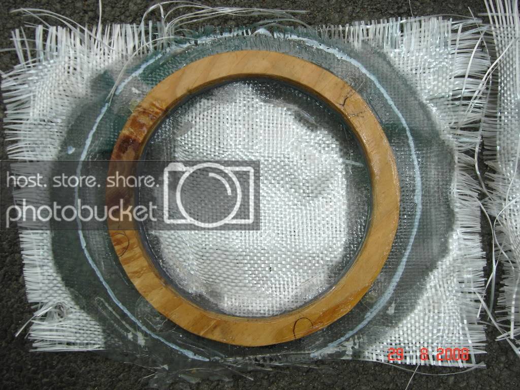

First layer of glass laid
Second layer of glass done

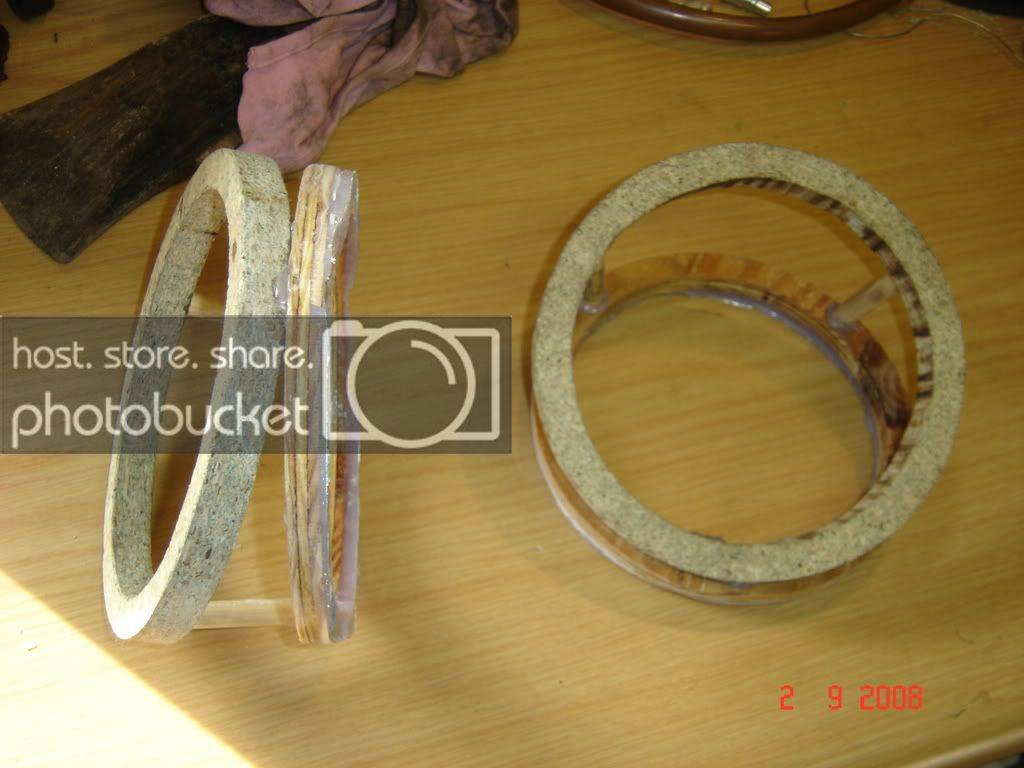

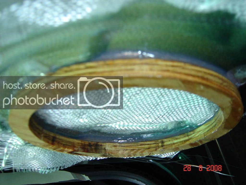

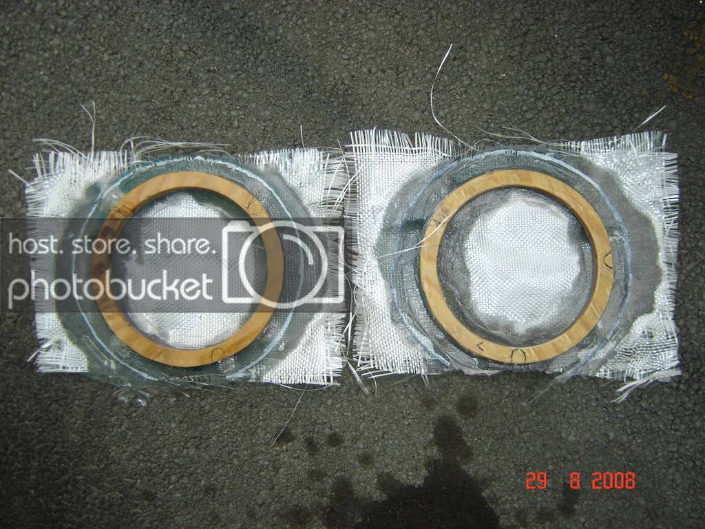

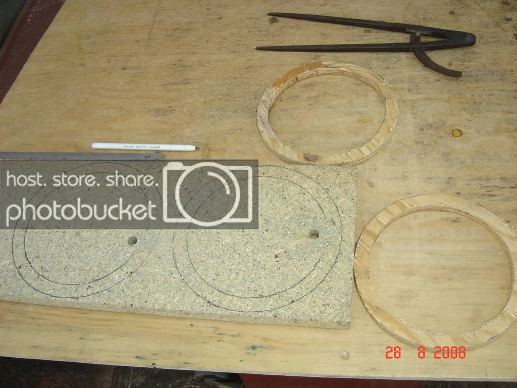

Rings cut

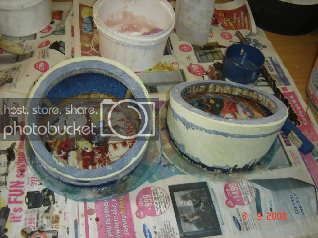

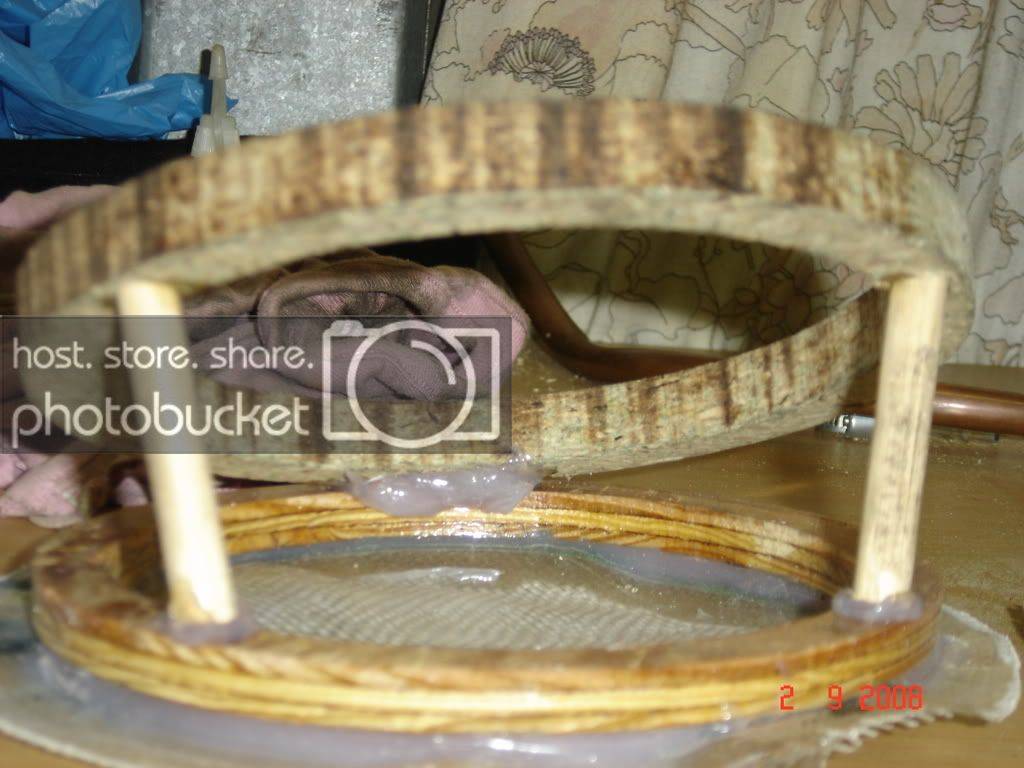

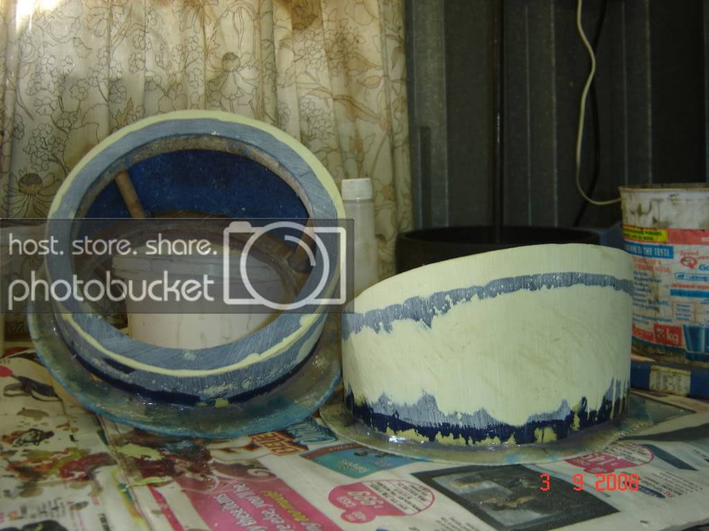

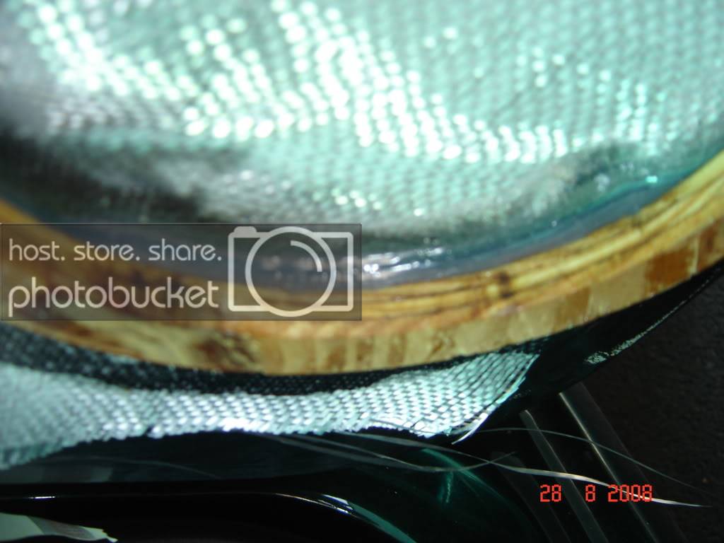

First ring mounted with pregel to keep them in place and seal off all the gaps

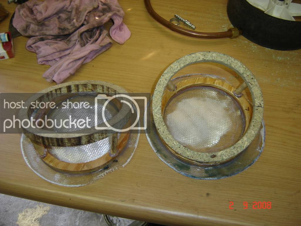

Glass marked where i want to cut and then removed from the doors

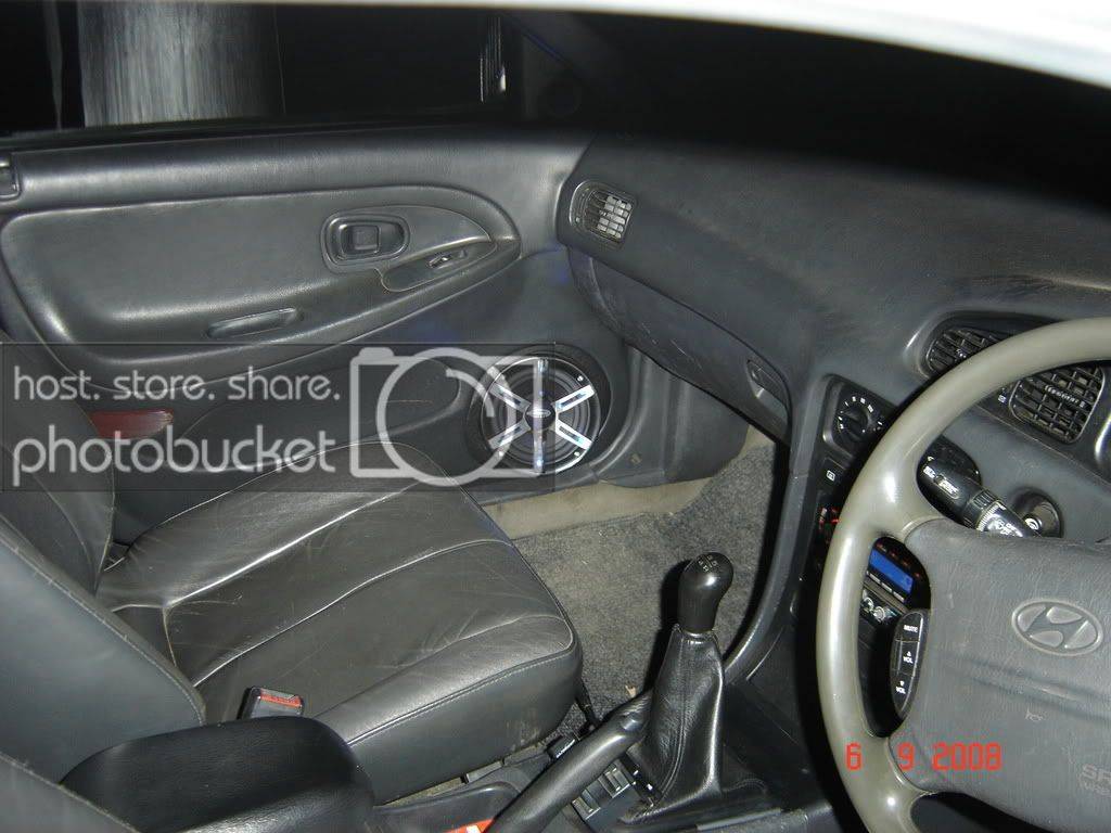

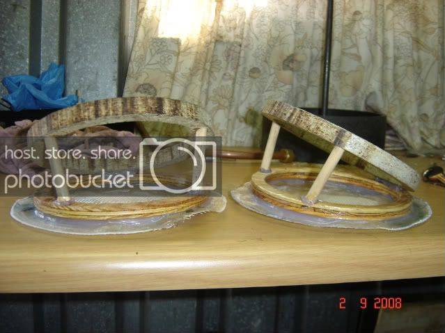

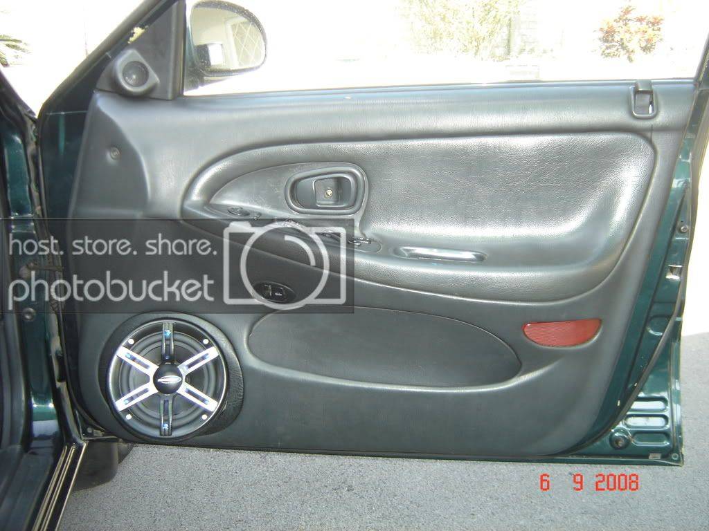

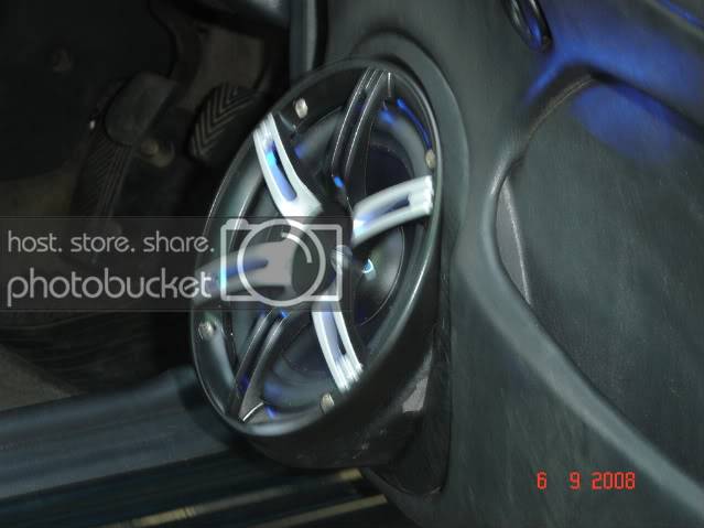

Top ring mounted at the angle that i needed. This was to try and get them to play as close to the center, top between the 2 front seats. Unfortunately the angle was way to much so i had to settle with a lot less

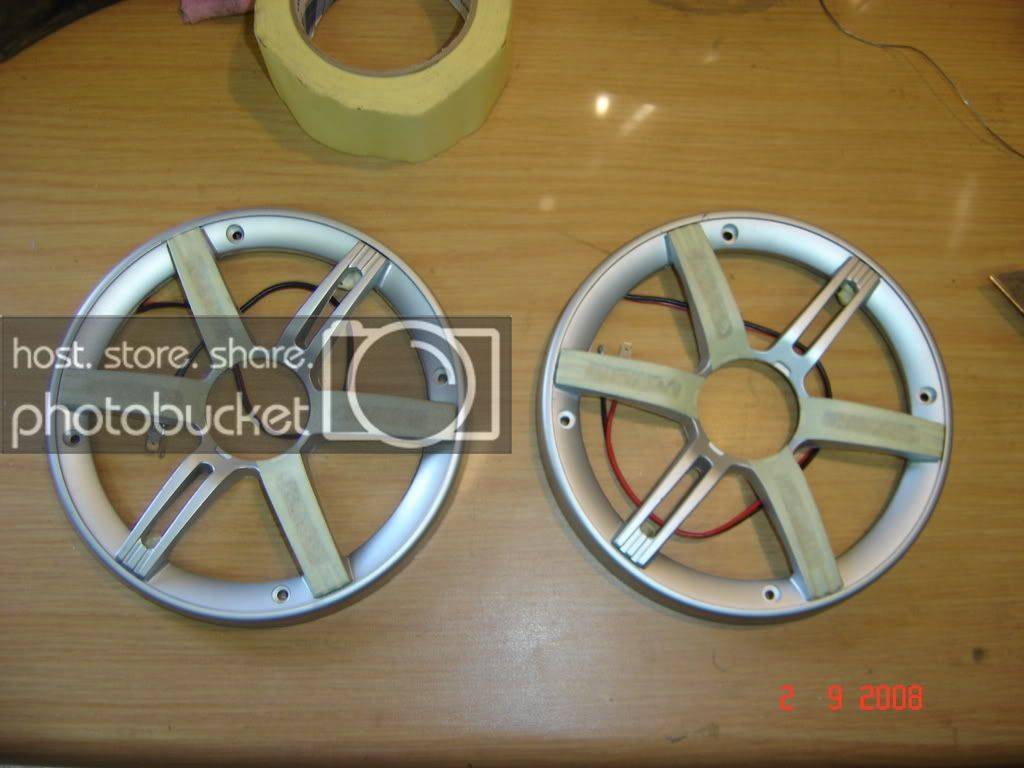

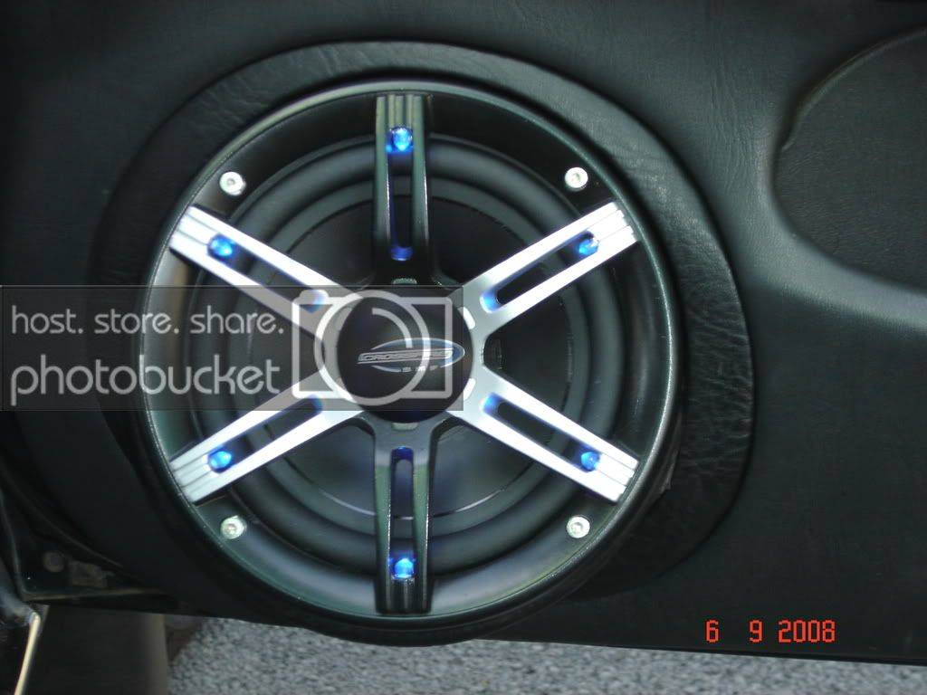

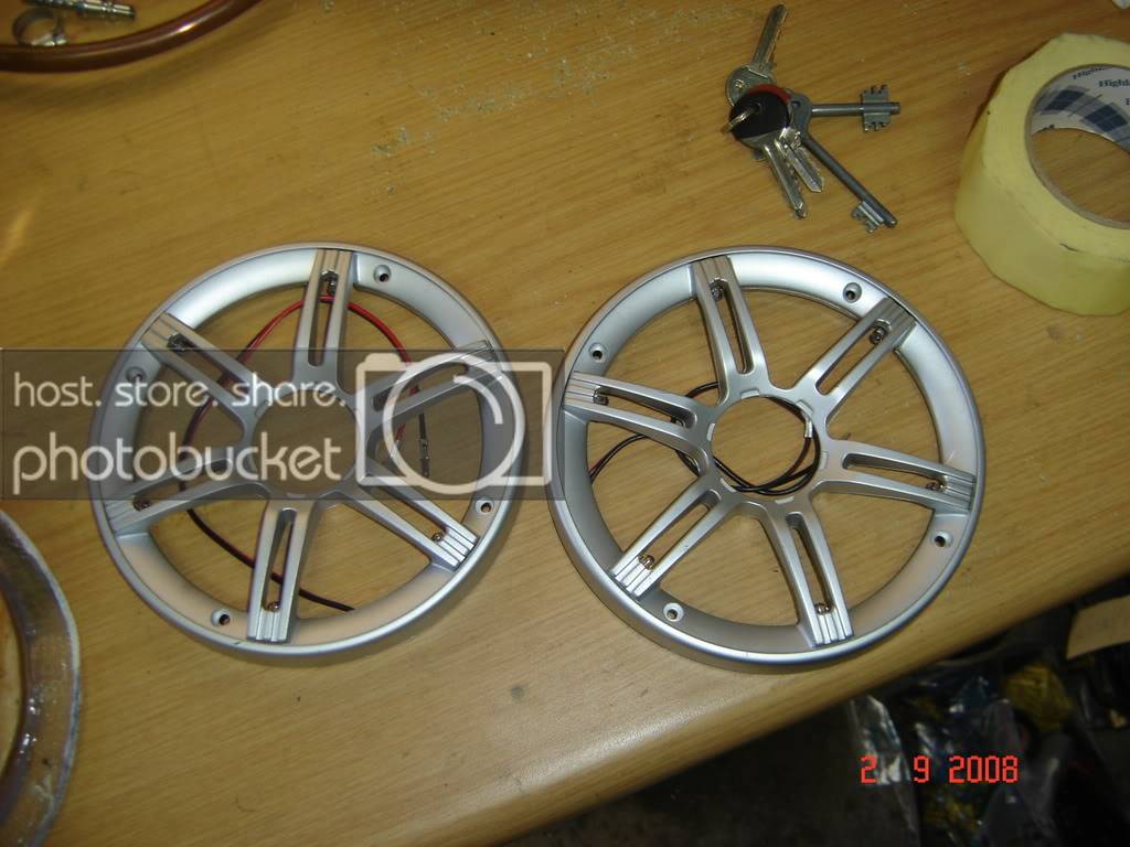

Grills that i will be using

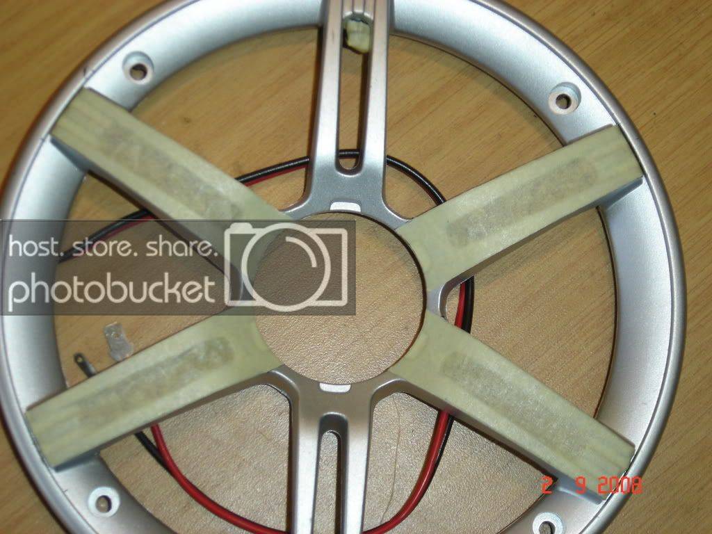

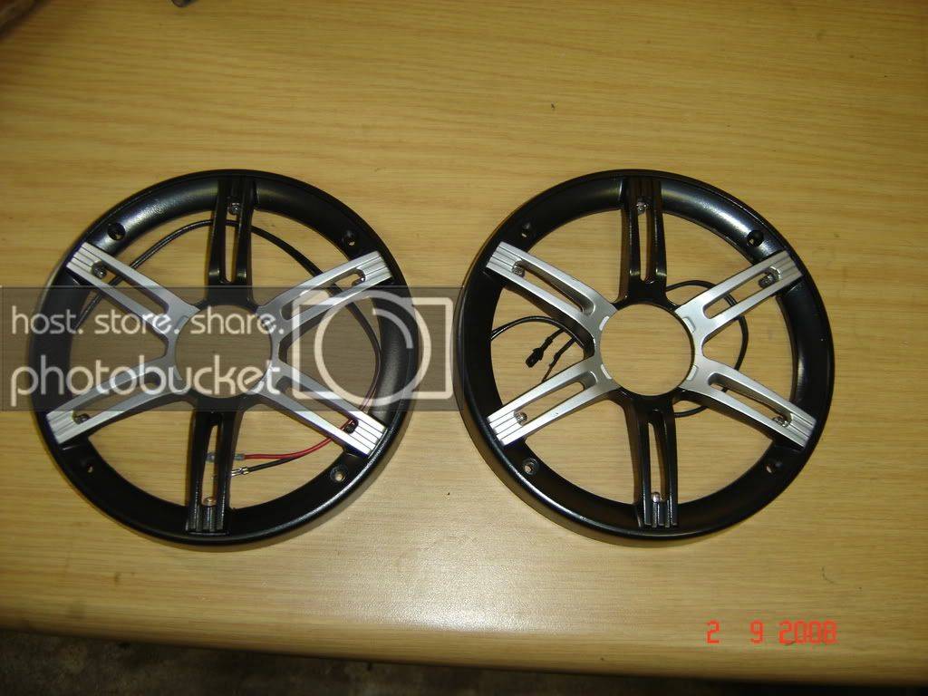

Grills need some modification so here they are masked and ready for paint
Painted and ready to be fitted

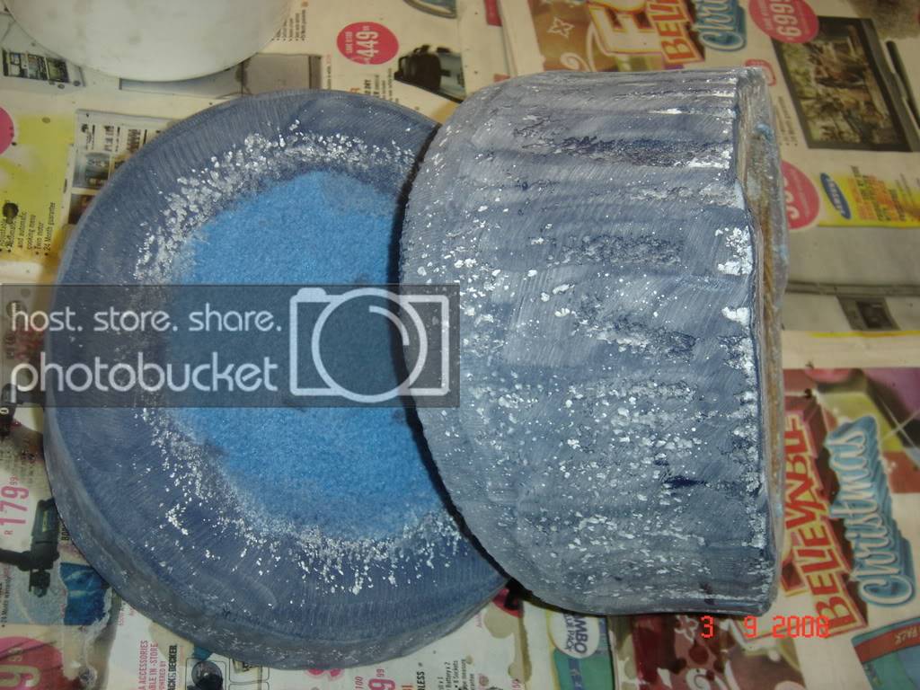

oops made a mistake and had to remove the door molded piece from the rings in order to stretch the cloth over the rings without any creases

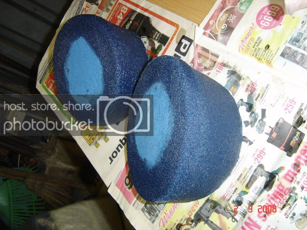

Cloth pulled over rings, clued to the bottom and then resigned. If anyone decides to do this make sure that the resign doesn't go anywhere near the glue otherwise it will come lose. To avoid this i placed the pods upside down on top of something.

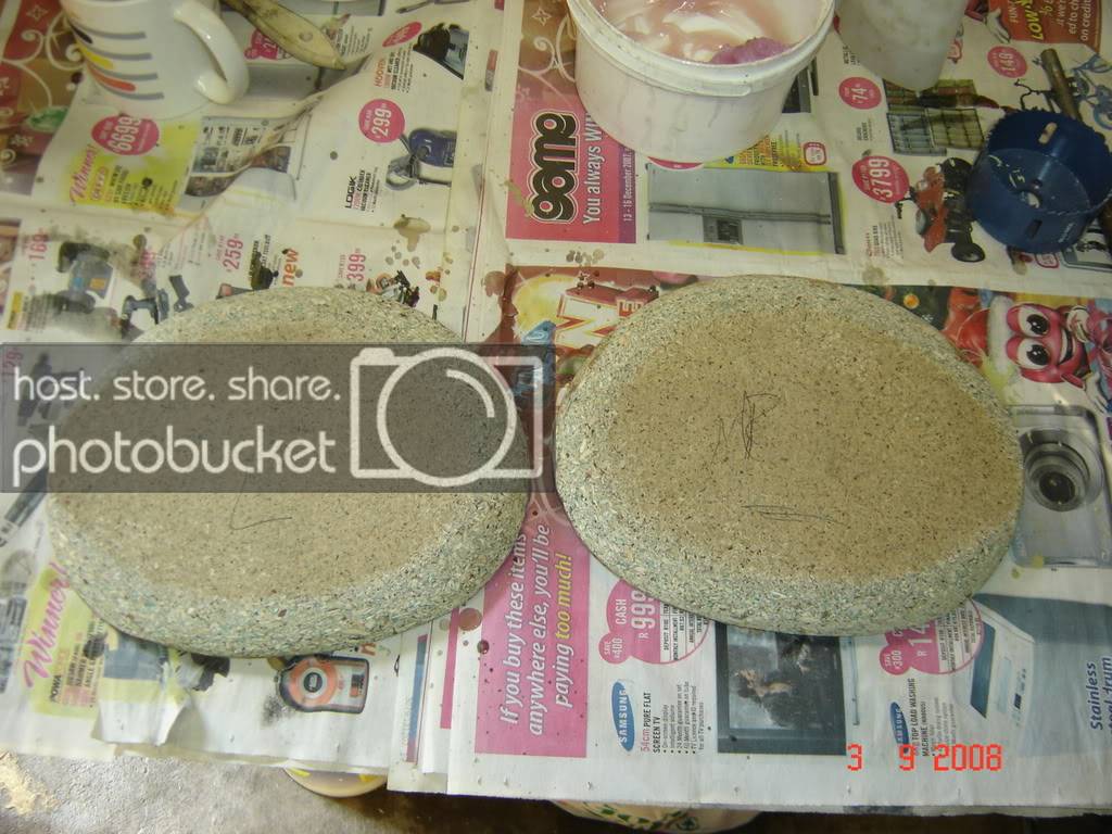

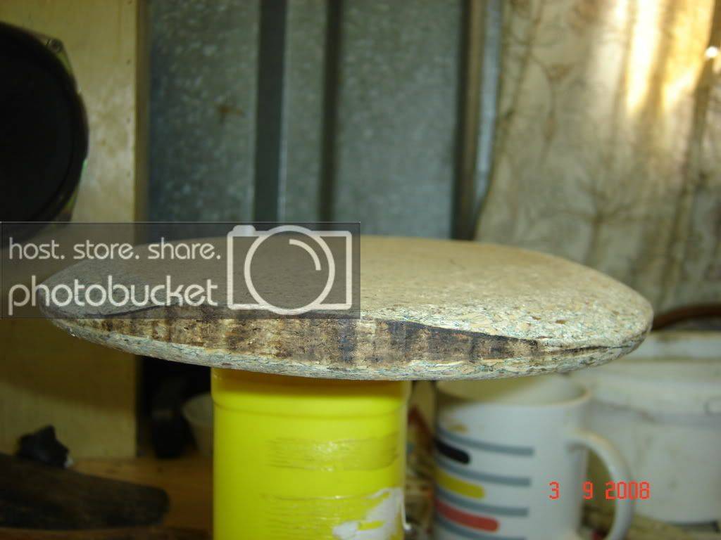

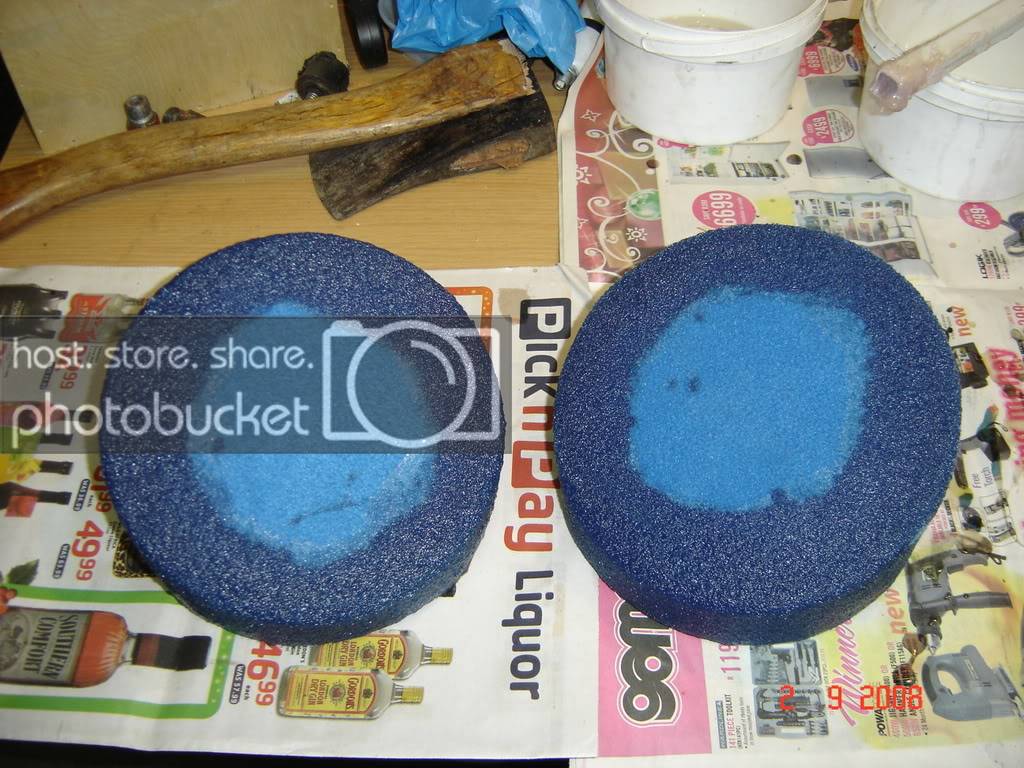

Pods ground and ready for body filler or as you guys would call it bondo i think.
Body filler added and then flattened with a sanding block to make it look smooth and straight
Filler boards cut and filed to fit flush with door panel and ready for trimming
