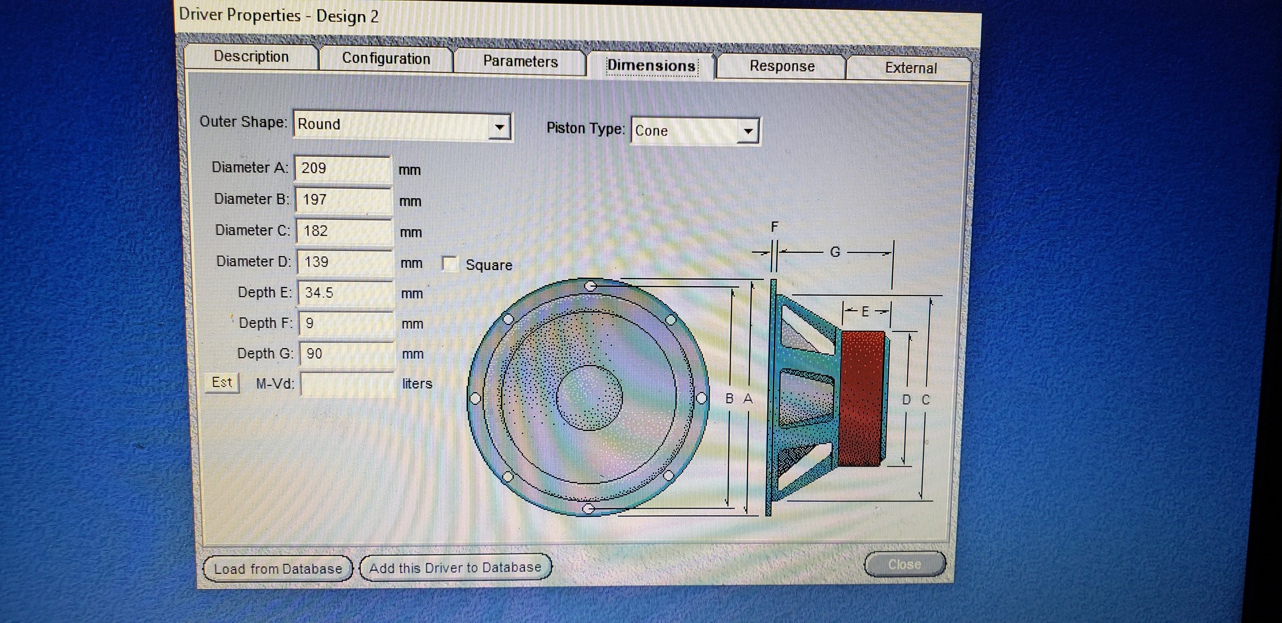

* This data was exported from the Dayton Audio Test System: DATS
* Dimensions were measured with digital calipers
* Piston Diameter = 166 mm
* f(s)= 73.15 Hz
* R(e)= 3.342 Ohms
* Z(max)= 59.2 Ohms
* Q(ms)= 9.207
* Q(es)= 0.5509
* Q(ts)= 0.5198
* V(as)= 10.68 liters (0.3773 cubic feet)
* L(e)= 0.7712 mH
* n(0)= 0.7236 %
* SPL= 90.69 1W/1m
* M(ms)= 29.15 grams
* C(ms)= 0.162 mm/N
* BL= 9.015
* K(r)= 0.02743
* X(r)= 0.5638
* K(i)= 0.0122
* X(i)= 0.6654
I'm surprised nobody reacted to this. These are the only T/S parameters for these speakers on the internet (to my knowledge) and these speakers are highly recommended on this fourm for mid bass. I digress.
In case anyone was wondering I designed a sealed and ported enclosure for these and .9cubes tuned at 56 worked well but couldn't handle anymore than 100w below 50hz without running out of x max.
For sealed the 50-100 hz range really suffered but with a .2 cube box they are able to take 175w without losing x max.
