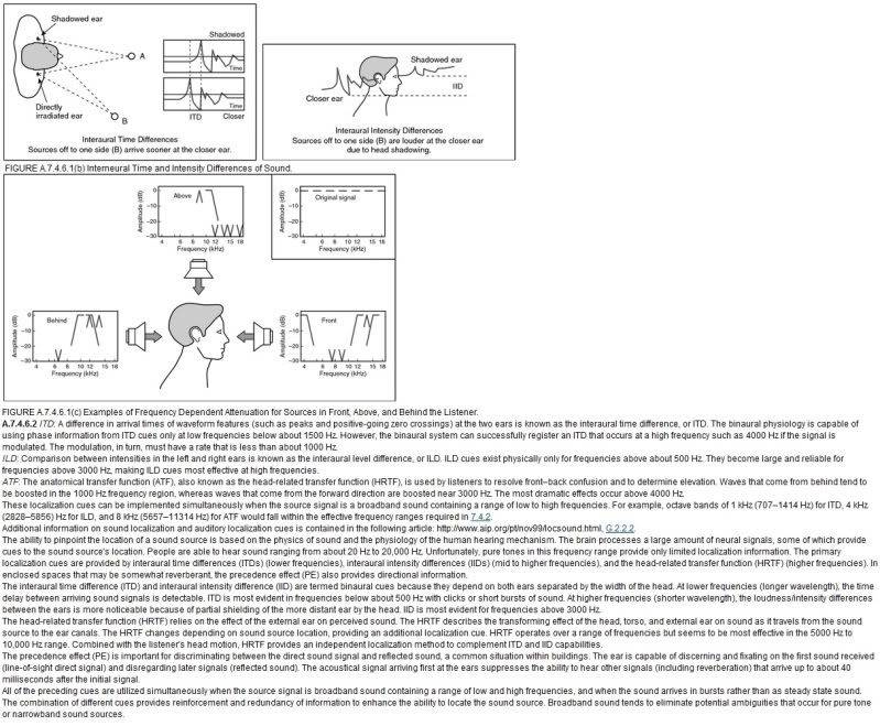

a good sound stage is developed with tuning and tweaking. it's not an out-of-the-box thing. you need to plan for it and have a basic understanding of how we localize sounds.

a great book for people looking to learn more:
http://www.amazon.com/Handbook-Sound-Engineers-Fourth-Ballou/dp/0240809696
it's sitting on my desk at work right now. a wealth of info.
PM me if you would like some PDF's on acoustics... //content.invisioncic.com/y282845/emoticons/smile.gif.1ebc41e1811405b213edfc4622c41e27.gif
