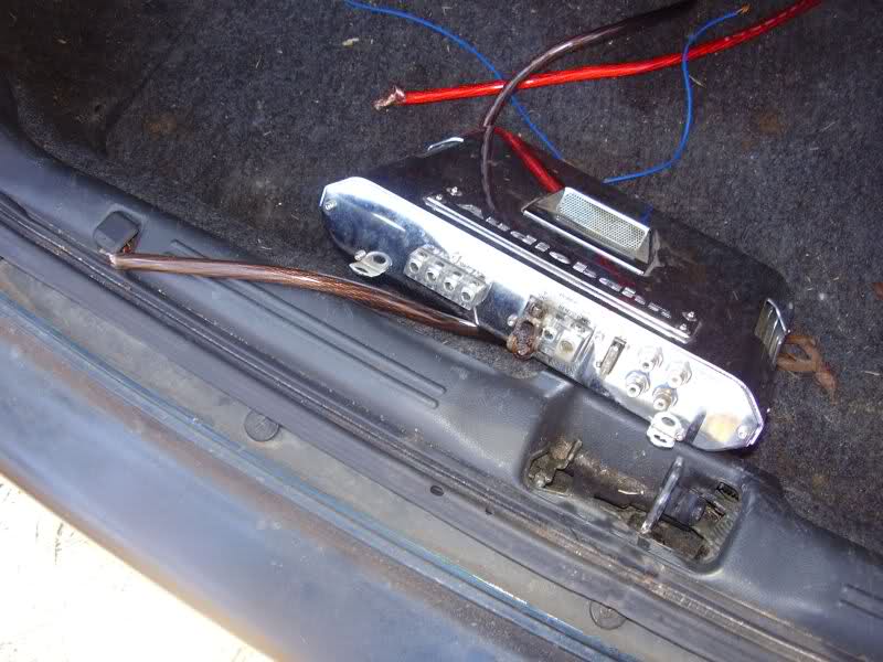

Ok so im posting this mainly to entertain the people, but it also has a purpose as well. These are pics of an install in a guys 90 something honda accord. Full of issues so far and im still working them out. Wish i couldve gotten pics of the batt terminal hookup, was layed up there literally burning. I pulled it off soon as i started work on the car though

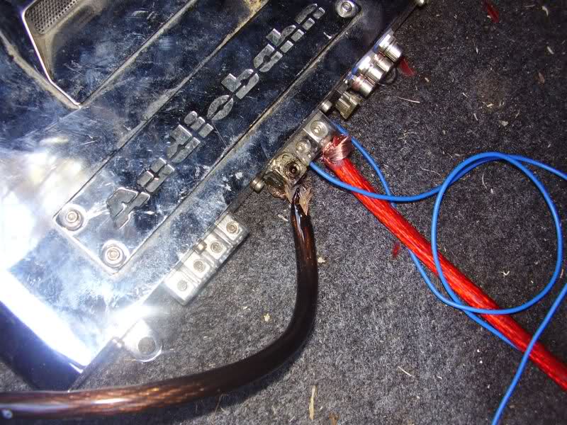

Check out the clean stripped wires going into the amp:
Ground terminal on the amp melted, check out the ground also. "cousin said to make sure i got the trunk closed tight when i wanna play my system" quoted from dude

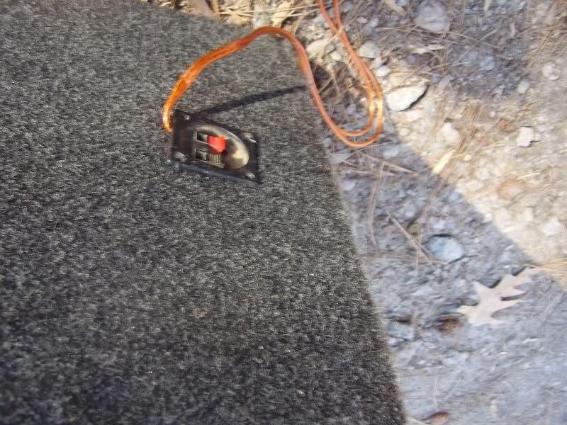

Speaker terminals? Why bother?
Now to my problems: First problem im having is the amp. When it was first installed by homeboy it was working and everything, however i think it was damaged due to the lack of use of ring terminals and/or proper ground/batt connection/and or fuse holder at the batt. I regrounded it to a stripped spot on the trunk floor with using a self tapper and star washer with an actual ring terminal on it. As you can see in the pics theres copper touching all over the place at the amp, and its halfway melted //content.invisioncic.com/y282845/emoticons/crap.gif.7f4dd41e3e9b23fbd170a1ee6f65cecc.gif So now that everythings installed correctly sometimes the amp wants to work and sometimes it doesnt, i noticed itll power on for a split sec then blink off, but if you smack it it comes back on. Obviously from the pics he needs new equipment but he insists on using this. Hes powering a super old school set of lanzar max 12"s with it, that are pretty much gone as well.

if you're going to install half-assed, at least use electrical tape on the power and ground wires. as far as the deck, did you blow a fuse? check your fuses. you can wire it to the ignition for turn on if you have to.
over all i would re-wire the entie setup. did he use an aftermarket wire harness to properly wire the head unit to the car?
check the fuse box of the car to verify is the fuse poped that goes to the radio. that may be the issue why it's not turning on.
as for the amp it may be possible that the reason why the amp will blink on then shut off could be that the wire inside the melted up terminal is making poor contact. thus you knocking on it probably knocked it into place for it to work.
