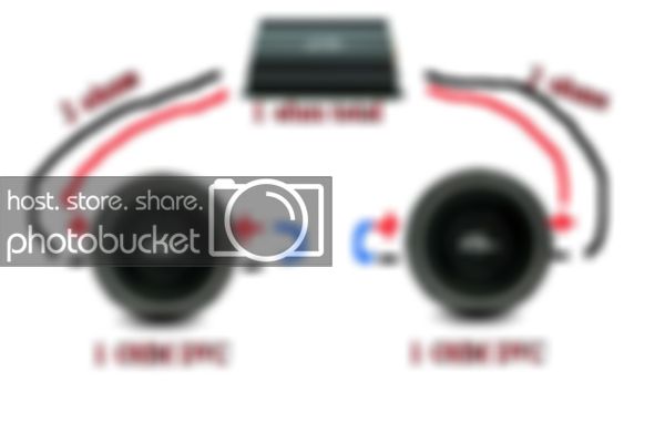

Pretty sure I have this right but I want to make sure. 2 x 1ohm DVC subs with each subs' VCs wired in series for a 2 ohm load per sub, wired in parallel to the amp for a total 1 ohm.
The blue wires are jumping the two terminals together.
This is the wiring diagram I went by:
Looks right to me, but you may want to do exactly like the pic, (hook the positives together on subs then to amp, and negatives together on subs then to amp) for ease of wiring.
No, when you run the pos to neg on one vc, it means the electricity has to flow through one coil to get to the other. It's just raising the resistance (series wiring). Correct me if i'm wrong anoyone.
I did have it wrong. I just went outside and wired the V/Cs up like the diagram and it works fine //content.invisioncic.com/y282845/emoticons/redface.gif.62fdbfe1a101588a808c4cff71bcb942.gif
