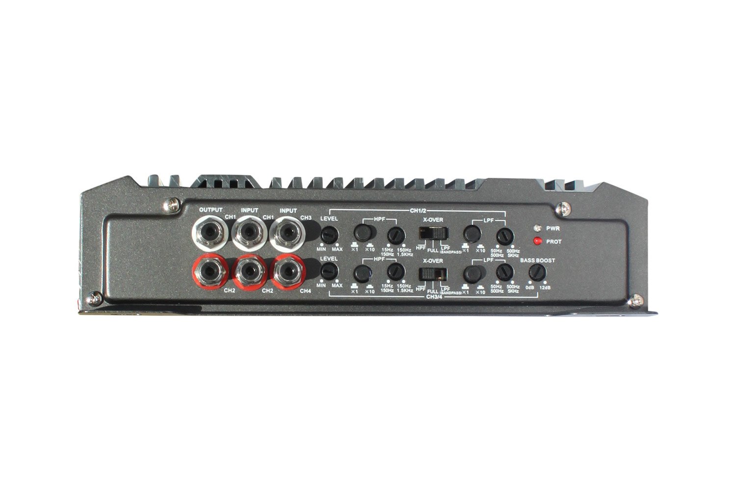

I would simply like to run two sets of Polk db652s. Can I run each speaker to each of the channels at 4 ohms and get the 100 watts I’m looking for? Or will I need to wire it different?
WTF. I have never noticed that before.
This picture is from their website and shows full range for all 4 channels.
@ThxOne You run one right?
This picture is from their website and shows full range for all 4 channels.View attachment 25273
I do however they seem to have upgraded/updated Barbara. I don't have Tiffany style RCA's. I run into mine via a DSP though. I have all four channels set to high pass with the crossovers as low as they will go.
