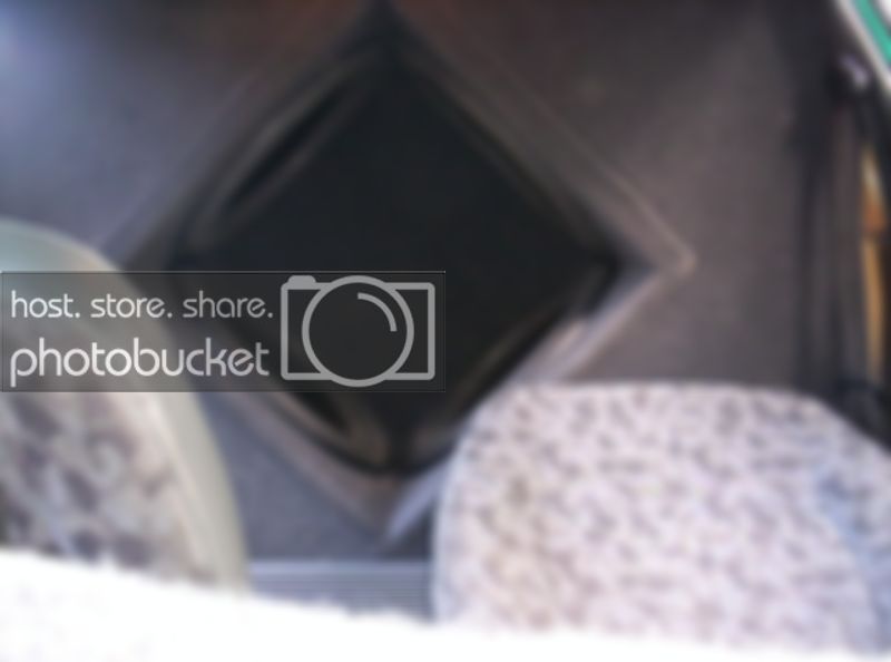

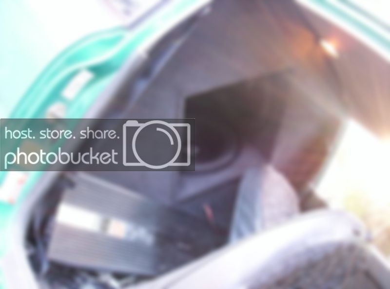

yea but thats when the design of the box comes in handy diamonds and walls where woofers face each other act as an bandpass alittle. kinda like its ported example:
^^^^^^^^ that setup is considered sealed too. but do you think he would pull off an 149.1@30hz with under 4kwrms with those same subs and amp in an FLAT wall sealed?
