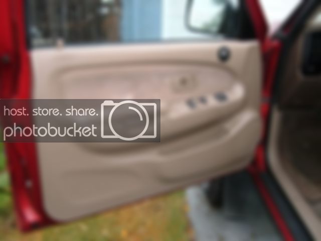

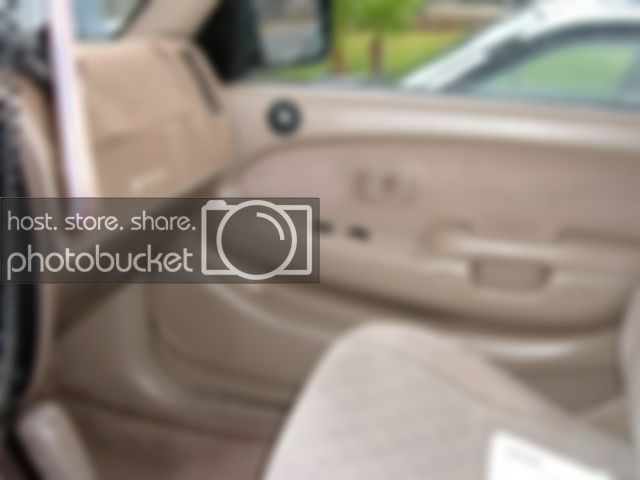

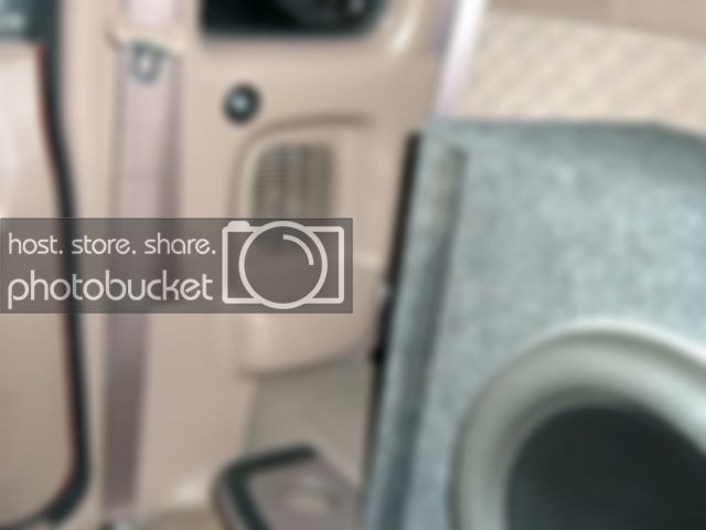

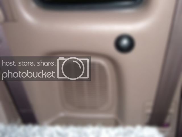

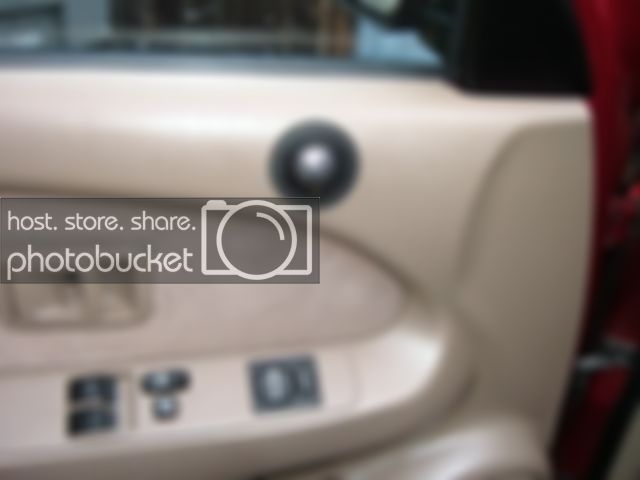

Most, if not all people will tell you about the front staging like when you in a concert. I had the same problem about running rear speakers let alone components in my Tacoma ext cab pickup. Guess what? I went with both front and rear components and I couldn't be more happier. My application might be a bit different since my cab is smaller and closer to me = all 4 speakers in my ear vs a 4 door Rubicon.
