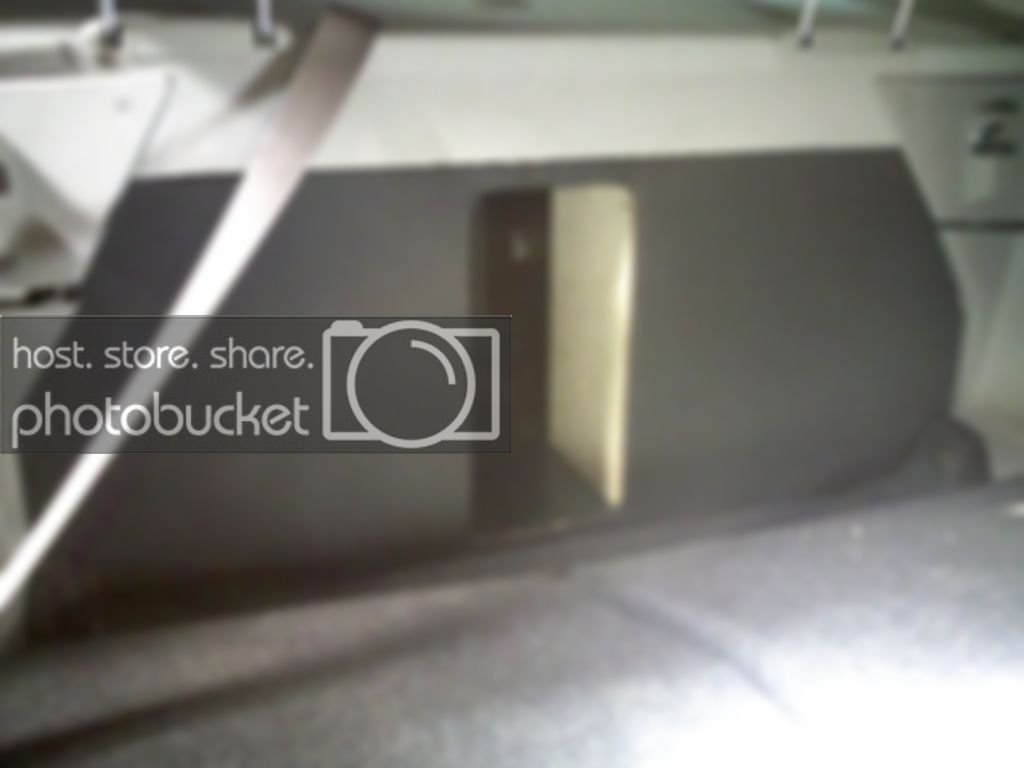

so i did some port mods and stuff and it sounds GREAT but not very impressed by the number its putting up. it managed to only pull a 140.4 at 40hz. i put the meter in the box and it did a 156 at 40hz and a 158.1 at 69hz.
didnt take any pics but we foamed around the box and some minor spots in the back deck.
o well its a good thing this is just a daily driver so at least it sounds good. it does a 139+ from 38hz to 48hz so it sounds good on about everything.

make the port shorter and u should gain alittle on the spl..
other than that looks really good

Not necessarily. The only thing that would probably do is raise his frequency.
The only way his numbers would go up is if he gets closer to the resonant frequency of his vehicle.
If your box tuning matches your resonant frequency of your vehicle, then you should be at the maximum spl for the vehicle.
welp almost done just need to fill some screw holes in and coat the inside of the port with bedliner and it will be complete. i will take some vids of it when we get it complete. threw something in the port today and wow i was impressed by how much air it does move.
