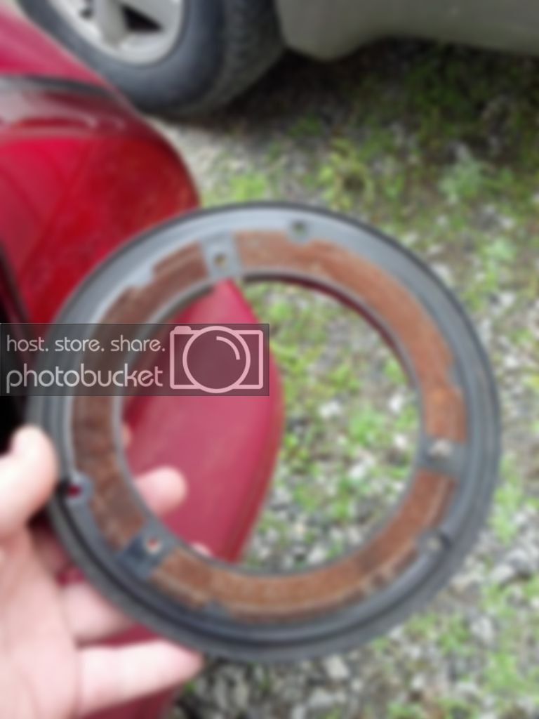

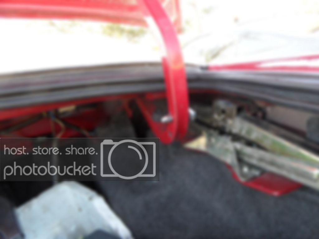

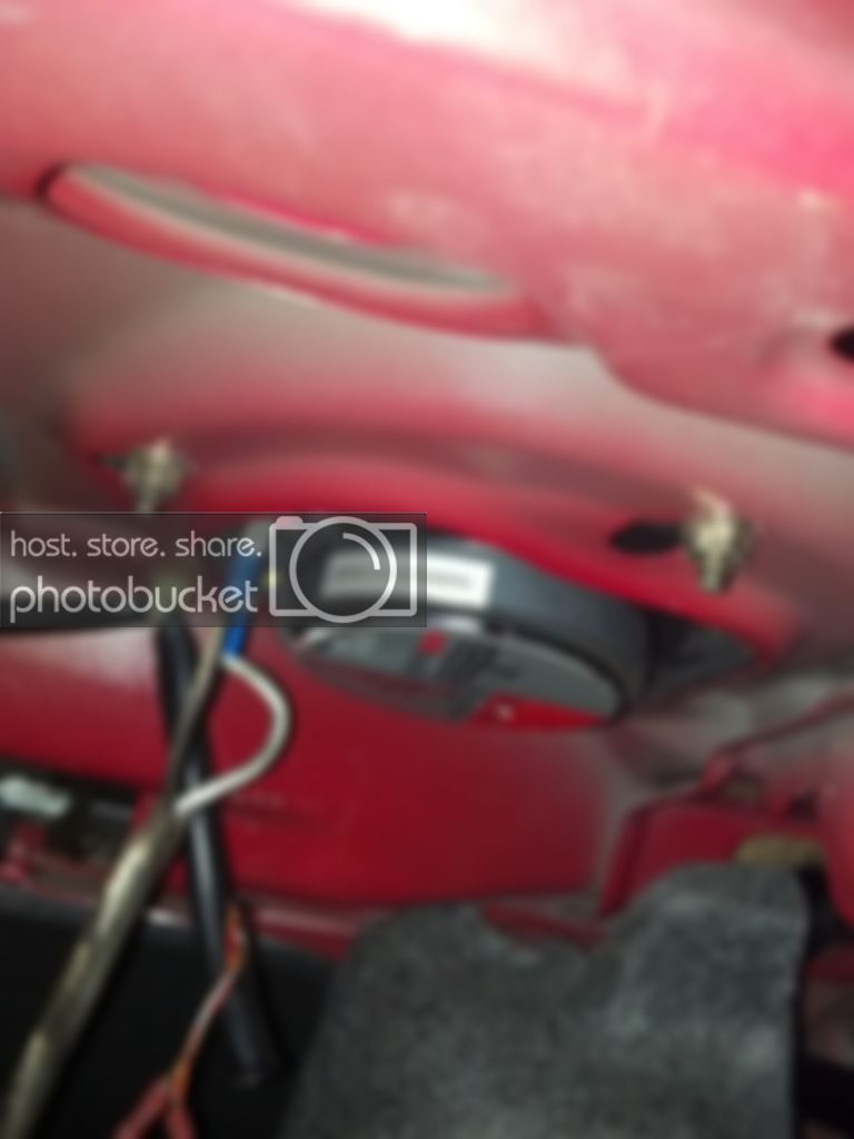

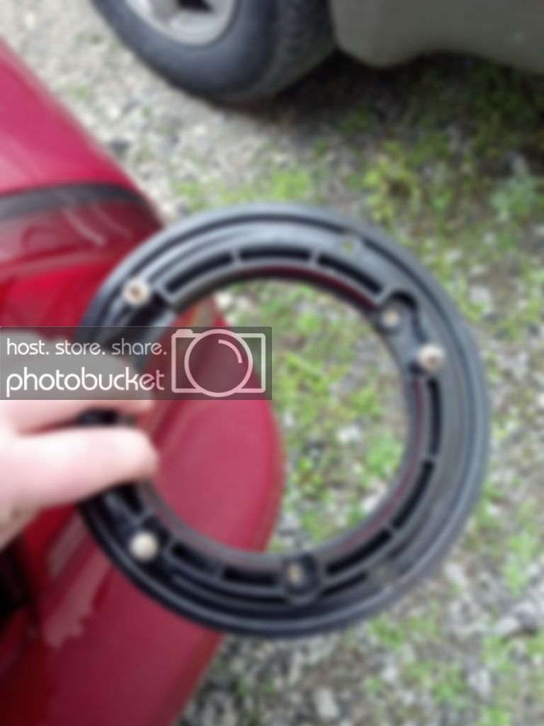

Well until I removed the trunk springs and converted to gas struts, I had 2". Now I have as much depth as I desire. The biggest thing is they can't be 6.75" because of the mounting design Honda used. The current speakers are Polk shallow mounts, and I've smoked both tweeters on them. Damn electronic music, lol. It's in my 94 Honda Prelude.
Those are for the front speakers. The rears use a basket/mount that actually bolts to the deck, due to the angle of the rear windshield. The grille sits less than half an inch from the glass, lol. Anyways, the grille sits stop the basket, and is fastened from underneath. Then the basket it slid into the slots on the deck, and tightened down.
If the outside diameter is too large, the grille won't fit over the speaker.
