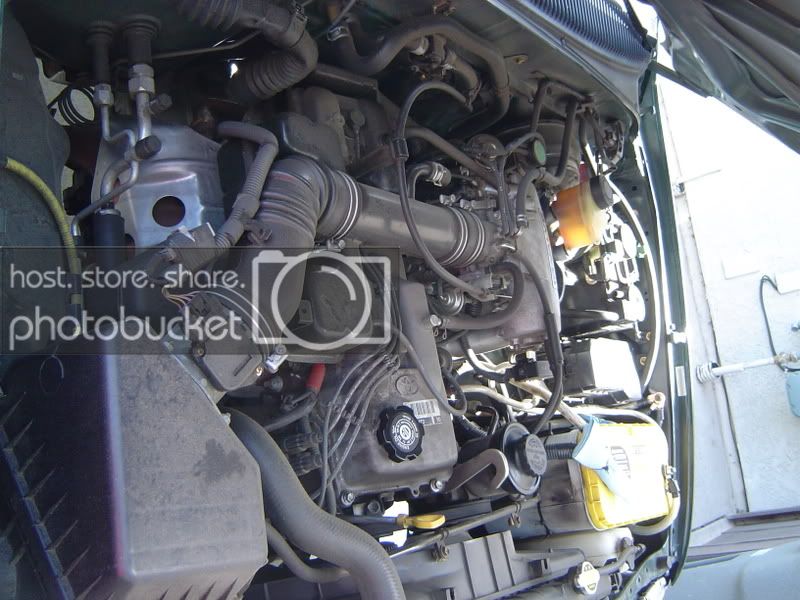

cleaning engine bay....
dleccord
i got an electric power washer and some simple green.
what else do i need to cover besides the alternator and battery?
now should i spray the simple green on first and let it soak in and then spray?
honestly you don't need to cover anything, but if you are feeling cavalier cover alt, ignition coil, maf connections and try not to spray in the air box.
I have found the easiest clean was using "greased lightening" spray on....allow to sit to break down grease and grime, then simple hose off
purple power. spray it on, turn the truck on and rinse everything off really good. dont shoot water directly down on the engine..water sits around my plugs and works its way into the cylinders and it makes for a ***** till the water works out. keep the pressure washer a good distance away from all wiring..from everything actually.
after your done and its dry, go buy a can or 2 of wd40 and spray everything down. gives it a good shine for cheap
My process at the detail shop I work at is soakin it down with an all purpose cleaner, let it sit, and pressure wash off, keep around 15-20" of distance with the washer tho. Try not to directly spray the alt with cleaner especially. I spray a dressing on it while its still wet.
You don't have to cover up anything. Just get a can of engine degreaser at Auto Zone. Some you do it when the motor is hot and some you do it when it's cold, do whatever it says. Spray it on, scub the bad areas, let sit on there for awhile and then take a hose to wash it off.

Where to begin... I'll start by saying, YOU'RE ****ING RETARDED. First off, the water isn't getting into the cylinders, it's saturating the spark plug boots. You need new plugs and wires. If it IS getting into the cylinders, then your dumb *** didn't use di-electric grease or torque your plugs properly. Wrist tight plus and 1/8 - 1/4 turn. And chances are, if you go to pull one off, the contact is going to snap off and stick to the spark plug. And secondly, WD40 is a cleaner, not a lubricant. Cleaners evaporate and remove residue as they do so. WD-40 will also cause cracking and whitening in plastics, not to mention IT'S FLAMMABLE.
