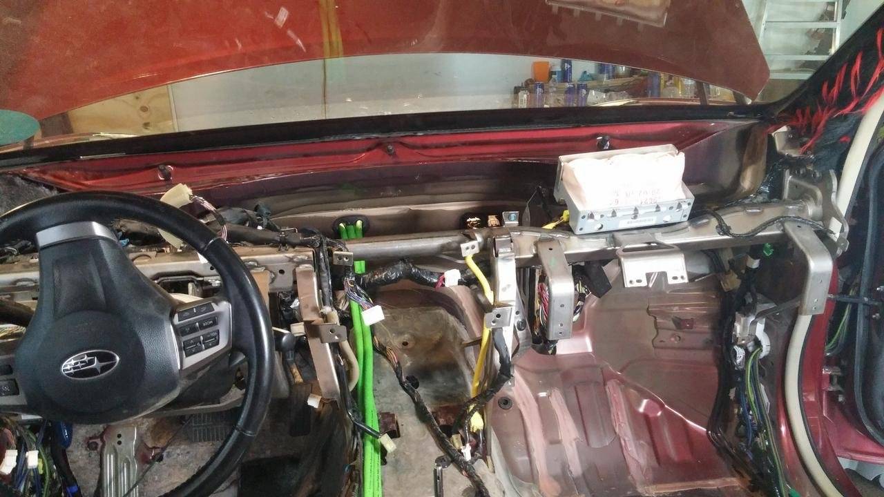

finishing things up on the rebuild, figured id post pics as i go, 145 here i come!!!
removed dash and gutted all ac with sawzall, welding steel plates and poles all over the firewall as its my only weak point

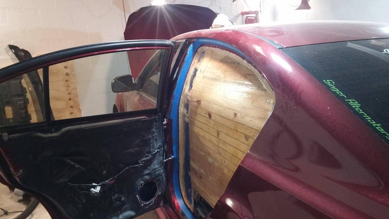

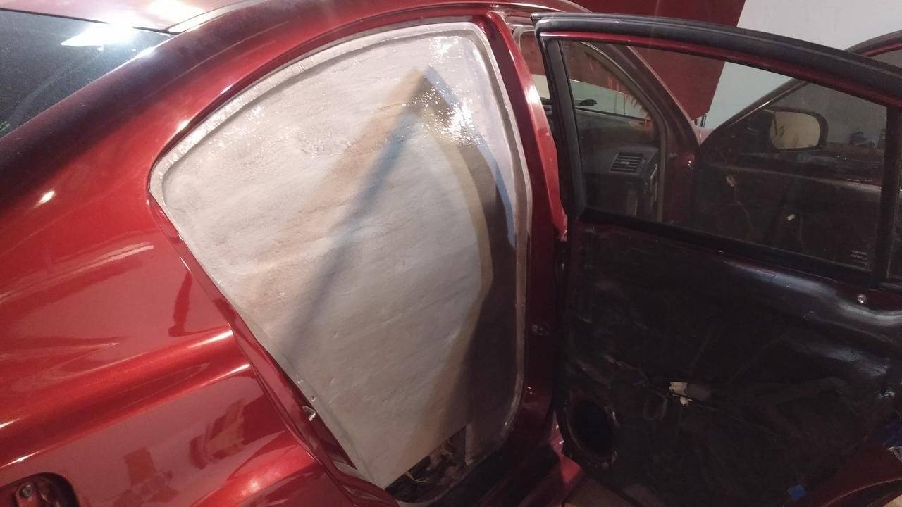

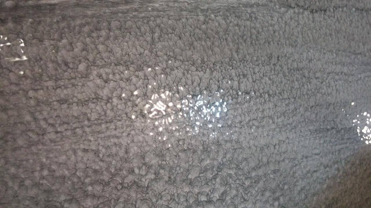

total wall thickness all around is 4.5". sides before and after paint

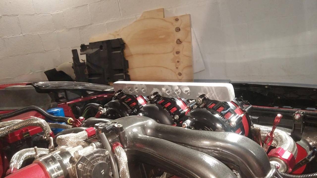

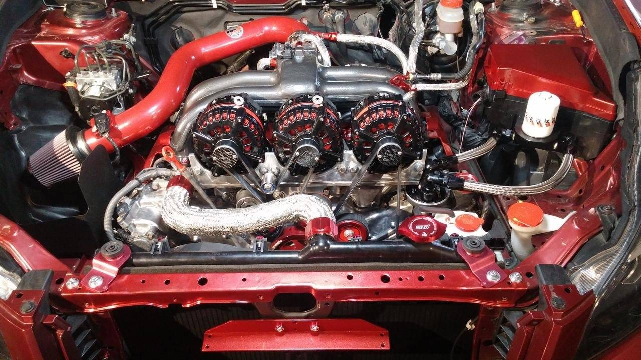

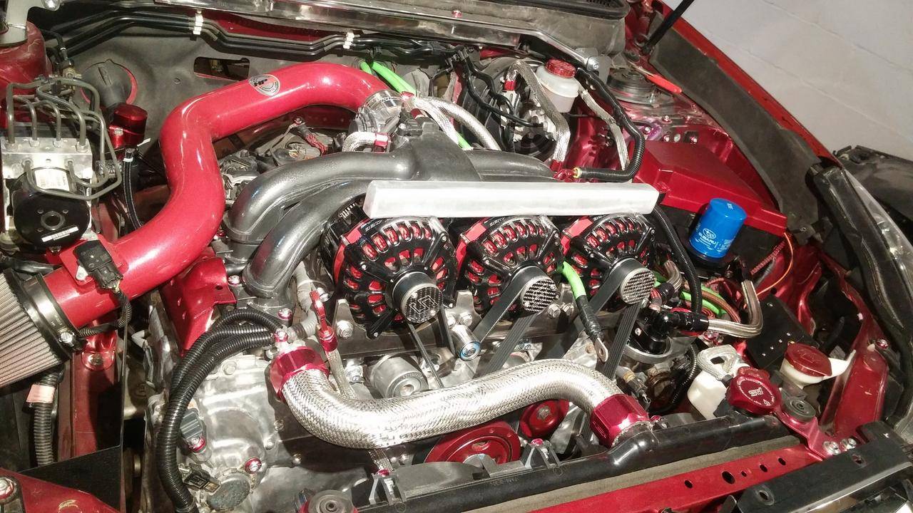

my **** alt setup, yeah its ok to be jelly

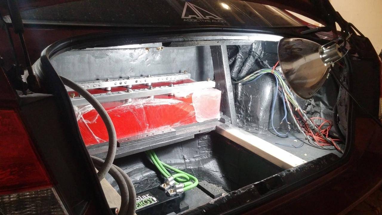

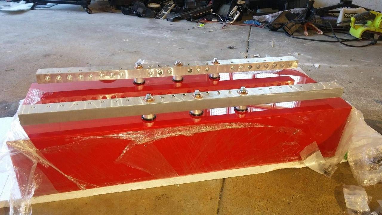

my custom lithium titanate battery with my diy buss bars

Did u do a 2x4 frame for the enclosure? I was think of doing that for my 2011 Tahoe build.
yeah but it was tricky as f*ck, angles took forever and each side is fully against the frame and bonded with 8x, its built to the car like a roll cage using every square inch i could get, had over 35 cubes to play with lol
Gramps I built all this in my garage with a drill press and angle grinder, you can do it to don't be a p*ssy
