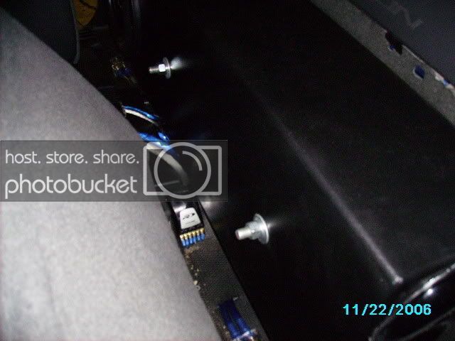

Flip that box over and see what it does in the passenger kick. //content.invisioncic.com/y282845/emoticons/wink.gif.608e3ea05f1a9f98611af0861652f8fb.gif
Beautiful. Just beautiful. So far it's a clean setup, i dig the speakers terminals. I'll be sending you an Instant Message soon about them. //content.invisioncic.com/y282845/emoticons/wink.gif.608e3ea05f1a9f98611af0861652f8fb.gif
Enough with the teasers, and send over the pr0n!
I'd like to see some better pics of the box. I could use some idea's for future plans in my reg cab.....

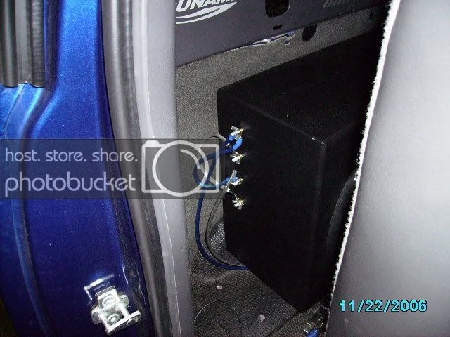

Box is 2.7 gross IIRC, its 2.2 after sub and port disp.
2 4" areos out the side off set to fit. Sanded and rounded. Threaded rod for bracing.

box diminsions are 9 deep-15 tall-48 wide
and like justin said dual 4 inch aeros out the side and 5/8 threaded rod for bracing. plus a little love from the roundover bit and the palm sander.
