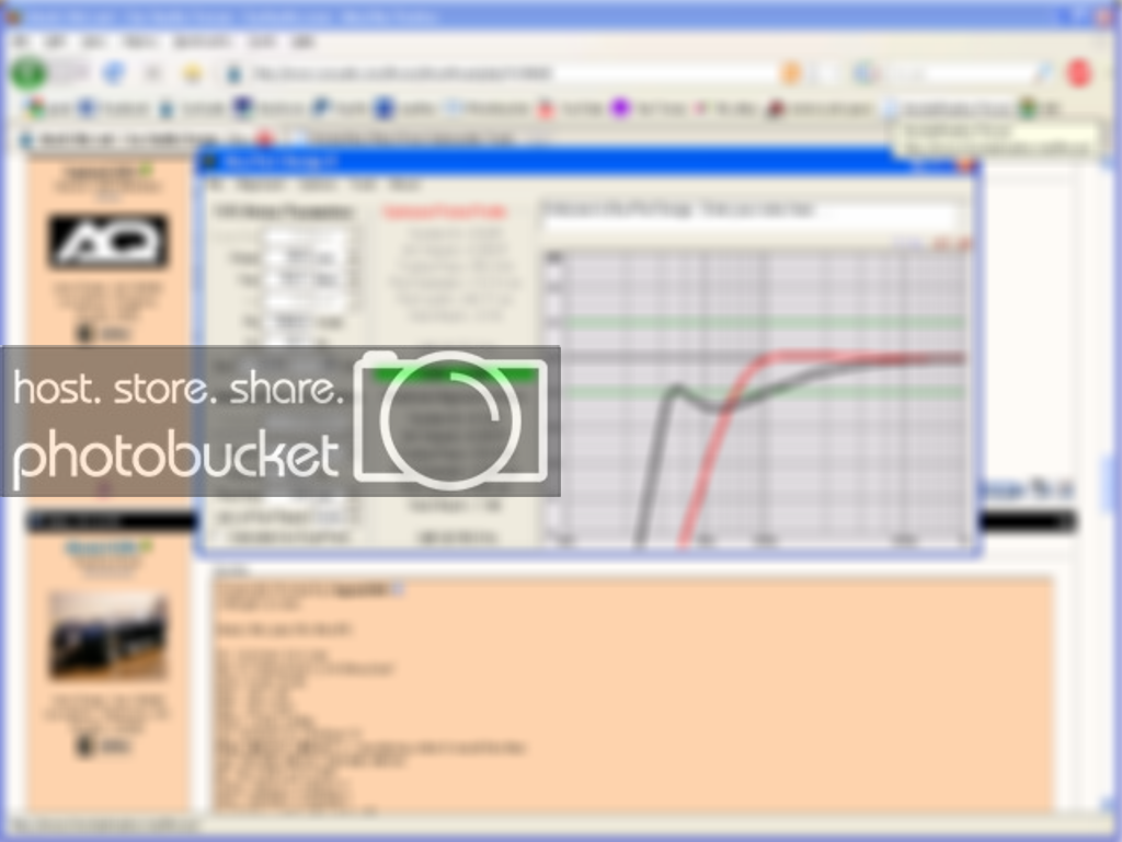

check this out
I think your vas is wrong:fyi:
i though so man
heres the spec for the BTL

you plugged in Liters in a field for cubic feet feglet
