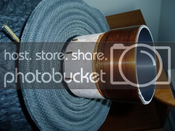

I had my 18 installed maybe 3-4 weeks, only beat on it a couple times. When I pulled it out the spiders were already showing wear around the tinsels.I NEVER played under tuning period, never taken beyond its limits.Actually I think it got pushed to its limits maybe 4-5 times? I've never seen such a self destructive sub right out of the box like that. I've never had a problem with a sub like that before. Meh, oh well.

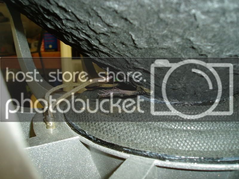

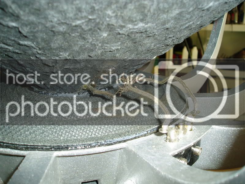

Mines did the same thing as the pics you posted...I'm pretty sure it's user error(clipping).
Indeed, that subs coils were sooo overheated that the tinsels heated up so much and burned through the spider! The worse thing was the user didn't mention of a fowl smell which HAD to be present, come on lOl. I once burned a 1/4" of a woven spider and thought my car was on fire. The heat weakens the metal in the tinsels causing them to break, if it was a woven spider it would have cut straight through running big amps you need to keep it clean and keep it short... Polo.//content.invisioncic.com/y282845/emoticons/wink.gif.608e3ea05f1a9f98611af0861652f8fb.gif
Does noone listen, the coils are absolutely fine, they are not burnt, they still have the shiny copper color to them, the imp of the coil is still normal and i never smelled coil whatsoever while playing
IDK what the issue was with the tinsels, but i will tell you right now that the coil is fine, the tinsels are not
If anything the issue with that side is probobly due to the fact that after the Tinsel Lead broke on the other side ( as you can see the broken sides spider looks fine ) you are now trying to send 2000+ watts RMS to a single coil of a BTL, not a combined effort, which would cause the heatup because a single coil is not meant to take that much power its suppost to be a team effort
just accept it.. the coil was overheated but not damaged while retaining it's shine. the heat coming from the coil continued up your tinsels and caused the spiders to burn up like that.
yes your coils are fine.. good to go for round 2.. the tinsel lead however was not replaced/re-affixed to the terminal. why? because just about everyone that has had a tinsel snap has had a small amount of lead become missing. why do i say this? cause i had a tinsel snap on my 05 XXX, and i am the original owner of that XXX. my sub too had a small amount of lead missing which made it seem like if i soldered it back right at the point of the snap it would not be able to take absolutely no excursion. though for the months of owning it before it snapped it's taken it's beating. http://forum.carstereos.org/lol-tinsel-snap-t67885.html
no one is at fault. the tinsels had a weak point and snapped. just ask Scott for some tinsel lead and run a new line. if he will warranty it then let him warranty it.
