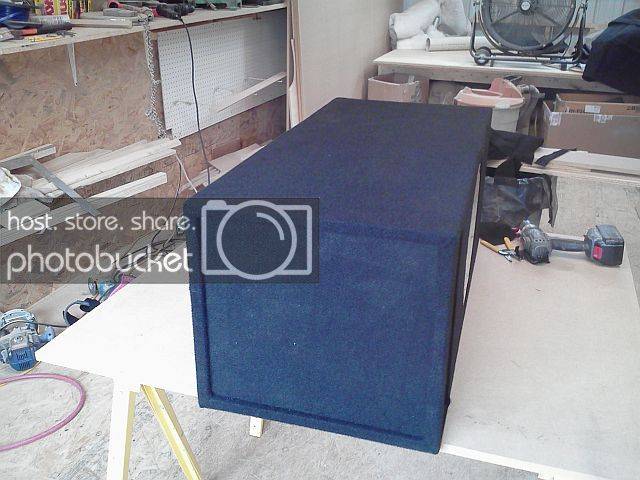

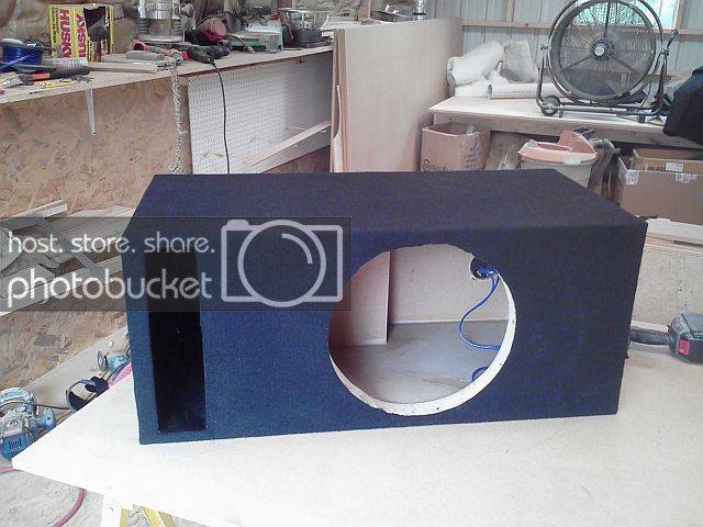

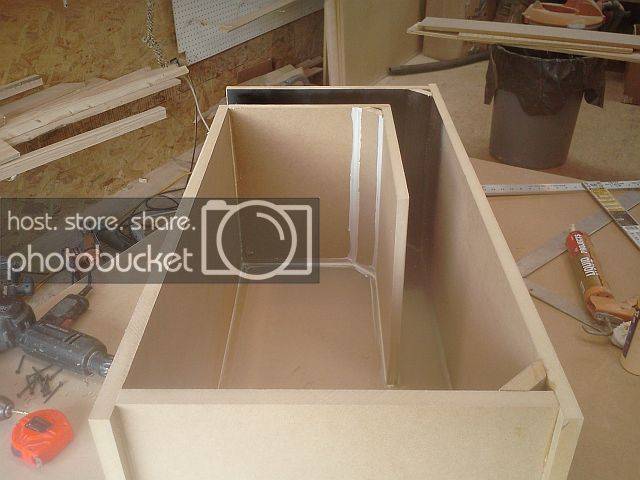

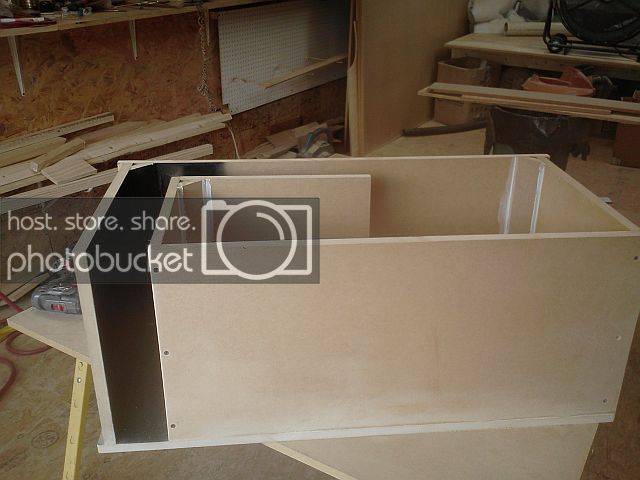

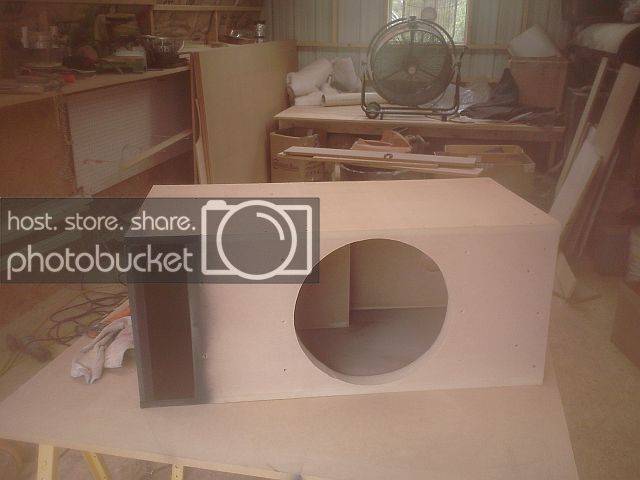

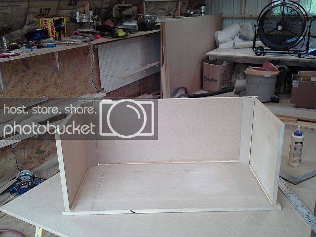

This is for a single Skar VVX 15" sub........3 cubes net....33hz tune......Double baffled
The box has a DOUBLE baffle trust me.....I just didn't take a pic of the enclosure with the top off after the inner baffle went in.....The last pic shows the baffle thickness...thanks
