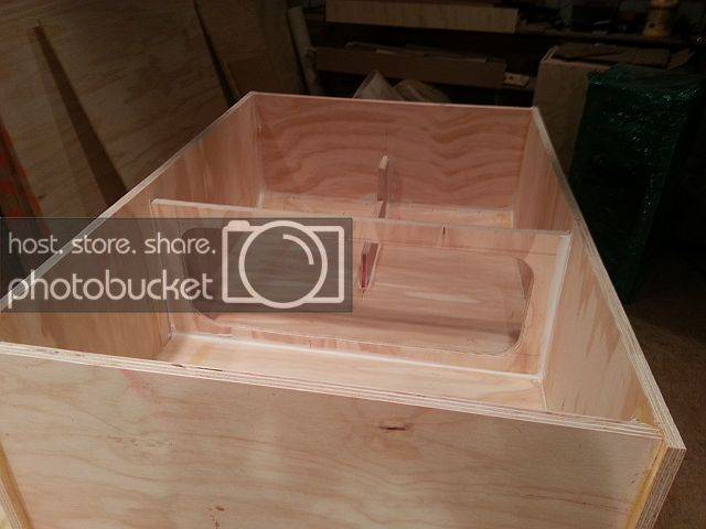

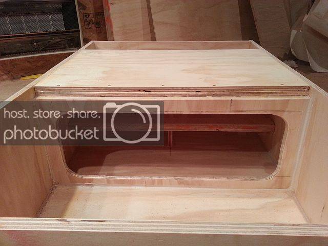

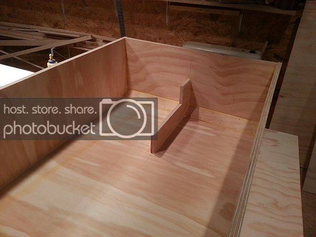

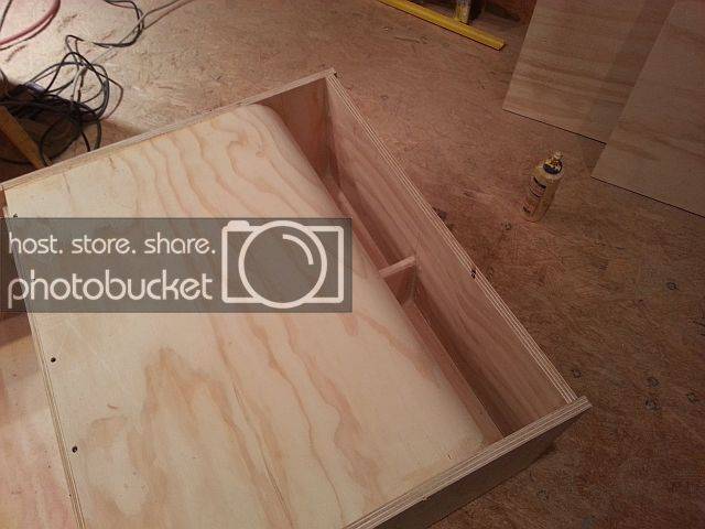

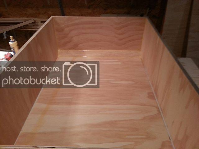

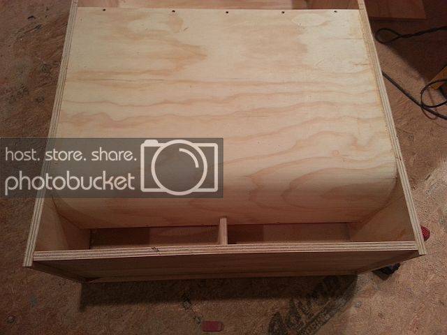

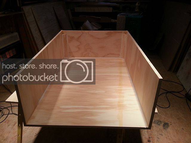

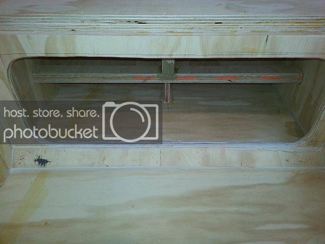

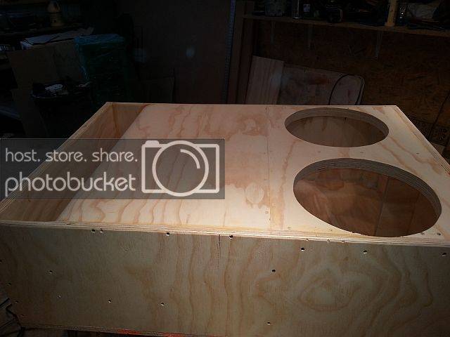

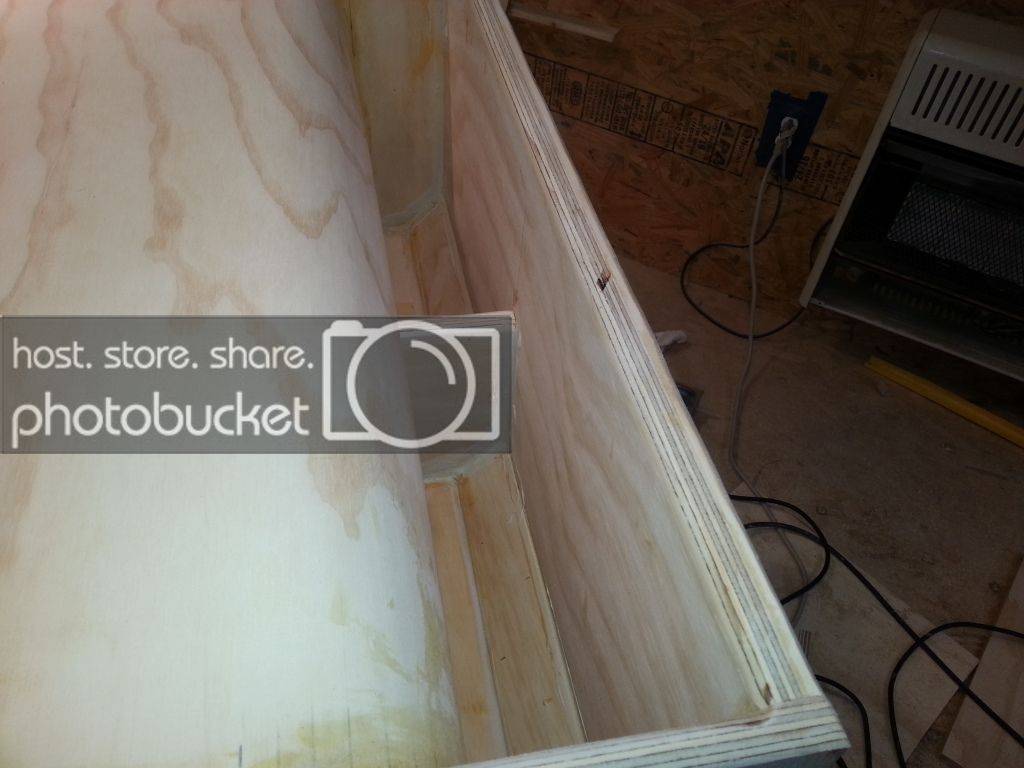

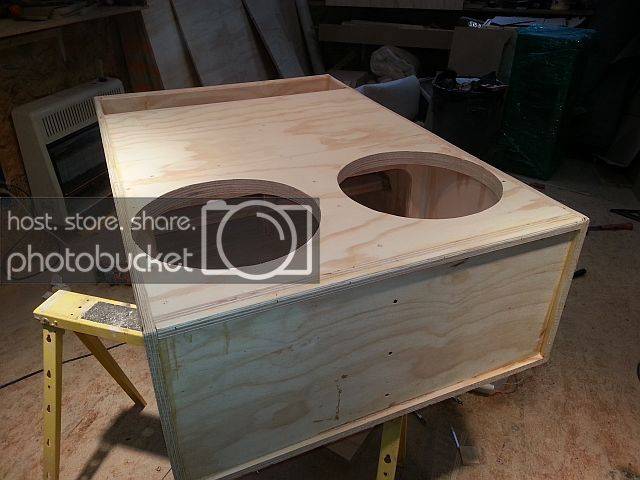

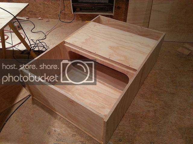

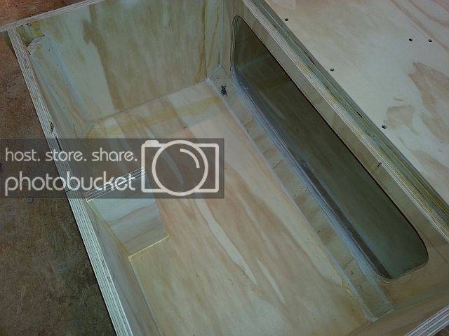

This is going to house two DC Level 5 15s.....sub and port up...7.6 cubes net...33 hz...Arauco construction.....The bracing is double width where the upper baffles are going to meet...
o-O ****, you always make such nice looking enclosures.... loving the Kerf on this one BTW
