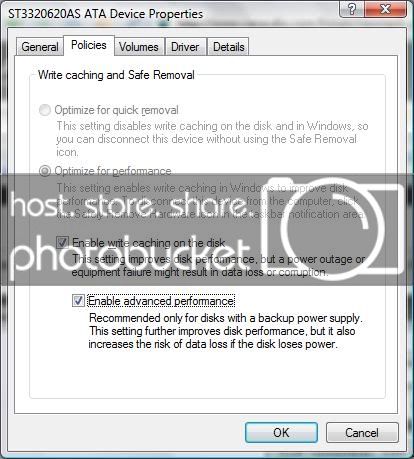

Just remember, with the laptops, the first thing you want to do is set the hard drive to advanced performance mode.
Start > Right-Click Computer > Manage > Disk Management > Right-Click Disk 0 > Properties > Policies > ...
It really helps out w/ laptops because of their relatively slow hard drive performance compared to desktop hard drives and, since the laptop has a battery, you don't have to worry about data loss or corruption due to power loss.

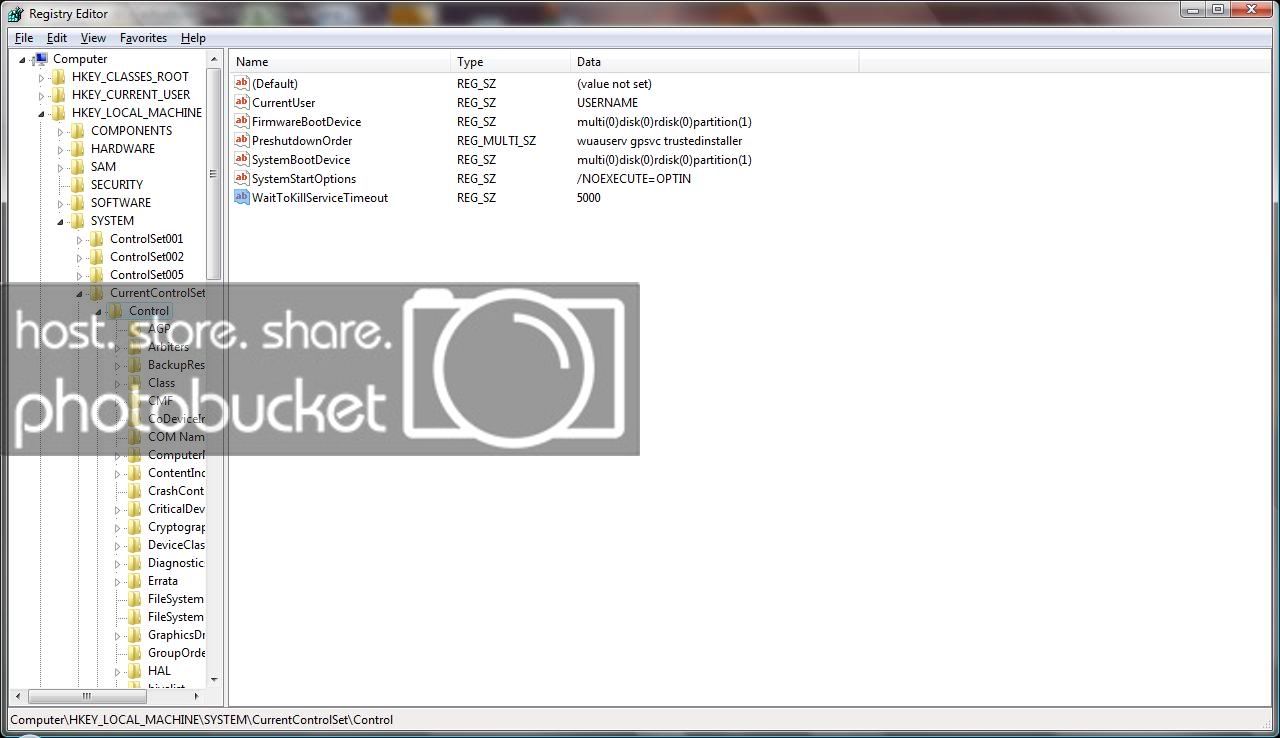

I also recommend reducing the service kill time on shut downs.
Start > Regedit > ...
Drop it down from 20000 (20 seconds) to 5000-10000 (5-10 seconds). It'll reduce your shut down time significantly if you have a lot of programs running in the background.

the advance hard drive thing. When I turn the computer off, do I lose the memory? It says If the power goes out then I'll lose stuff. But will it still happen if i tell it to turn off?

only if the pc crashes, turning it off normally will give it time to backup any data it is writing at the time
i am gonna guess and say the "advanced perfomance" mode just uses a smaller buffer/cache thus a hard crash could possibly lose info
