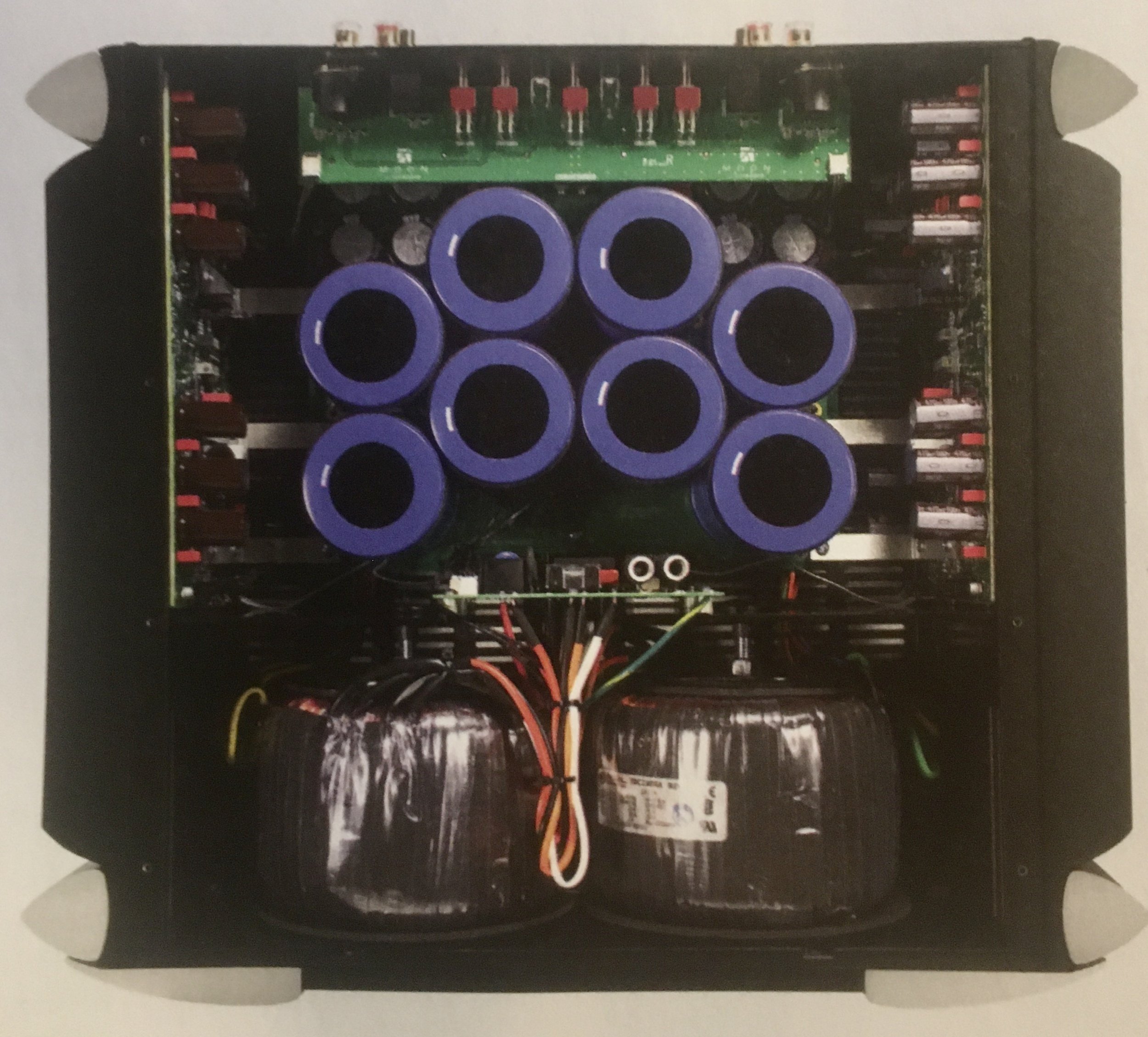

Been a while, but I figured it would pop up in my regular reading material sooner rather than later.
Simaudio Moon 860 home amp. $20,000. 225WPC.
1/4 Farad Capacitance.
I'd very much distrust anybody selling amps for 45$ a watt.
That’s barely rarified air in home audio. Those guys use interconnects that cost more than my system, lol. I’ve heard some of the lower end of that stuff and even THAT is amazing.
Good on them if they can play on that field.
