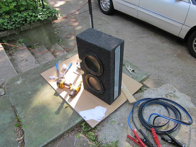

Sub box .7 cu ft:

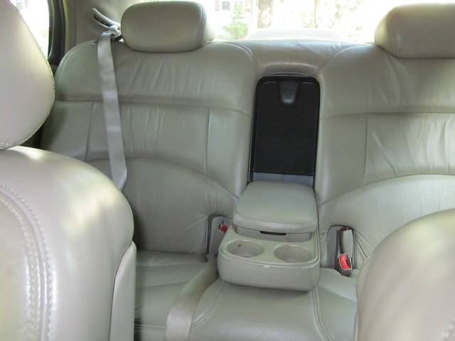

There's a carbon filter in my rear seats, to the trunk. It's basically a hole (no restriction):

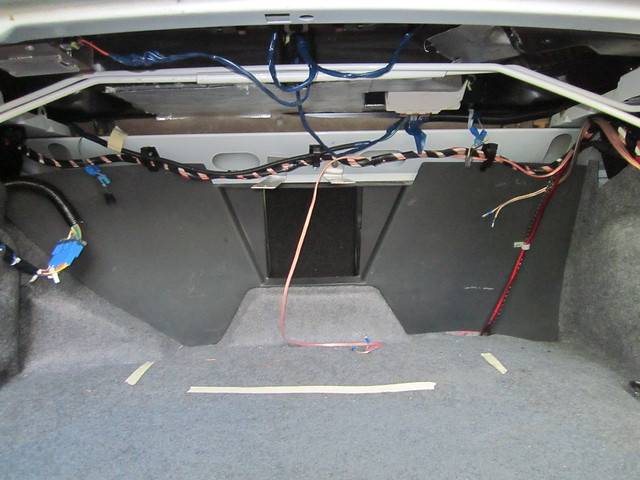

From the trunk side:

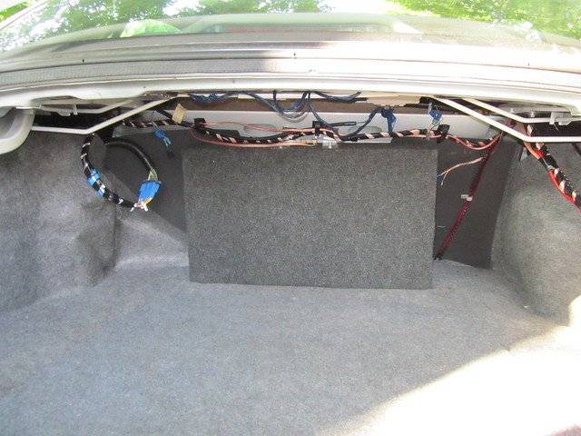

Box in position:
