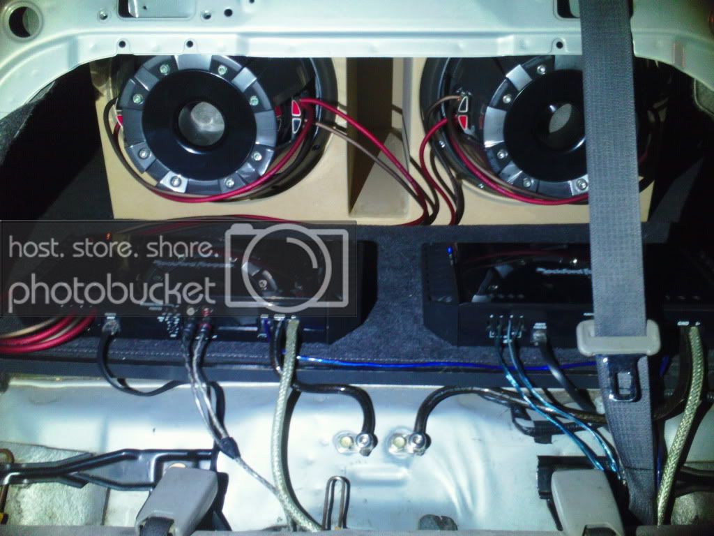

OP you say you have the mids sealed to the doors, but what is the install like? You using the factory mounting? Got any pics of the inside of your doors?
Reason I ask is that some factory speaker mountings are sealed boxes (my Buick was like that), tuned to the OEM speakers and any aftermarket speaker can sound terrible. Just throwing out possibilities...
