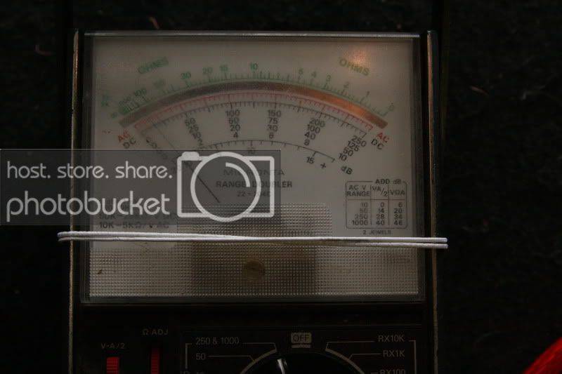

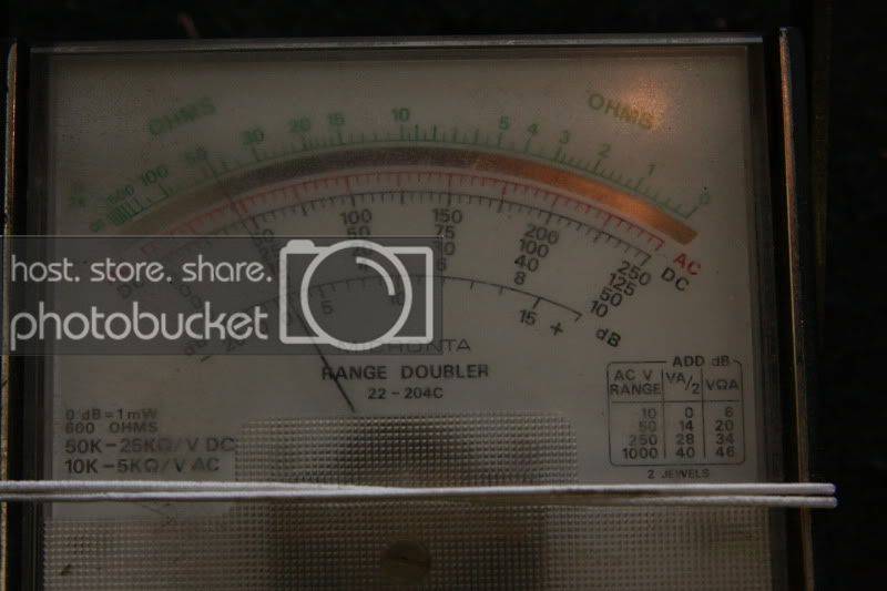

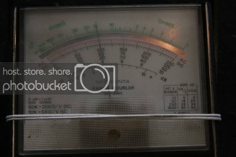

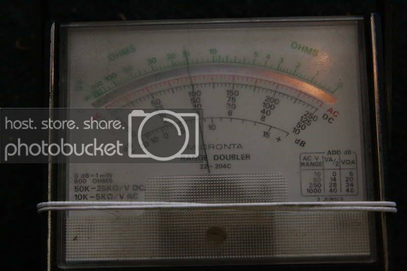

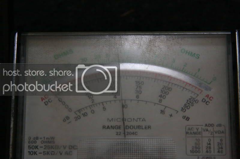

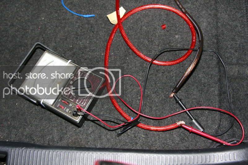

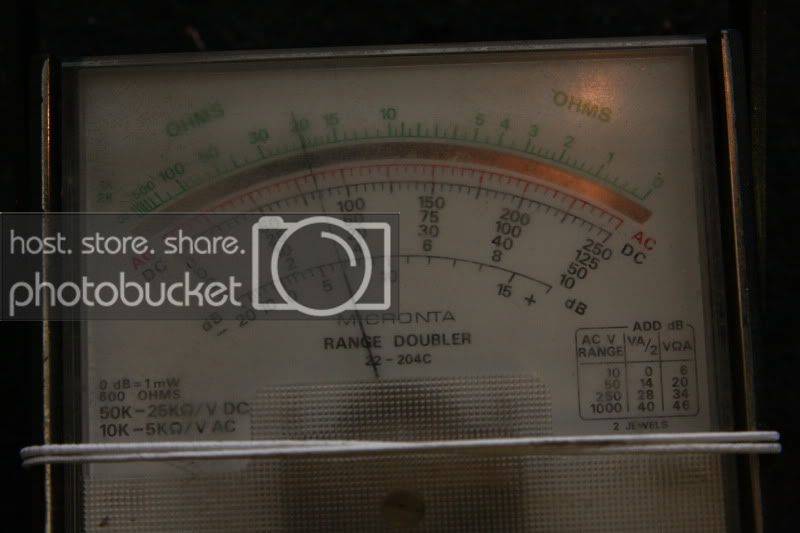

Anyways back to topic I took some pictures today
DCV 250 & 1000
DCV 50
DCV 10
DCV 2.5
DCV .25

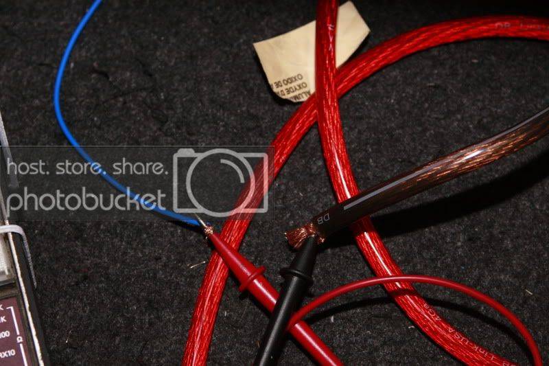

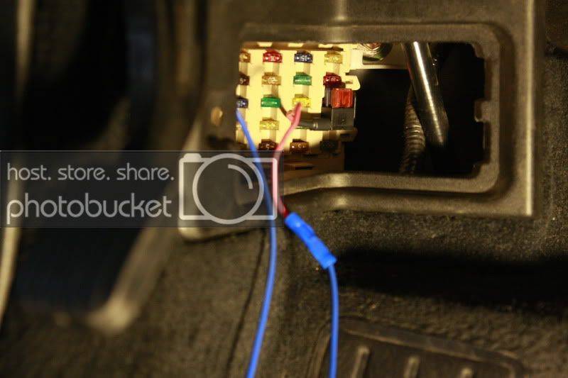

Look like you have juice.Whats going on with the flattened out remote wire in the background? I dont see the wire stripped for the exposed wire needed for the connection.Did you take and try the jumper wire yet?
Remote wire
DCV 250&1000 OR 50 I dont remember.
It seems like my remote wire is getting power no problem. My friend hasn't returned the amp yet so I cant do any of those test you guys recommended me just yet. I'll keep you guys updated.

Just take that amp to the car battery before you put it back in, and run the jumper from the remote to the power, and touch the poss on the battery, and ground to ground to the battery, and if it lights up, the amp should be ok for powering up and ready for SOUND TESTING, IF NOT , THEN THERE IS AN INTERNAL ISSUE WITH THAT AMP.EASY TO TEST.ALL I CAN RECOMMEND TO YOU AT THIS POINT.GOOD LUCK TO YOU, AND HOPE THAT ITS JUST THAT NON EXPOSED REMOTE WIRE.
i DONT RECOMMEND RUNNING THAT 14 GA WIRE TO A 30AMP FUSE OUTLET,ID RUN IT TO THE RADIO OR SIG, SO THAT THAT WIRE DOESNT GET TOO HOT AND BURN UP/CATCH FIRE.TOO MANY AMPS FOR THAT SMALL WIRE,IMO, YET LOOKS ;LIKE YOU HAVE PLENTY OF POWER
